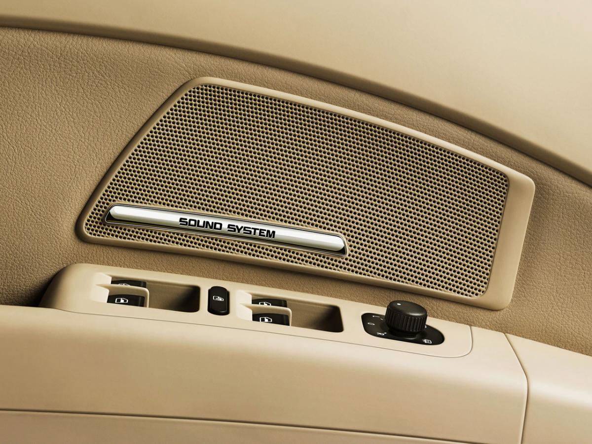

Do you have these extra speakers in the front doors??? If so then you have the Skoda Enhanced Sound System that people mention above.
Yes, I do have those speakers in the front doors !
