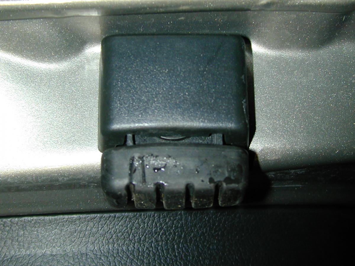

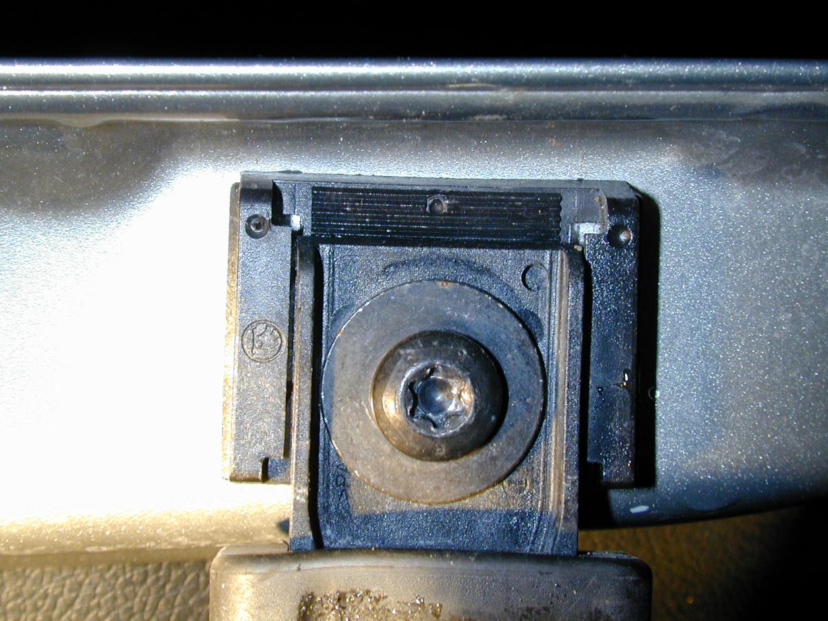

A while back I described how to adjust the tailgate stops to allow it to close freely. In short remove the protective cap(s), undo the screw, move out one notch, tighten screw, replace cap(s)
Edited by DonjSZ5
Above post, that should read move one notch.
