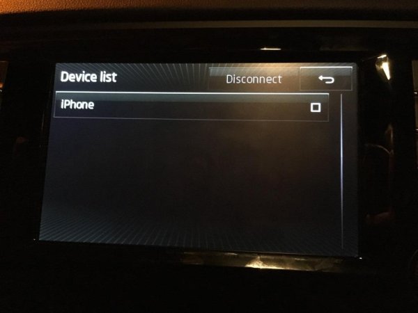

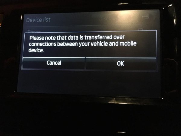

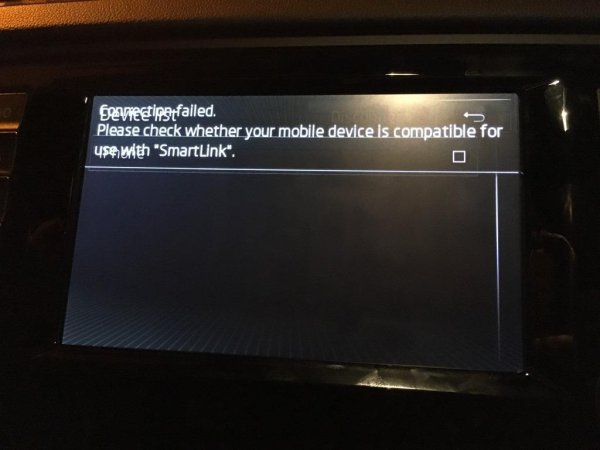

When the phone is connected and you enter the SmartLink function, it asks me to select a device. The list then shows 'iphone', so is able to recognise the phone, but when I select it, I get the following error message: "Connection failed. Please check whether your mobile device is compatible for use with 'SmartLink'."

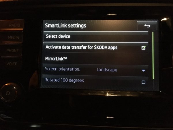

That's a cheap 6" Amazon Lightning cable plugging in.
Switch to Skoda and look at Smartlink settings and voila
Go back on the menu and
Phones a 6S Plus on 9.3 beta 6
Edited by fluffmeister
Interesting - when I plug my phone in, it simply pops up and says the unsuccessful message. Also, when I look into the options for Smartlink, I can see the following, but can't press Mirrorlink - it's simply just text.
