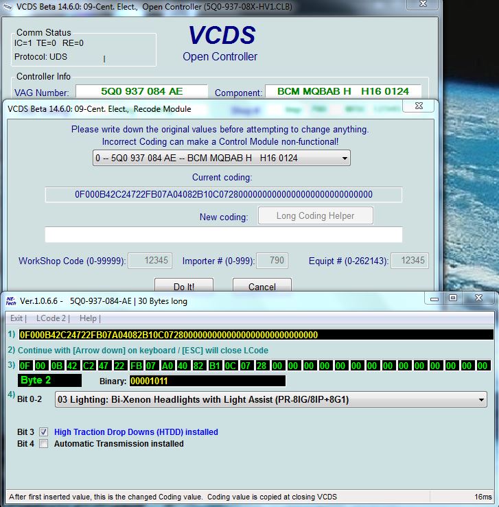

I was enabling a fellow member's HBA on his MY16 Octy vRS. There was one thing that was slightly different from the instructions and it has thrown up a fault.
When recoding the module is says:
Change Byte 2 Bit 0-2 to a value of 03 using the dropdown menu for models with Xenons.
On this members car value 03 said something like this:
03 Lighting: Bi-Xenon Headlights with High Assist & Adaptive Cornering.
I think 02 was something like : 02 Lighting: Bi-Xenon Headlights with Light Assist
I should have grabbed a screen grab.
So should I have selected value 02 instead of 03?
Thanks.
Picture from instructions, not from car I worked on:
26
Without a screenshot form the car you were working on a bit difficult to tell, but the Xenons do have adaptive cornering so 03 still sounds like the correct value.

Apologies, I have looked again today and my MY16 vRS shows exactly as per the instructions - I don't have the other option you mention, even though I have adaptive lights too :wonder:
