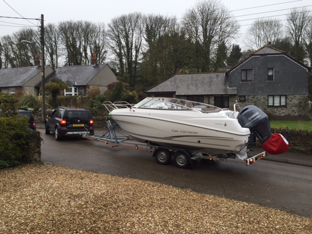

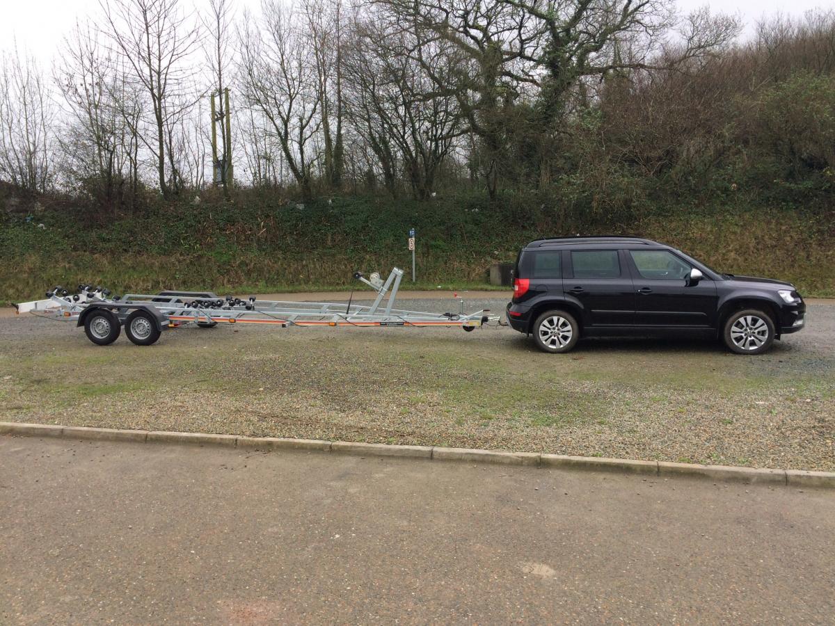

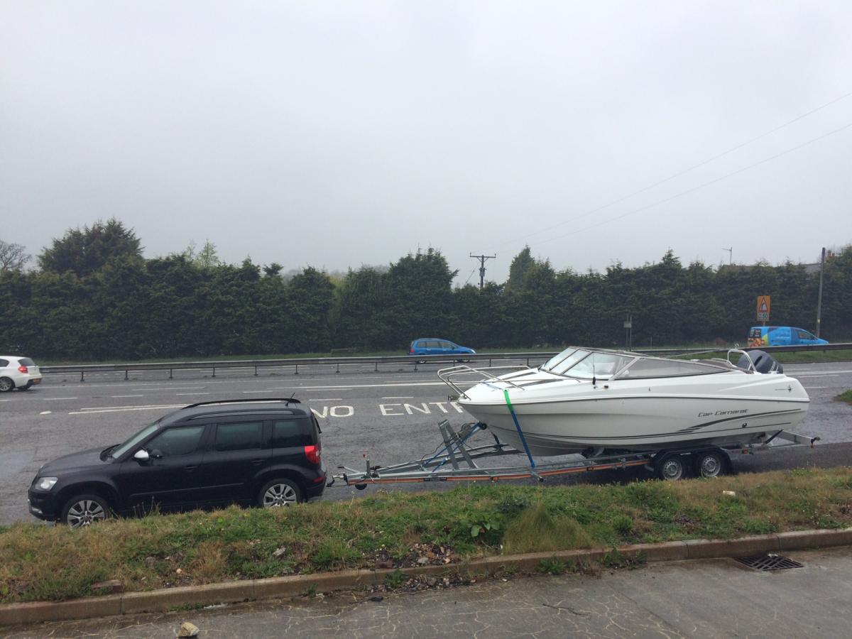

That is an impressive trailer, even more so when loaded I'd imagine!
Mine is lightweight in comparison, this is the old car but I only have a small Erde camping trailer and a four bike rack...
