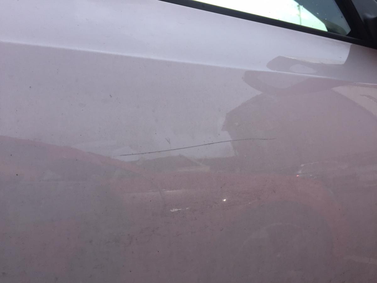

Also this is thread is useless without pics ??? What is the scale of the damage.
OK, pic of damage attached. (Excuse the dirtiness)
I should maybe point out that I do have a dual action polisher with a good selection of pads and products and I have been known to attack paintwork with 2000 grit paper so this bit does not scare me, but as already mentioned I'm trying to find a paint with a good match.
