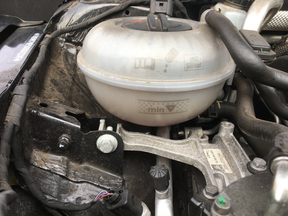

Have you checked the coolant level?
Coolant level is fine. Oil is fine. Just very surprised such a new car would have an overheating problem, the last car I had that overheated was over 18yrs ago and that was a 1983 Mk1 Astra which need a new radiator.

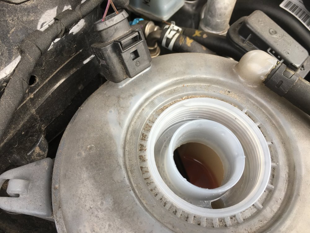

Can (with engine cold of course) you remove the cap from the expansion tank then start engine to check for coolant circulation within the expansion tank? If coolant is flowing back in then your pump is fine so should then narrow down to thermostat.

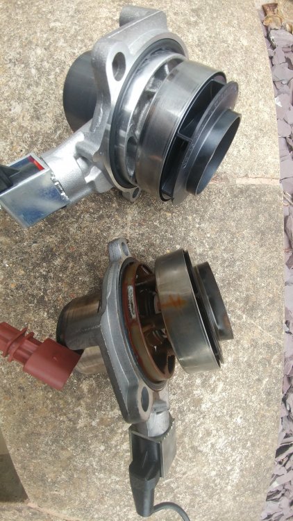

The water pump used on this engine has an electronically operated sleeve used to regulate pump output or prevent it form circulating in some case. This gives the ECU better control of the temps and allows for a much faster warm up time from cold.
Sadly the pumps are prone to failure in the form of a swelled rubber seal that jams the sleeve and prevents it from operating correctly.
The pump can only circulate the coolant at half pressure and during prolonged journeys, usually on the motorway the engine will sporadically overheat.
Your dealer should be aware of this and be able to rectify this fault within a day (parts stock pending).

So car taken in yesterday and water pump replaced. Dealers confirmed sticking rubber seal. All done and dusted in a day.

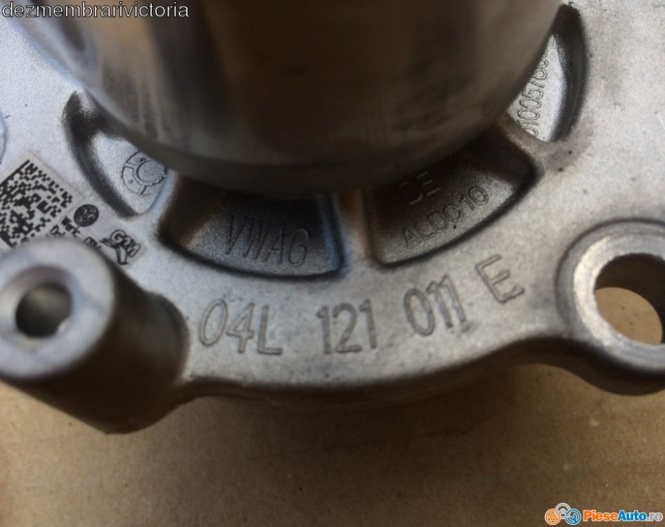

My car appears to have suffered this problem today. Do you know if the rectification is with a 'like for like' pump or has there been any modification carried out?
