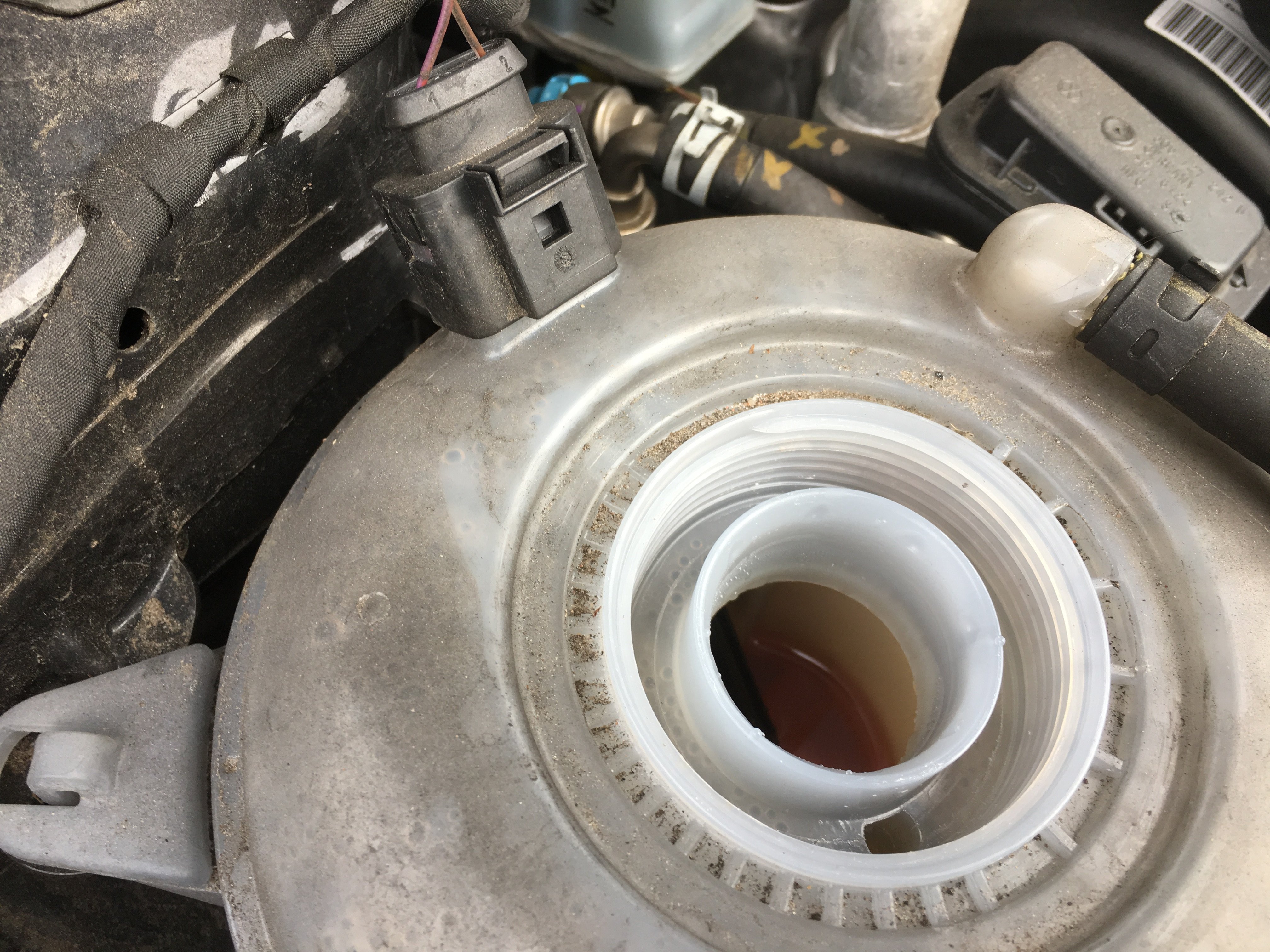

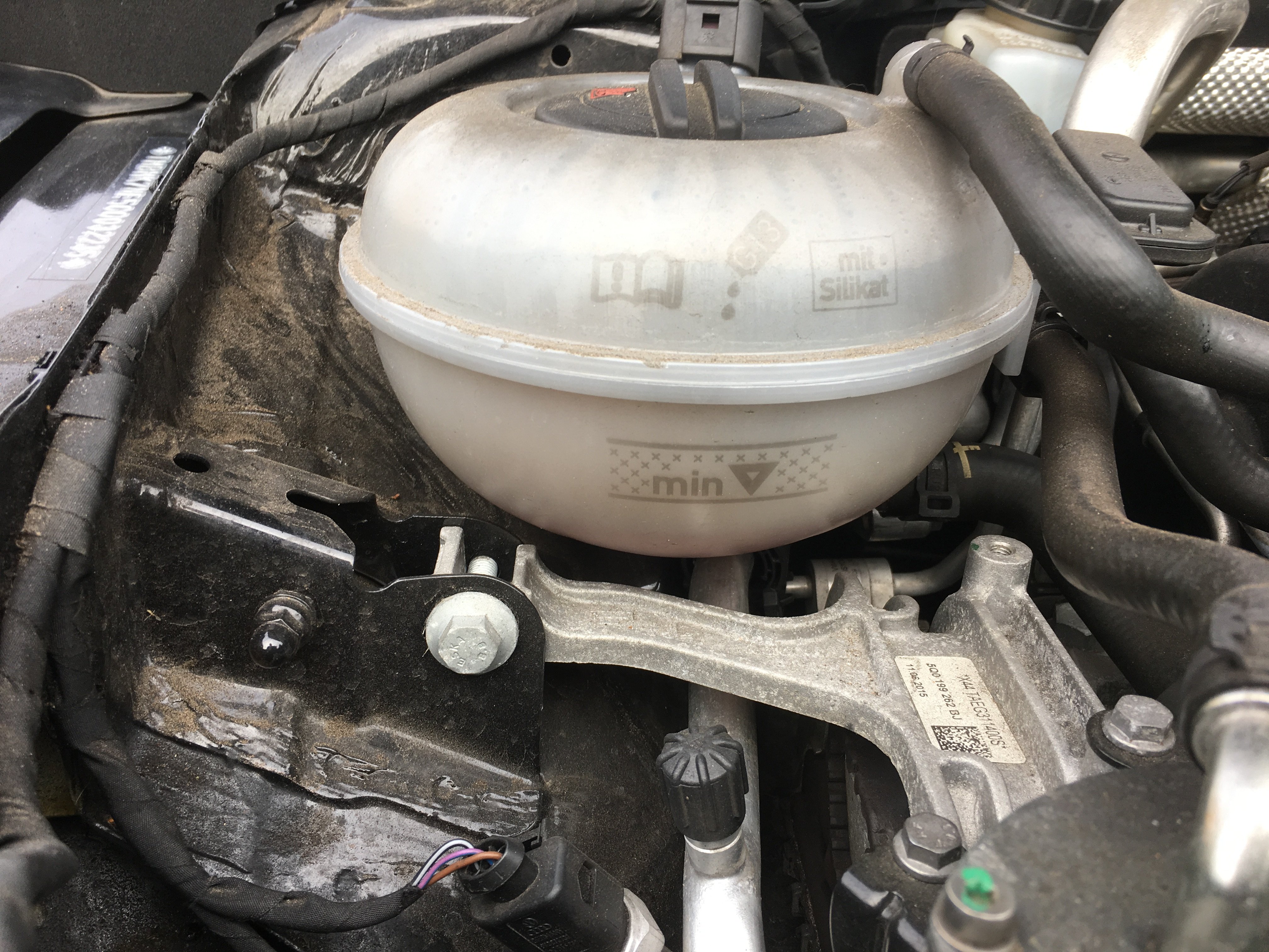

Had the same problem with a 65 plate Octavia Scout temperature shot up  and warning light came on stopped checked coolant and was empty so must have been some size of air lock in system went back to dealers. And it seemed to have remedied itself.
 I have a picture or the coolant tank and the tank is absolutely empty topped up and seemed to sort itself but strange.
