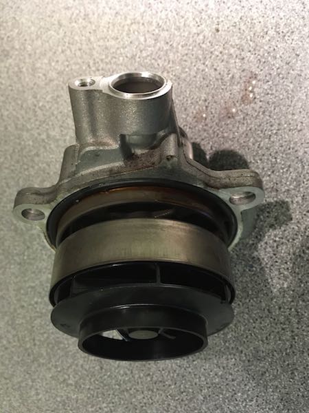

I took my car to a VAG specialist. He hadn't heard of the issue before (which surprised me a little, presumably most cars experiencing this issue are still within the dealer network) so it took longer to fix than I hoped as he spent some time (and a few parts) confirming what the cause was.

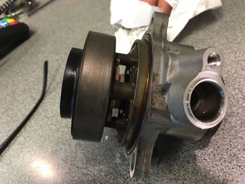

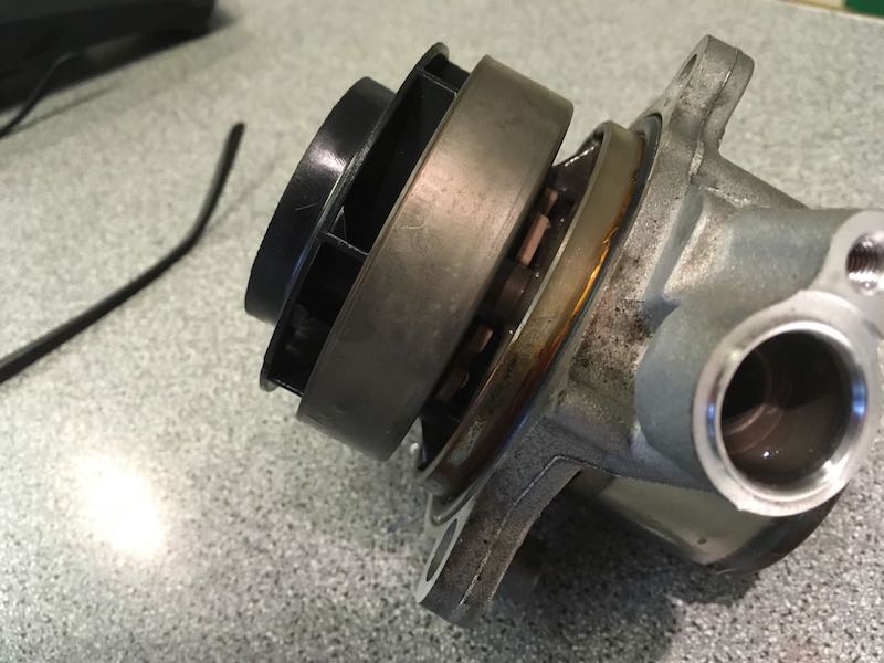

He did show the me the old pump. I took a couple of crappy photos as I hadn't actually seen the offending part previously.
Here is the sleeve covering the main impeller blades in the 'engine cold - warming up' position.
and here is same pump with the sleeve open in the 'engine warm - normal cooling' position, exposing the impeller blades;
IMG_2590.jpg.c7a3ce91ec684c27dedab48ef4a55c9d.jpgIMG_2587.jpg.7a6da534789f2b2fef4490541a0128be.jpg
It took a surprising amount of force to slide the sleeve from the closed to the open position, even using two hands I thought I was going to cut my fingers on the edge, but you could move the sleeve on the new pump using just your fingers.
It was about 18 months and about 85K miles early, but I had the timing belt replaced at the same time (as I was paying, and the water pump was off it was a 'no-brainer'), so hopefully I have a couple of years of 'cheap' motoring ahead.
Once I got the car back on the road, the temp gauge hasn't moved past the 90˚C mark since. Ultimately I'm disappointed that such an important part failed just out of warranty, but mainly I'm relieved that I'm no longer watching the temp gauge like a hawk for the first 15 minutes after starting the car from cold.
