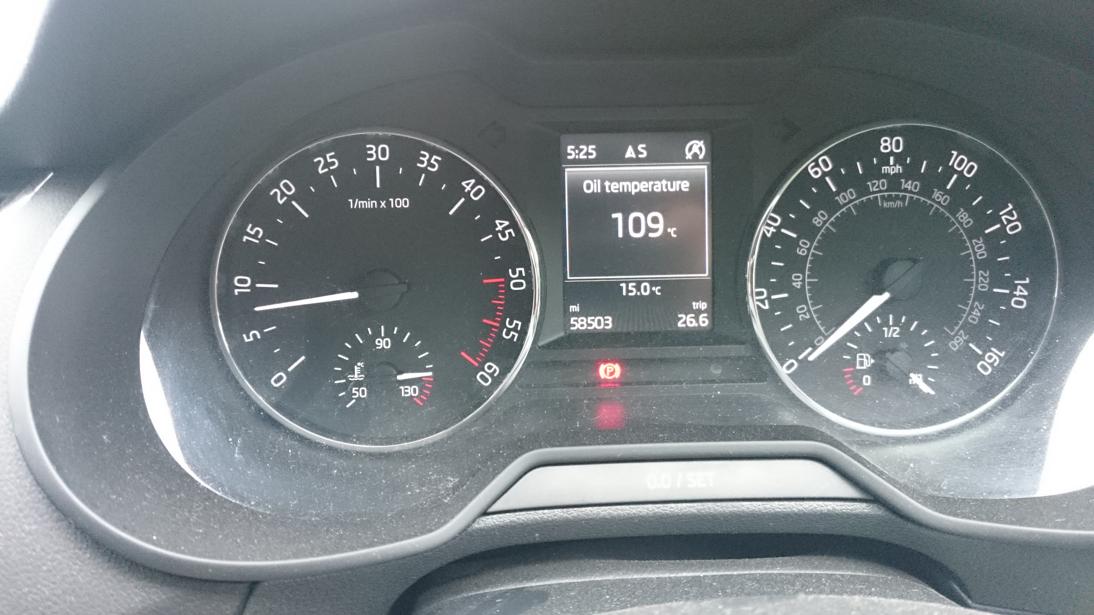

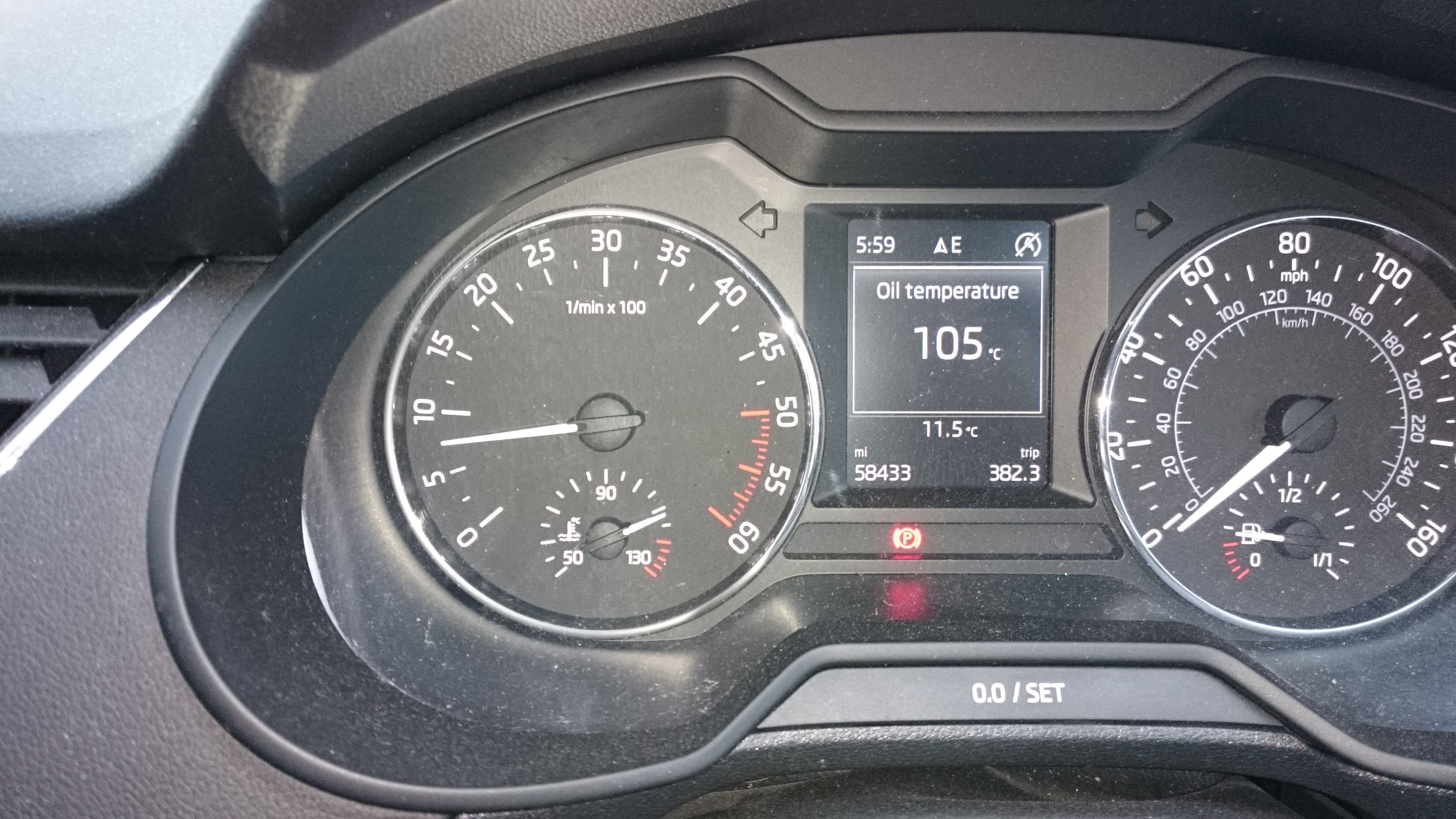

My 2013 Octavia 2.0TDi is now starting to show overheating too.  See the pictures I've taken to prove it!
DSC_0003.thumb.JPG.31ac712de21f96c90a7dece11fe625dd.JPGDSC_0001.thumb.JPG.46a3211a4b3cf7ac06f24e5adfcf2968.JPG
Car has been in the "lease company specified" independent garage, who (unsurprisingly) cannot find anything wrong.  I offered to show them these pictures, but was told their "experts" would be able to replicate....which they couldn't.  But it clearly happens (as above!)
So now it will overheat generally every other day.  When it first happened to the wife, the gauge went into the red and all the alarms, etc. scared her rigid!  I generally keep an eye on the gauge and never let it into the red.  Pull over, engine off, engine back on about 2 minutes later and all is well.  But I have no confidence now that it won't happen at any time without real warning.
And if the garage cannot find anything "wrong" they can't fix it!
Over to the lease company to see what next.
And taken the shine off what was, up to now a flawless first experience with Skoda :(
