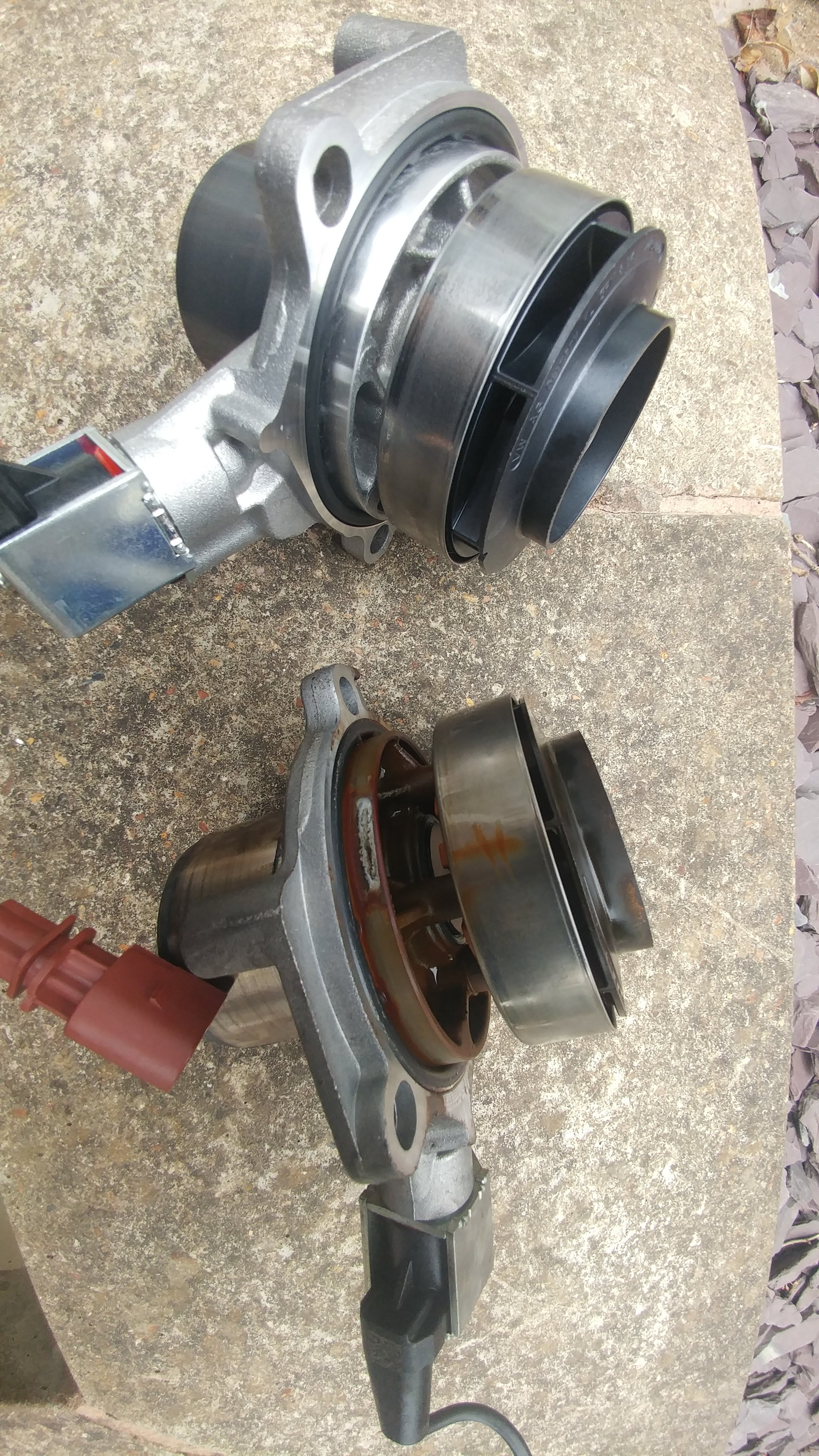

Replaced the pump today. You can clearly see in the photo the old and new pump. The steel ring around the impeller is jammed shut

I have a VW technician in Canada who I was talking to about this issue. Never heard of it done one or even seen the pump design when I sent him those photos I posted on here. Said must be a reason for designing it in but over engineered. Must be a European thing.
I have noticed though with this current cold weather the engine doesn't seem toheat up any quicker with its new pump unlike in the summer mornings.
