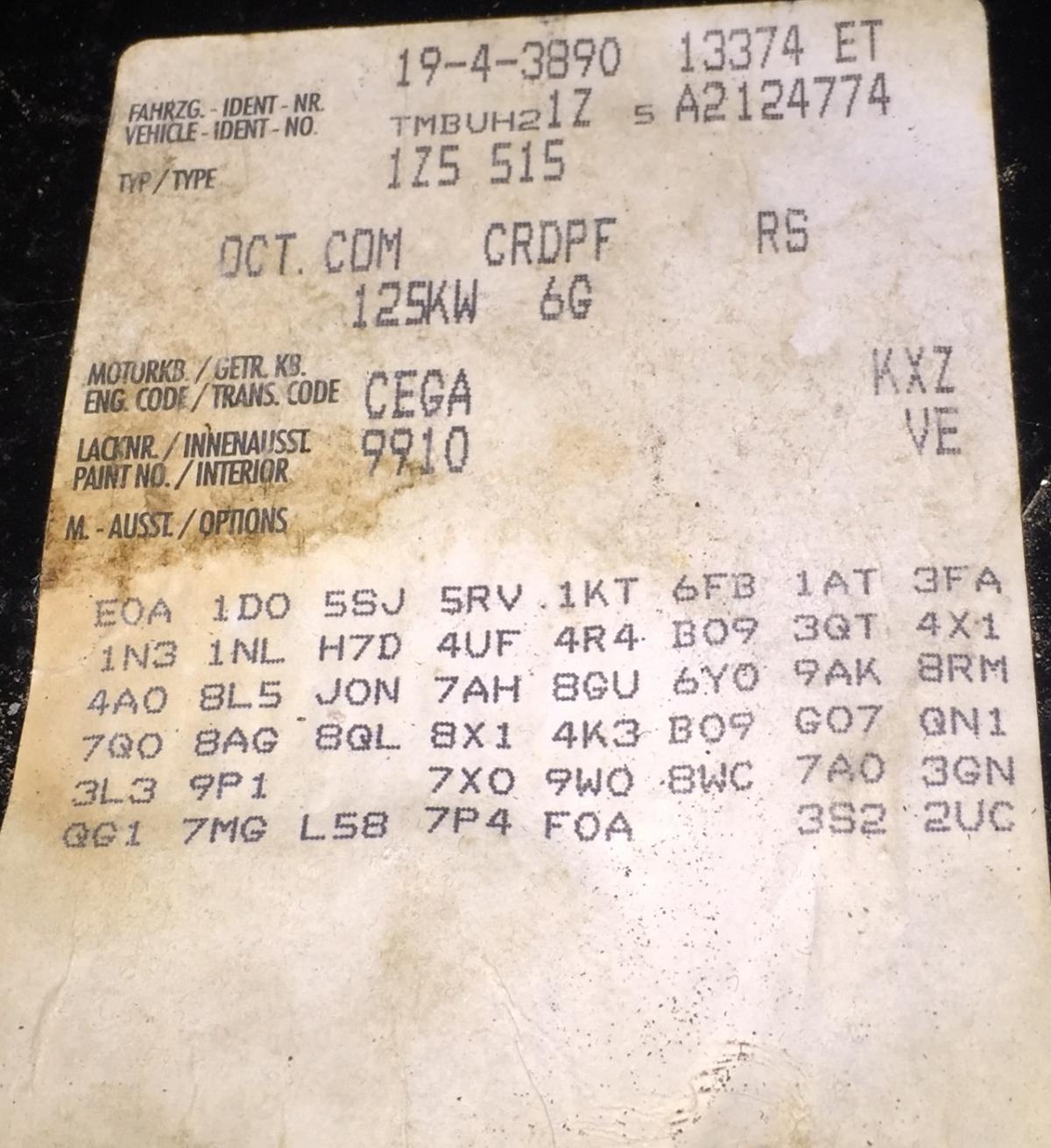

Hi freedom. Not sure how to tell that it's a 2l TDI and the engine code is cega does that help
Think it's a CR the sticker on the boot says CRDPF
It's a CR, so you can try a regen whilst stationary.  Have you done an autoscan?  Were there any faults?
