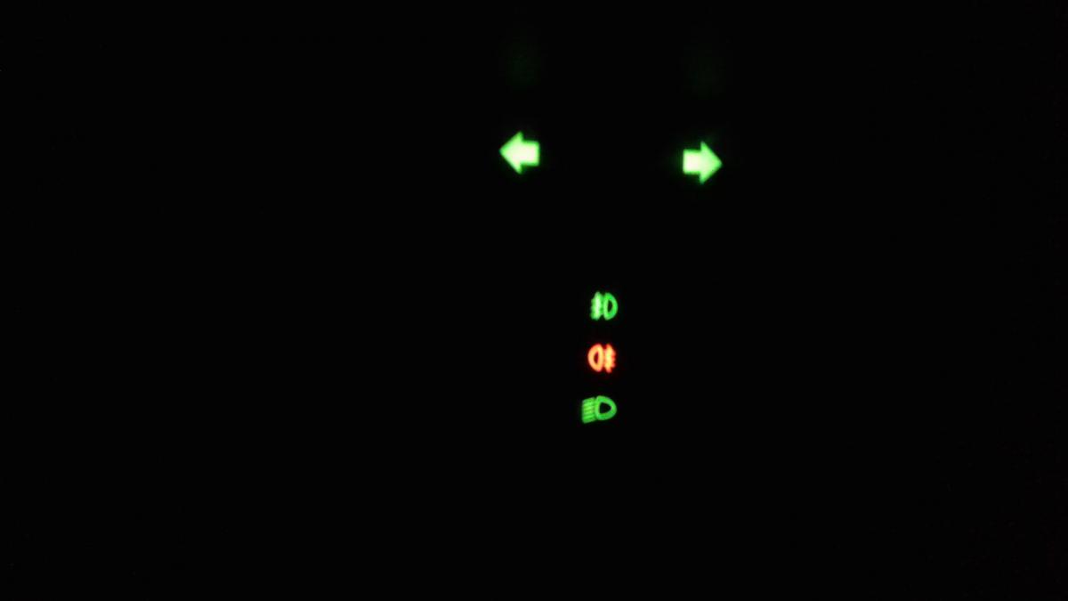

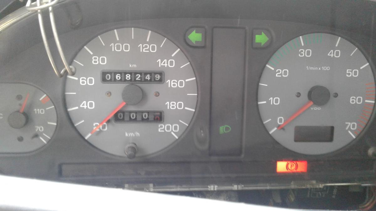

guess what happened. when i turned on the light in evening  the dashboard was off completely. i meant the dashboard´s light did not turn on, on the top of  that, the gas reader,  and speedmeter shut down  and  temperature gauge was all the way to top. meaning the light is controling  the hole dashboard.  please take a look at the picture.

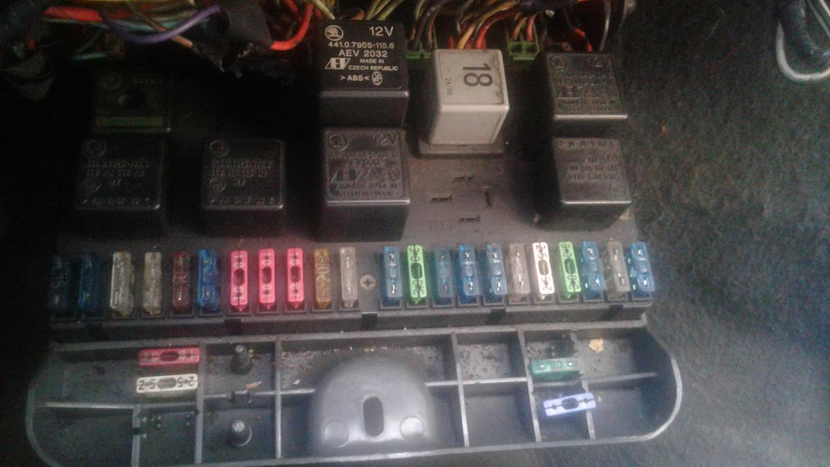

i would like to upload some picture, so you can see how this is acting out. the fuse box picture is just make sure everything is laid out well.

The backlight not working - check blue trace
The fuel gauge not working - check magenta trace
The tachometer not working - check green trace
The temperature gauge needle stuck up - check magenta traces (see photo below)
