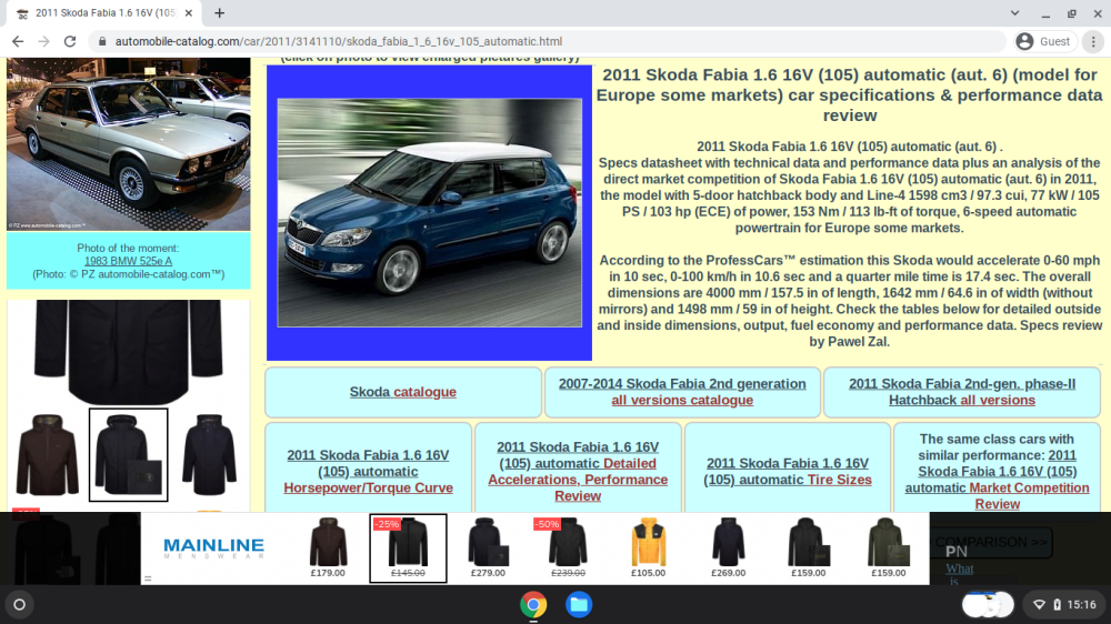

A mod can maybe move to the Fabia Mk2 section where the other post is. ? Did you have the car last winter when cold? What engine does the Fabia have? I take it you have a 7 speed twin clutch DSG, a DQ200. How many miles has the car done? There might well be an issue with the DSG. Or, is it a late registered 1.6 petrol with a Tiptronic Automatic box?
