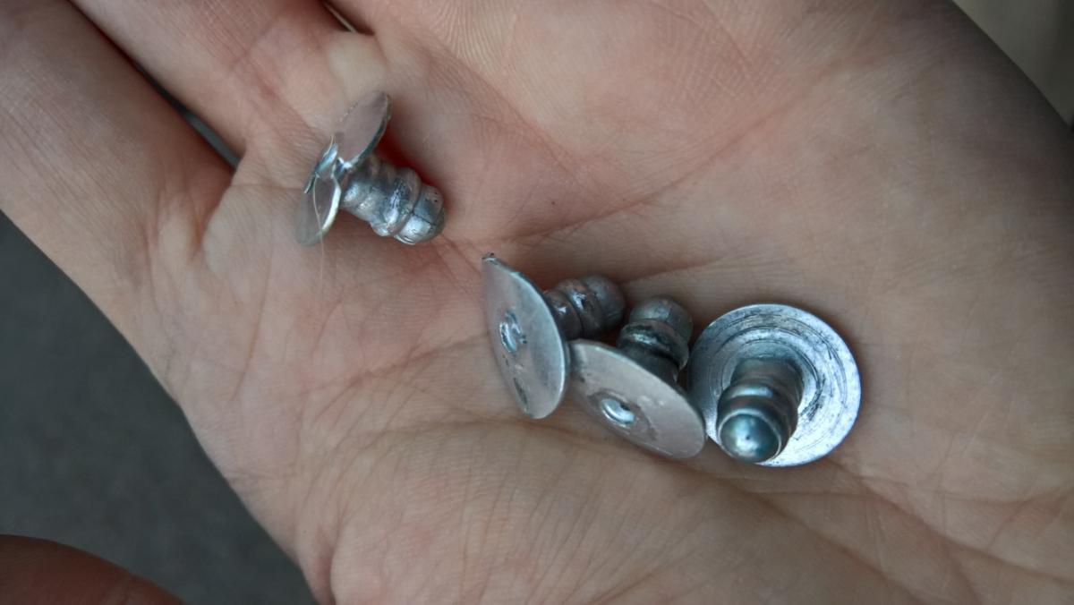

This caused me to bite the bullet and get the inner door off, by popping out these metal rivet things, that got badly bent in the process (picture attached).
Why on earth these things are used?! If I was cynical I'd suggest that VW do it so you have to take it to a garage to get anything done...
Anyway, I got the panel off, pulled the window up, put it back on the plastic thing it sits on, and managed to hammer a couple of the rivet things back in.

  1. What are the rivet things called, and can I buy new ones? If so where?
  2. How are they removed (I used two flat-head screwdrivers, and scratched up quite a bit of the panel) and fitted (hammer?)?

They are pop rivets, you are supposed to drill them out.
The same thing happened to me two days ago with the blind not impressed
Yeah, found out they are rivets. 6.4mm, part number 910-788-01, and Skoda charged me £6 for 10!
They are attached using a rivet gun, and detached by drilling out.
I have had to order a rivet gun, since these are larger than normal rivets!
