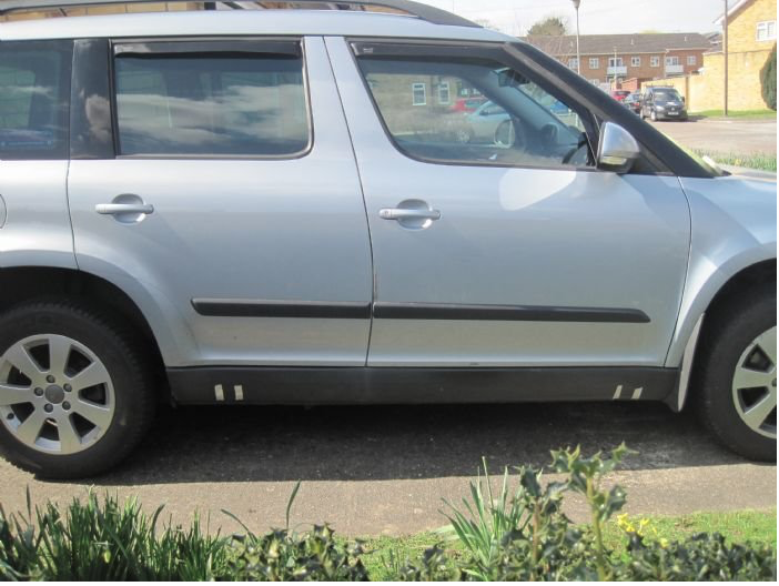

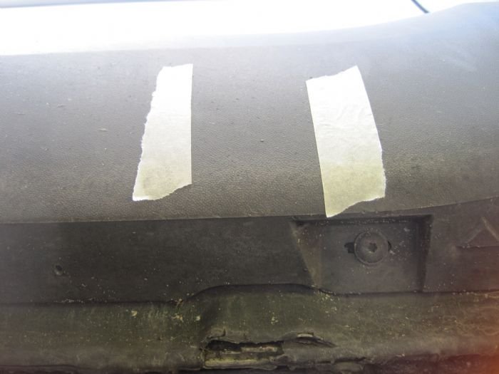

  • They look like drains to me. Jacking point usually has a downward pointing triangle on that seam.
  • Aaaargh.   You can see the triangle mark in the lower picture, only just in shot on the right.   That drain hole is suffering from jack attack   The seam sealer has broken it's sur

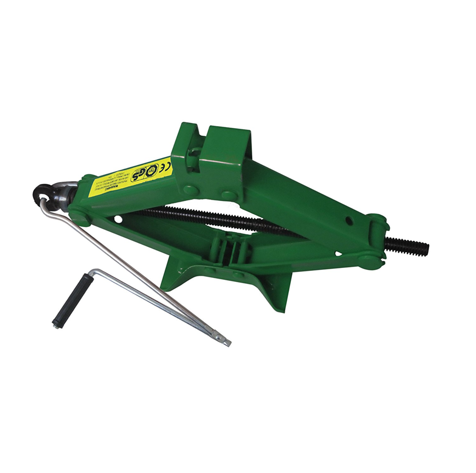

Anyone any experience of using this jack that claims to be Yeti specific?...
1 hour ago, Dale_Stevens said:
 but do you think where he felt for the thicker seem he should instead have looked for the triangle and got his head underneath? Is there a chance he got it in the right position purely by luck, or did he definitely get it wrong?
No - he specifically mentioned the thicker part of the sill as a drain hole, he felt for it and located the jack there. It was in the wrong place. It looked in the wrong place as well. I wasn't there with a ruler!
The problem in using the drain hole is the possible squeezing together to close it off - it is a drain point so that would be no good! If not squeezing tight shut, the seam sealer is squidgy (technical term) and could move and effectively close the drain hole same result.
That's why, I guess, VAG chose a point not near the drain hole.
 That's a good find - never seen one of those before. It has a nice flat area to butt up against the corner of the floor panel as intended and would probably spread the load more than the OEM VAG jack.
I don't need one, as I use the urethane support in the link above.

A couple of pictures I found on another forum with markings indicating the jacking points as being 5 1/2" back from the front wheel arch edge, and 7" forwards from the rear wheel arch...
1487417372_ScreenShot2020-10-11at15_01_18.png.fcb27614f47b88099fa0a403b9da5f0d.png139759072_JackingPoints2copy.jpg.99f58c0bf3997e2368c356a6a7a54935.jpg
Aaaargh.
That drain hole is suffering from jack attack :wall:  The seam sealer has broken it's surface, so it's not sealing and letting moisture in, the opposite action you are trying to prevent - metal showing - typical of what I was on about in above.
Not a pleasant sight, but I guess not many care where/how they jack it up. That's why I'm keeping my car as long as I can, because I know it's strengths and weaknesses.
