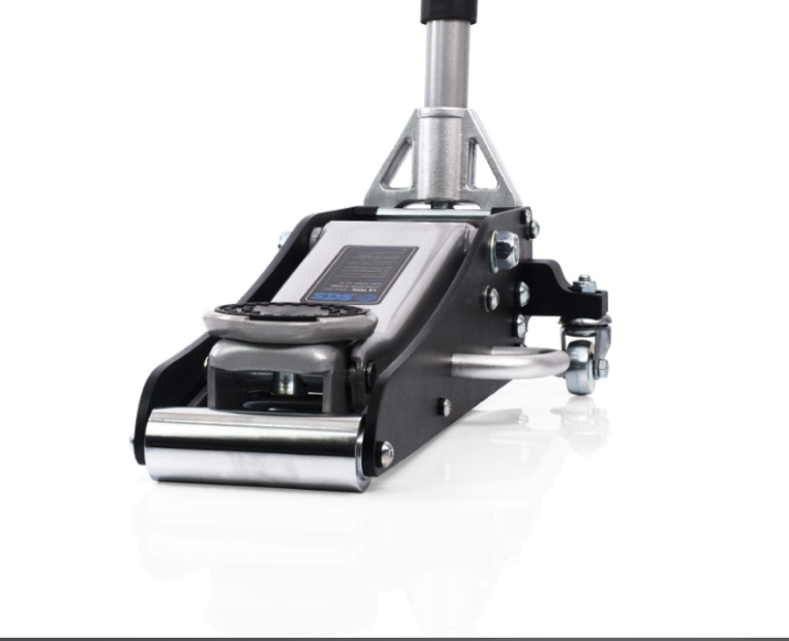

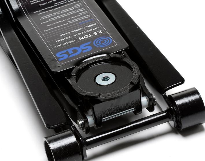

Clearly there are a lot of forces ar work when jacking a car, which got my mind wandering....
As the photos below show, some trolley jack saddles are flat, others have a raised ridge around them. Is there a likelihood of a pad slipping off a flat saddle as there's no ridge to hold it in place? Or, would the forces involved mean the pad is kept in place?
With a saddle with raised ridges, If the pad is wider then surely its flat base wouldn't balance well sat on top of the raised ridges?
With a flat saddle, would a pad stay in place just sat on (or even overhanging) or would it need to be small enough to fit inside a raised ridge saddle?

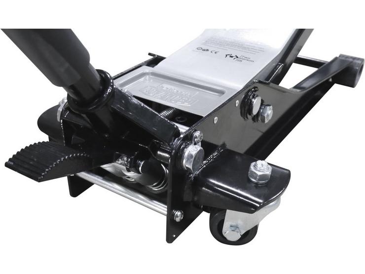

I like the idea of those that also have a foot pedal for lifting the jack, though I can't be certain thats a feature I would actually use?

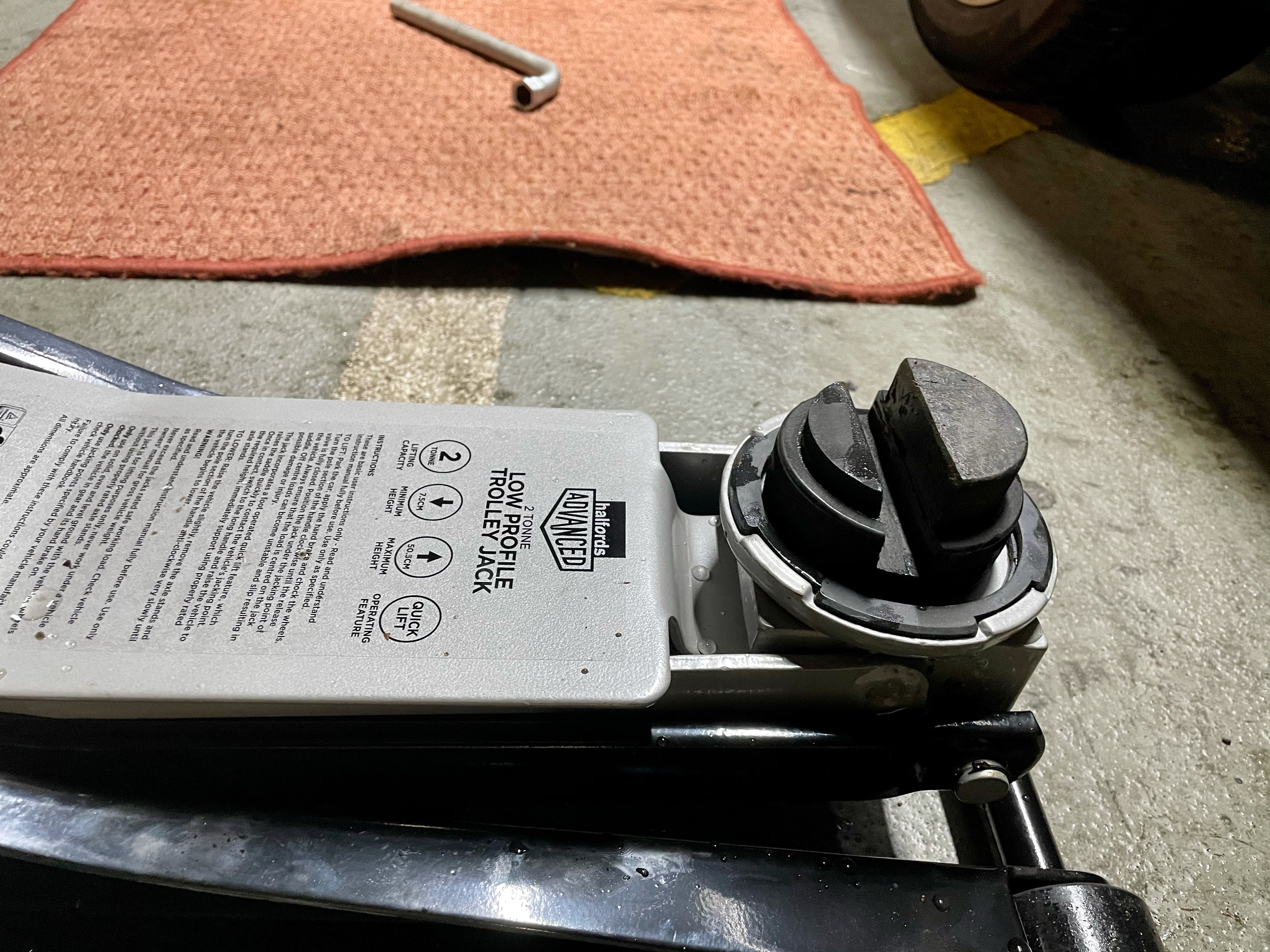

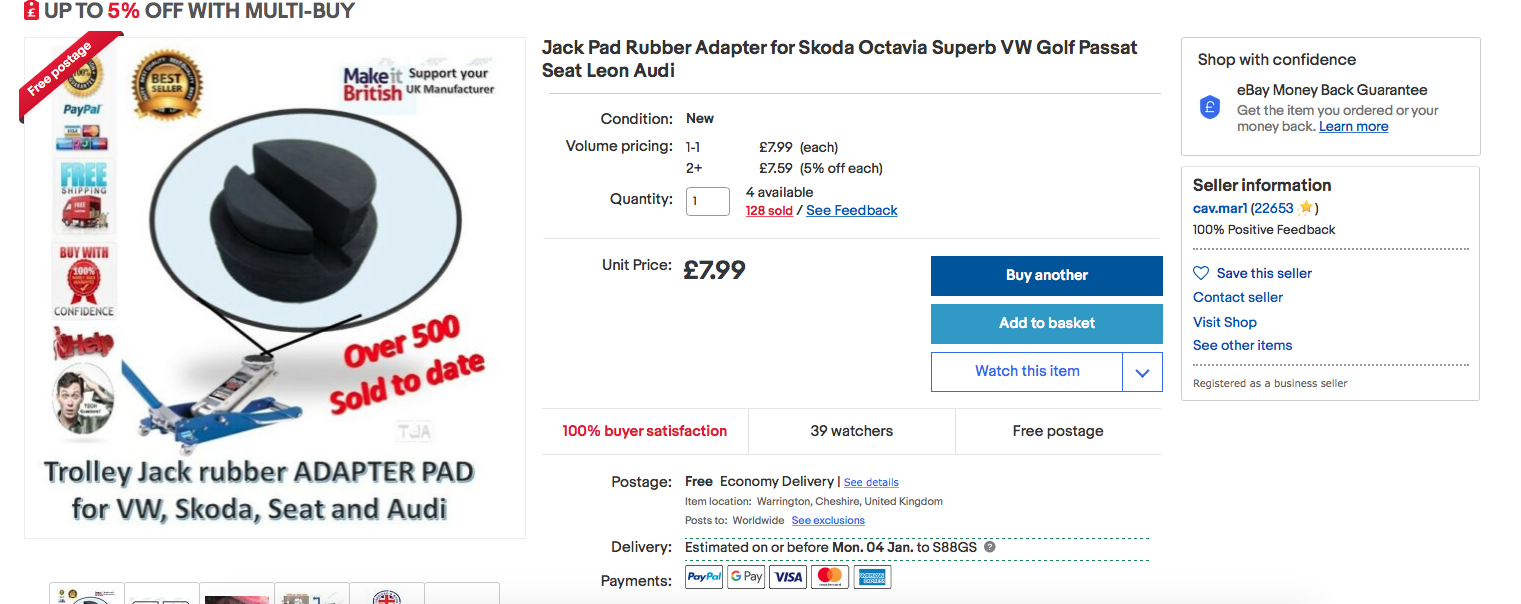

Rubber jacking pad from eBay..
I bought the Halfords 2 Tonne Trolley Jack which Im pleaded with. It has a foot pedal for quick lifting, which I found useful when laying on the ground lining the jack pad up to the jacking points, I could press the pedal with my hand to inch the jack up into position, then stand up and operate the handle/lever for the main lift.
