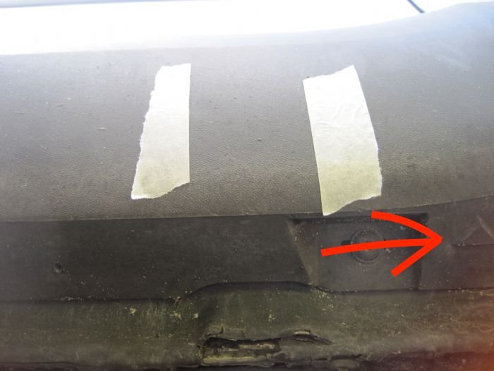

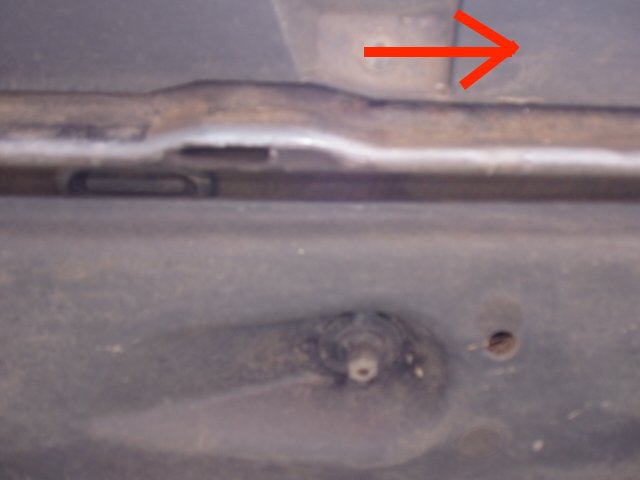

Heres where the confusion started for me.
The photo with the incorrectly placed masking tape shows the triangle to the right..
Whereas a photo from this thread doesn't have the triangle at all.
I don't think anyone can be to blame for not knowing where they are, especially if you can't see the jacking point until you are underneath the car, and to do that it has to be jacked up.
However I now know that the correct place is to the right of the drain hole, even if the triangle isn't there.
But I'm not sure if they are the front or rear jacking points?
Edited by Dale_Stevens

Well, well well!!!
Now it has dawned on me that the triangle is on the lower part of the plastic sill cover and the photograph has been taken from the ground facing upwards in a space too small to fit a human head even if most of the forum members could see that close in the gloom,................
I have just been out and had a feel with my braille like hands and there is indeed a raised triangle moulded at the front ahead of the drain channel & the screw fixing.
I suspect that its a recycling symbol for the plastic though!!!!
Yety, use a pair of trolley jacks and never jack up on the sill but would have do so if I get a puncture on the road.

So from the two photos I've posted, one with the triangle and one without, can anyone explain why the triangle is missing from one of the cars? Did Skoda stop including the mark?

Just crawled out from under my SJ as prepping for MoT test, and I see the the "discussion" raging on.
May I suggest that the photos above are from two different locations - one from the front warning marker, and one from the rear. And yes, the raised moulded sign is facing down towards the road. The rear marker is +/- 85 mm in front of the rearmost drain hole, centre to centre - I can't get a more accurate measurement as it's only an electronic caliper :speechless:  VAG not would make a special batch of plastic sill covers with the moulded in markings missing!!

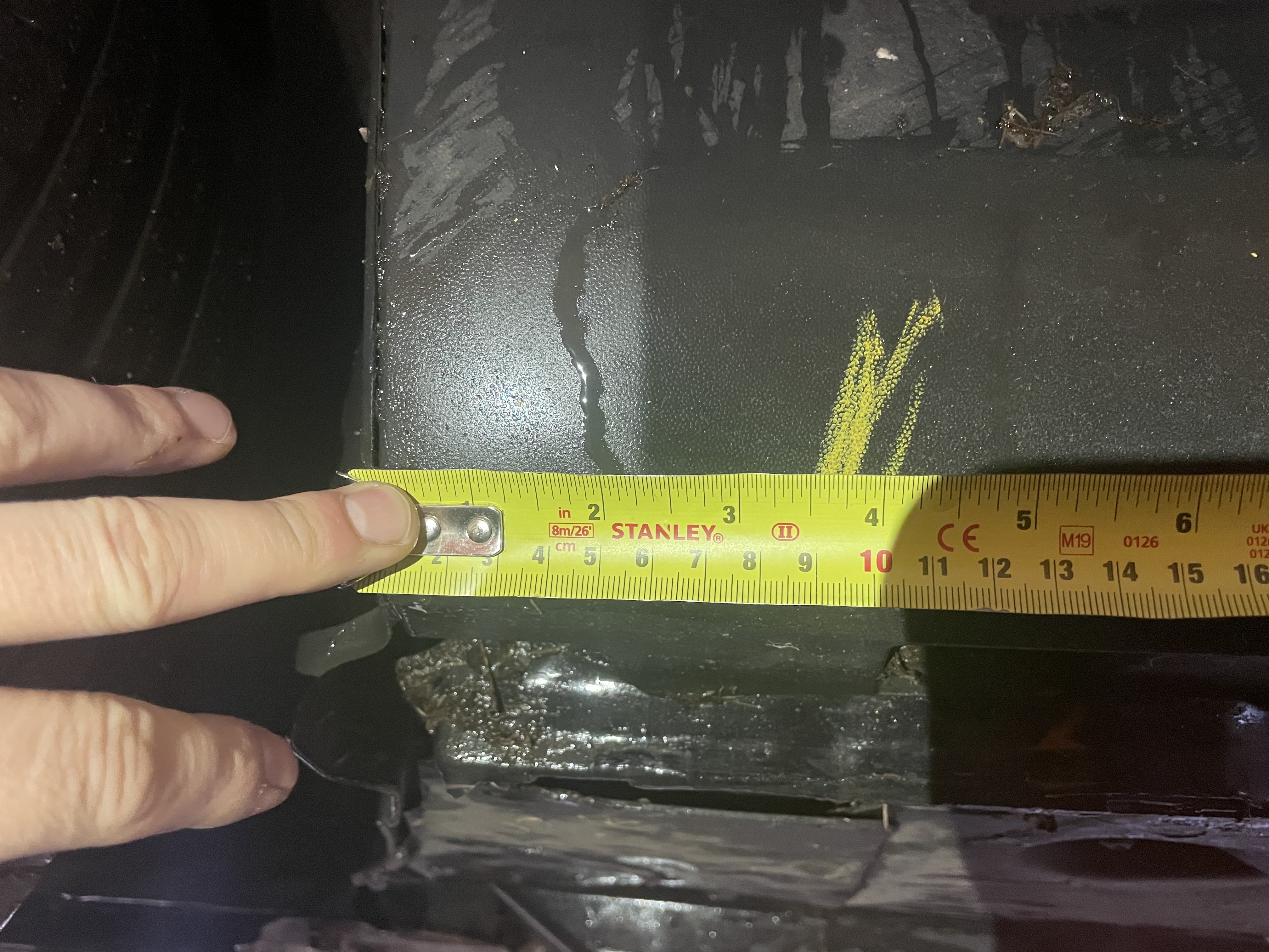

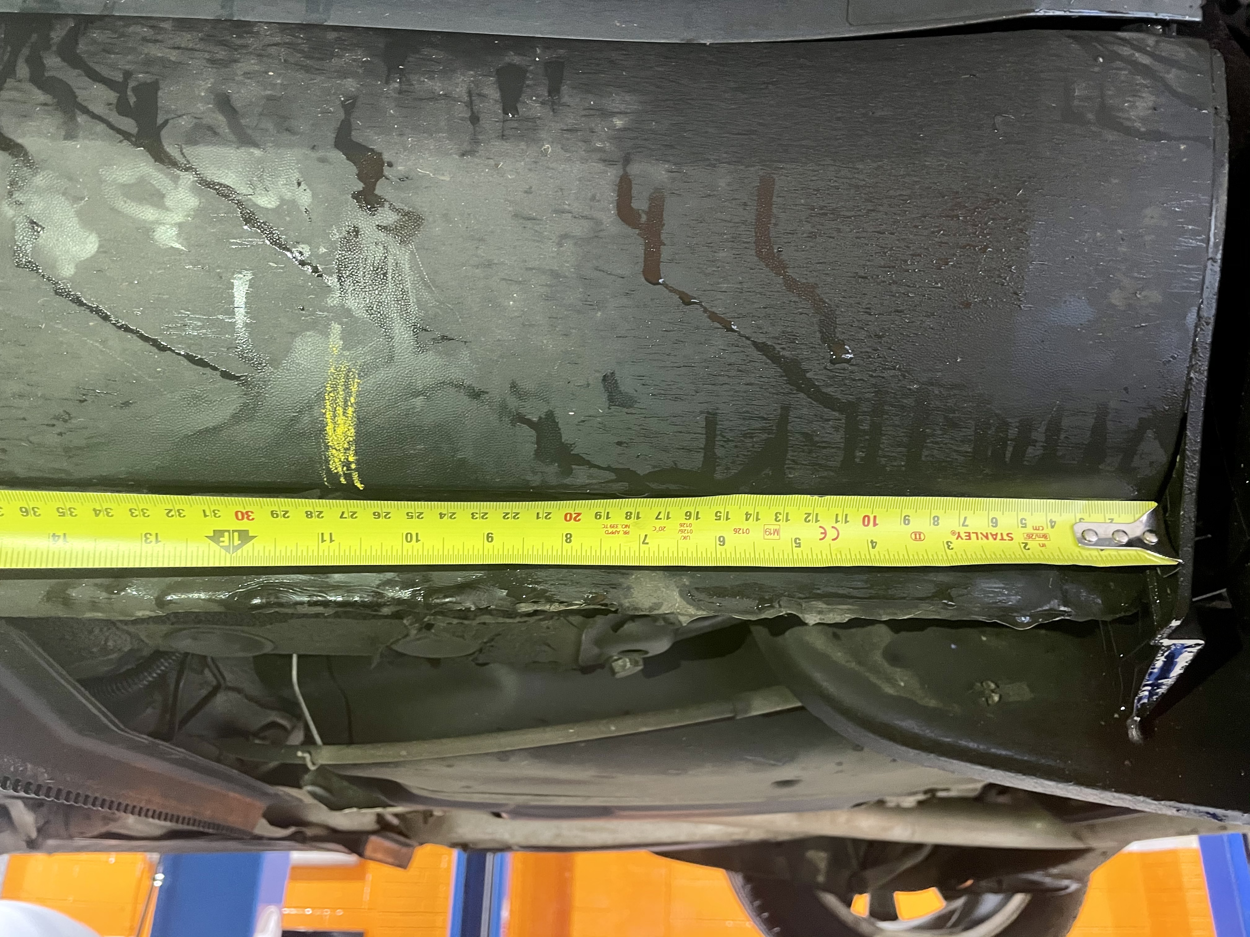

Picked up my new set of All Season tyres from my local garage today and they let me put my Yeti on their lift so we could see the triangle markers. I have to say, even with the car lifted 6ft up in the air and us standing directly underneath the cills, it wasn't easy to see the triangles, even with a torch to assist.
We did find them though, but more through feel, I marked their positions with chalk onto the sides of the car, with the chalk mark directly in line with the triangles, and took those photos...
Front marker
Rear marker
