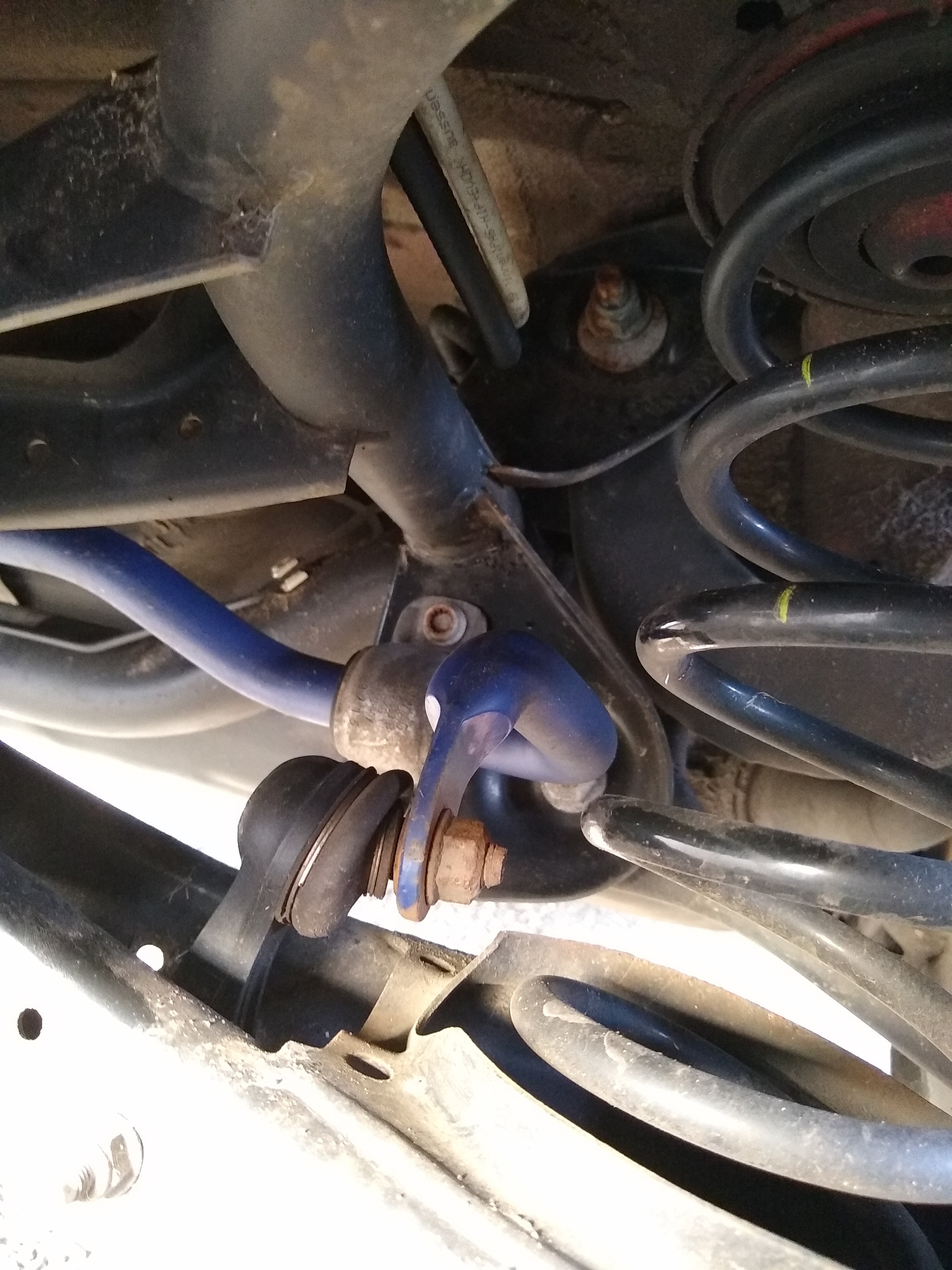

If you upgrade your ARBs consider replacing the droplinks at the same time otherwise you could end up with front and rears failing a couple of months after the ARB upgrade. Presumably the extra forces on them from the thicker ARBs cause this (30k miles on the car, around 2k since ARB upgrade)
I don't want to lower the car too much, only achive more stability of the car. With installing coilovers I would void warranty on suspension so your post is showing what can go wrong.
