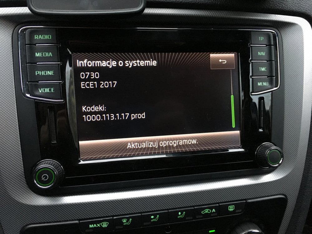

Navigation works with no issues:
Media Player:
Radio (DAB+)
ANDROID :)
Smartlink is not active (at least yet) :(
Voice commands work OK
Bluetooth HFP works OK
Issues to be solved:
1. SmartLink activation
2. Climatronic visualisation
A short movie

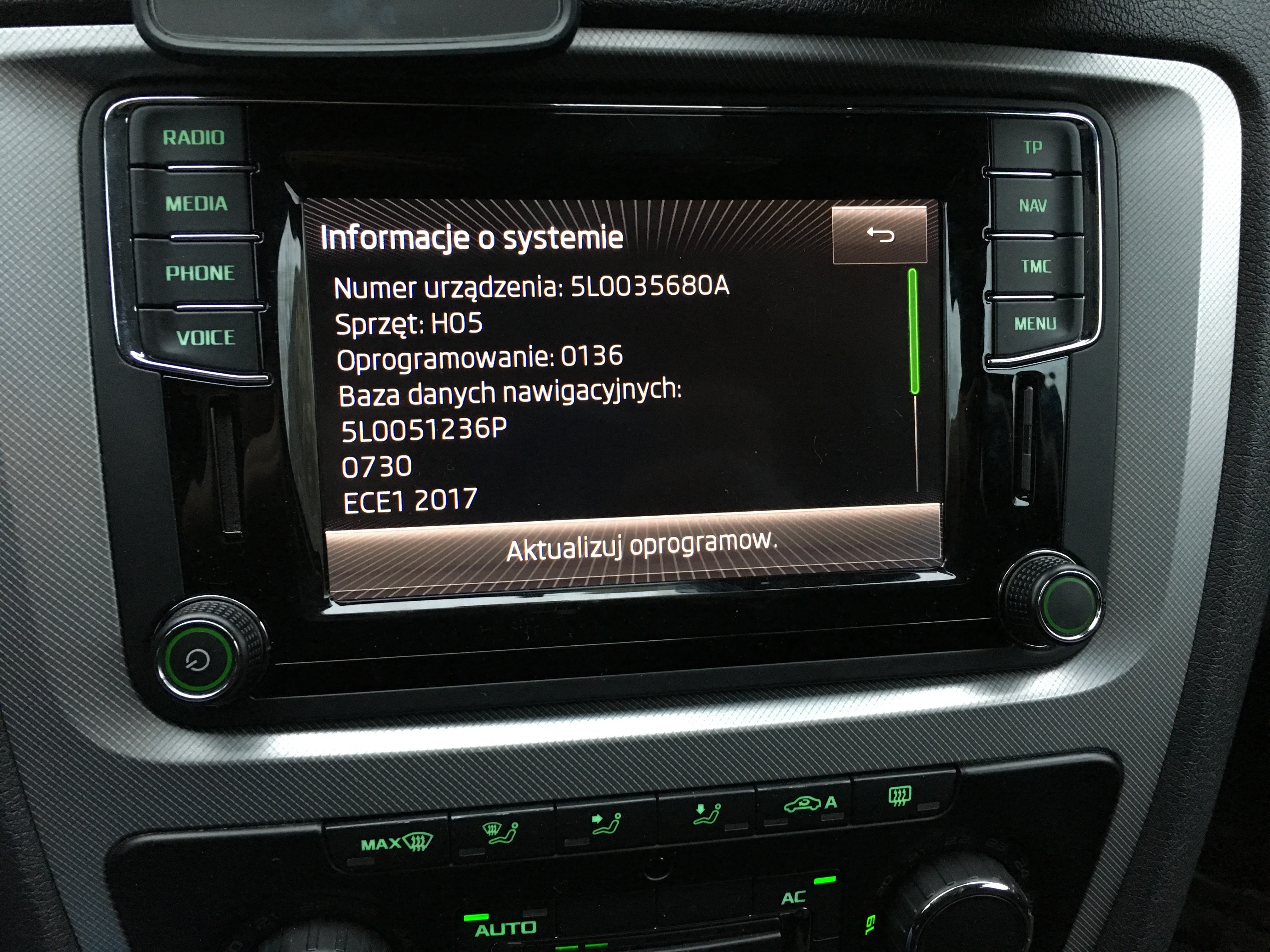

SW version of my 5L035680A is 0138 (H05).
Your unit may require coding to work with SoundSystem. I have never installed new Amundsen in such combination

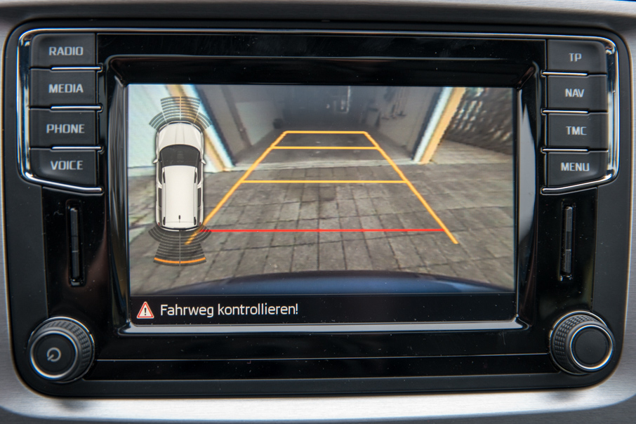

Last issue to solve:

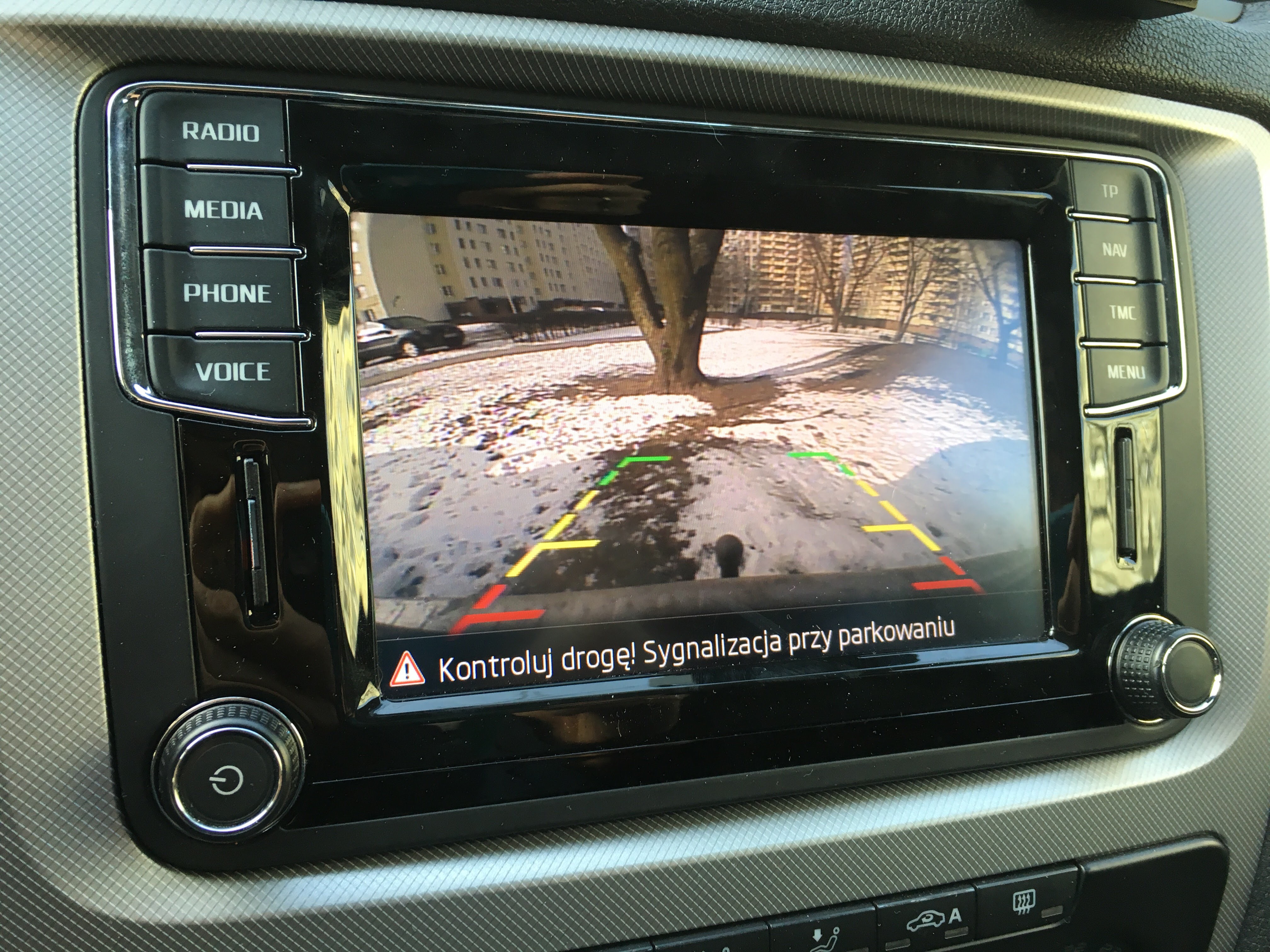

We do not get reverse camera picture and OPS display on one screen. This worked great with old RNS510. We're working on this...
Beside that, everything is working fine, also MFA integration.

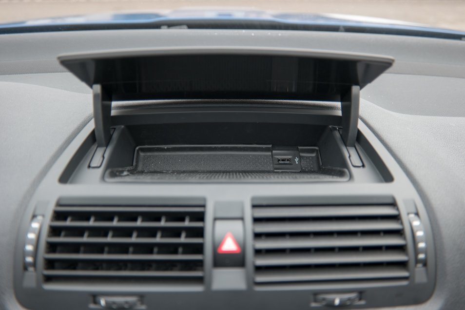

New USB socket mounted in storage compartment

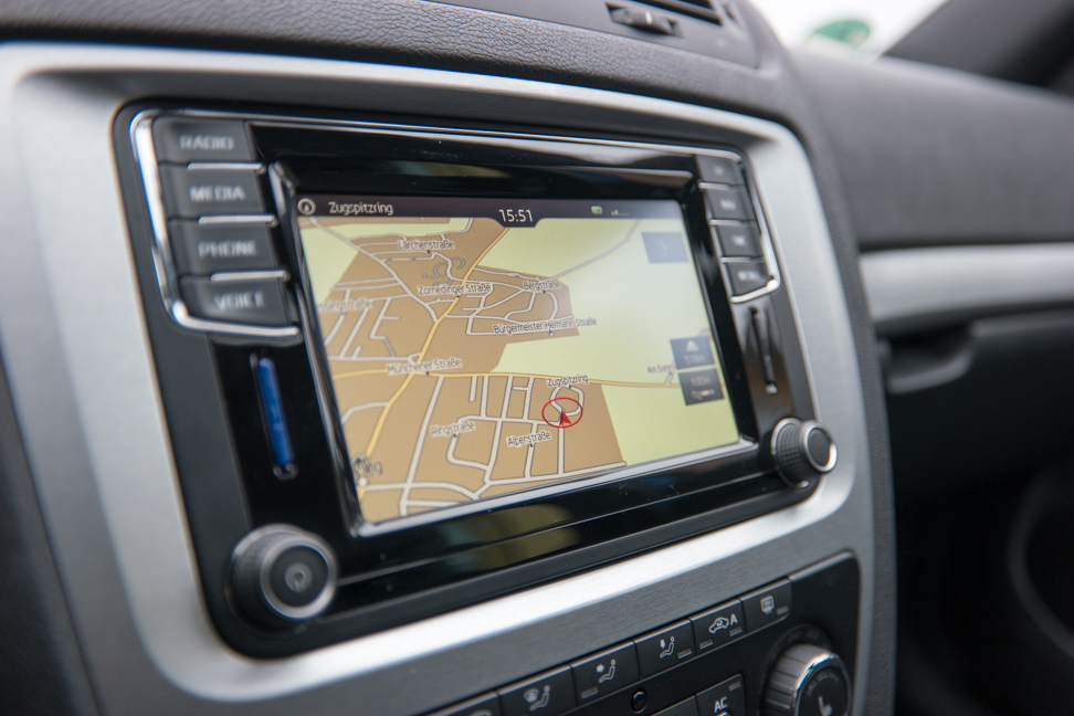

Navigation works fine...

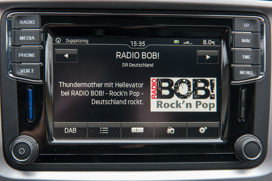

DAB tuner...

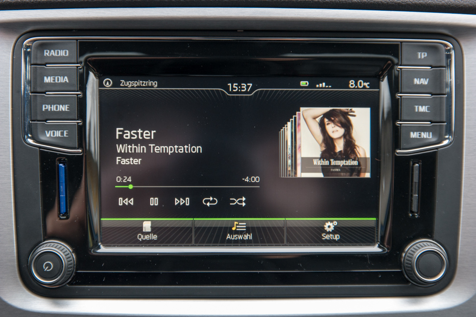

Media player from SD, USB, BT Audio works like a charm

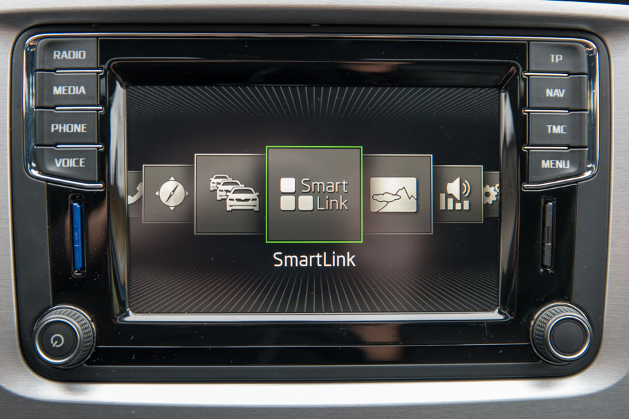

SmartLink is enabled...

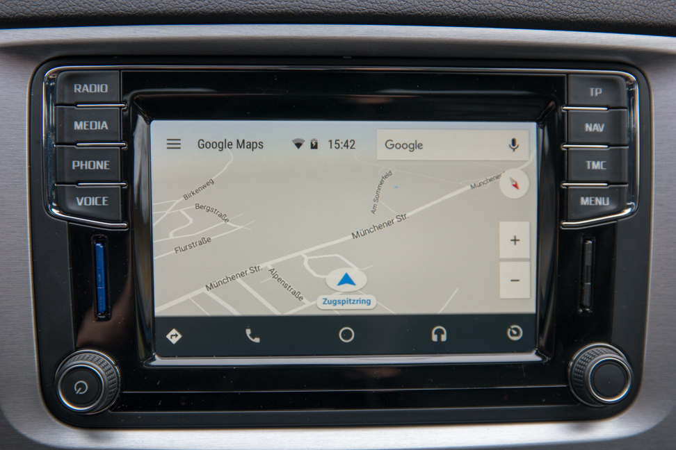

This is how it looks after coupling with an Android phone...
Google maps of Android Auto

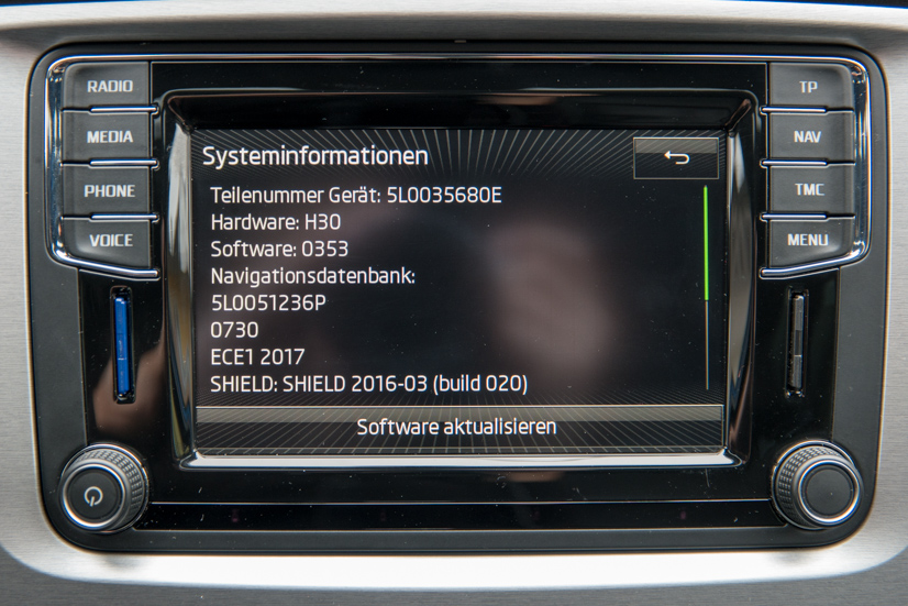

Some system information - yes, everything is just state of the art ;)

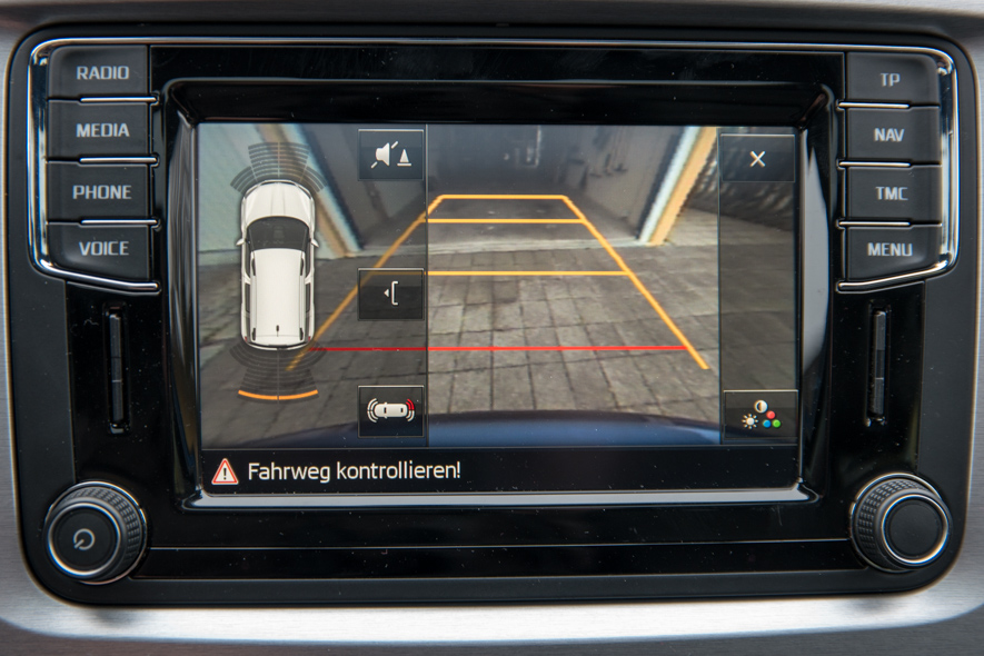

Good news! :biggrin: With a new PDC controller, reverse camera picture and OPS are displayed on one screen again...
The newest SW revision is needed on the PDC unit. I bought a brand new module for my Octavia 2 RS and it looks like this:

My previous software revision was 0005. I replaced the complete module, however, flashing the module would be also possible. At least the HW revision is still the same (H06).
Now, really everthing is working! :biggrin:
OPS display on the left with high line reverse camera:
After finger convergence, this menu emerges:
You can switch back to OPS only, hide OPS, mute PDC beepers, and control camera picture colors...

I don't know if a video is really needed. First, I can tell a bit what are my settings:
-Samsung Galaxy S5 (SM-G900F, klte) with LineageOS 14.1 (Android 7.1.1)
-Android Auto app installed from Play Store
-Connect the phone to the USB port via an original Samsung data cable (NOT every cable is working!)
-Goto "SmartLink" menu after connecting the phone, press androidAuto -> it will connect automatically and show a kind of installation wizard
Regarding the USB port:
If you prefer the easiest way, you can buy the complete cabling set including the socket at AliExpress: https://m.aliexpress.com/s/item/32748549653.html
However, I found it quite expensive and AliExpress has long delivery times...
You can also manually build it for low cost:
-You need to buy the combined AUX/USB-Socket with additional two 5V/GND pins for USB power supply. Check part number 5G0035222F for the complete socket, or 5Q0035726G for the USB part only. You can buy those on eBay.
-You need the USB cable with the yellow plug to the radio and the green plug to the socket. You can buy this here: http://www.ebay.de/itm/131876163752
Please note that this set includes the wrong socket, just throw it away or look for cable only on eBay.
-Afterwards, you need to connect the two power supply pins at the sockets to pin C.3 and C.4 of the radio quadlock. See the pinout attached:
If find the place for the USB socket quite nice, although there is not much space behind the storage compartment for the cabling. You need to be careful when installing, otherwise you break the green USB plug.
At the storage compartment, the phone is in a top position for best reception (GPS, mobile network). That was the main reason why I didn't installed the socket in the glovebox as it is usually done for MDI.
