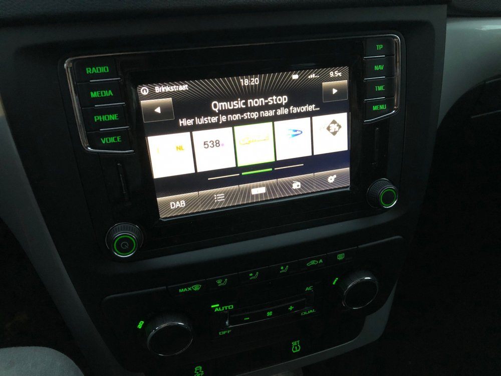

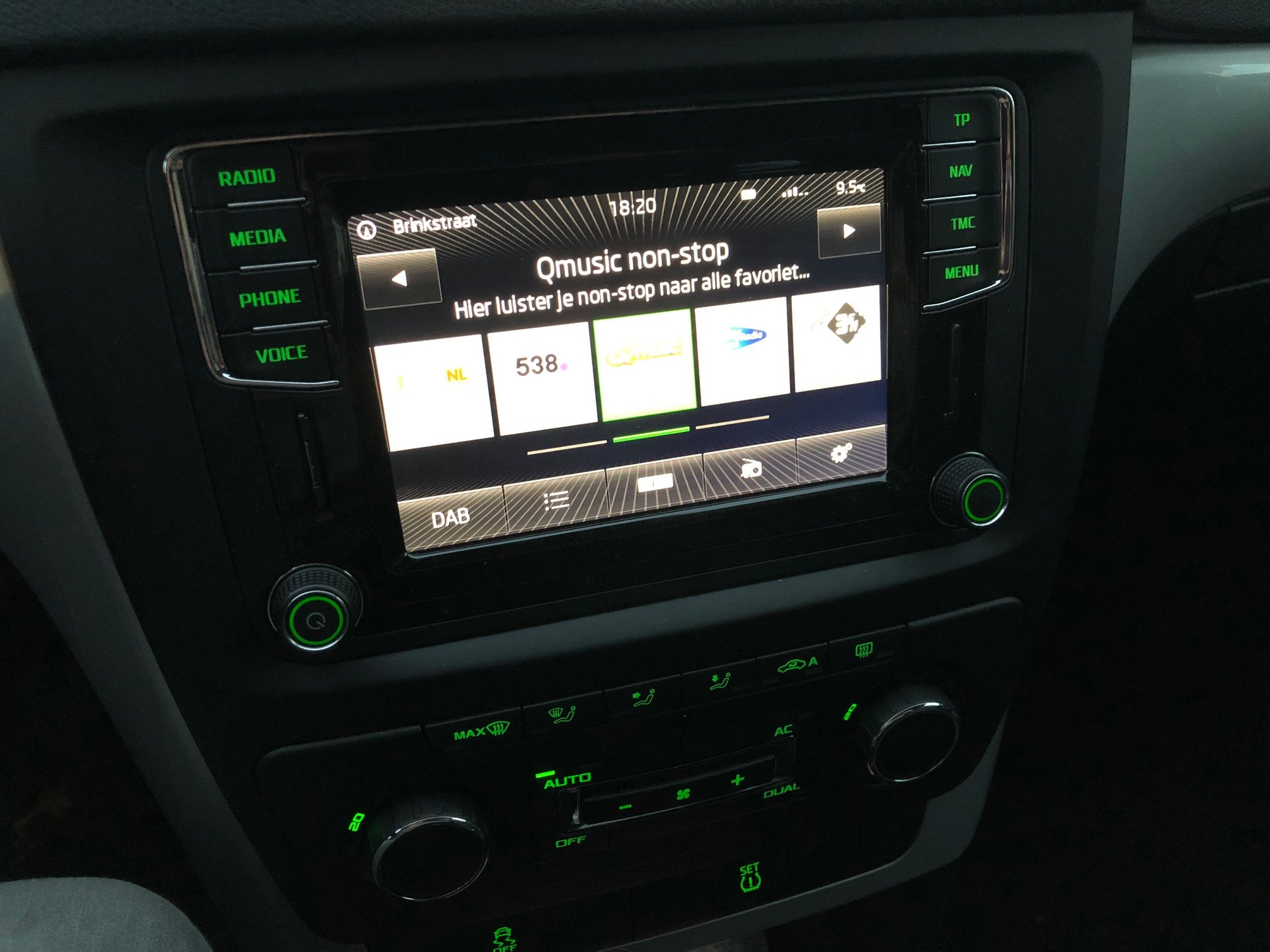

  • Navigation works with no issues:   Media Player:   Radio (DAB+)   ANDROID   Smartlink is not active (at least yet) :(   Voice commands work OK   Bluetooth HFP works OK

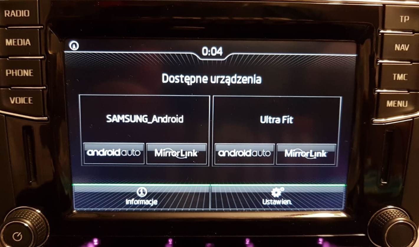

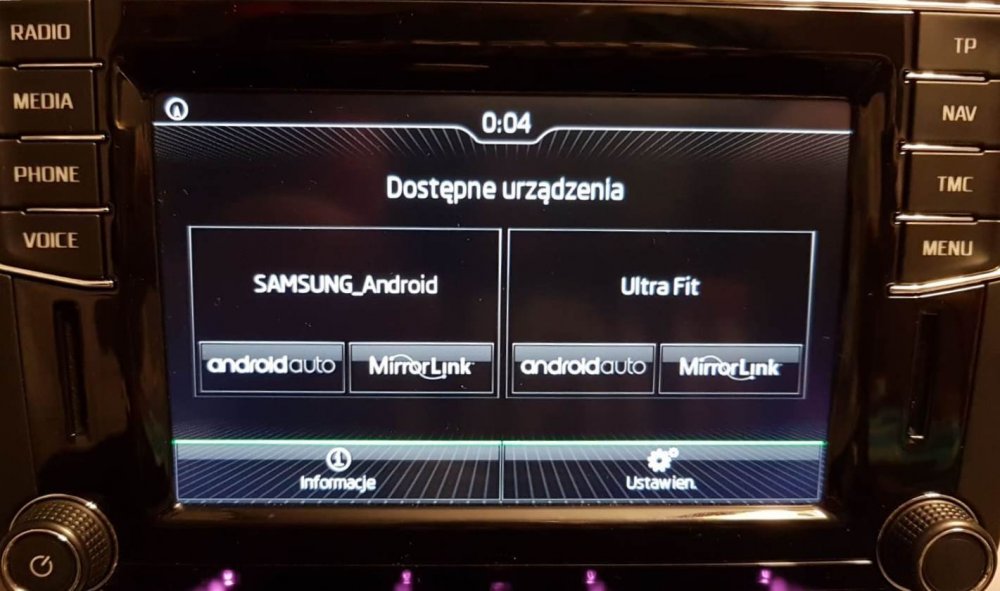

I have installed original VW USB HUB 5G0035953C and enabled 2nd USB :)
Now each of them can be used for SmartLink and powers / charges phone :)
Interesting! same with AppleCarPlay? does BT or handset work for both phones?
I have not tried CarPlay as I don't owe any iPhones... but you are welcome if you want to check :)

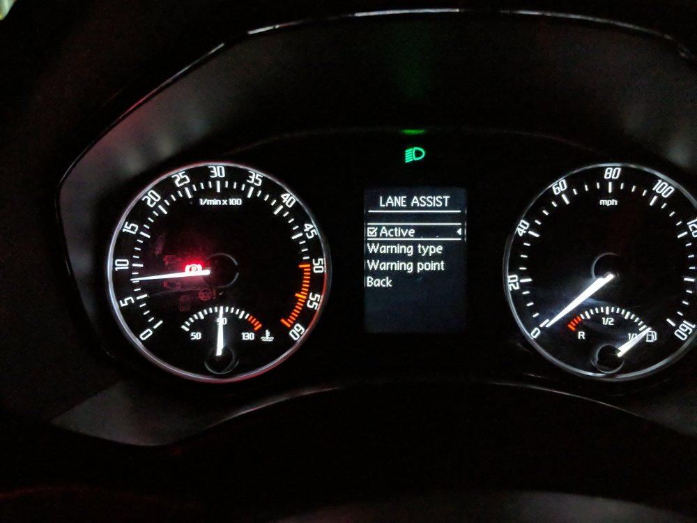

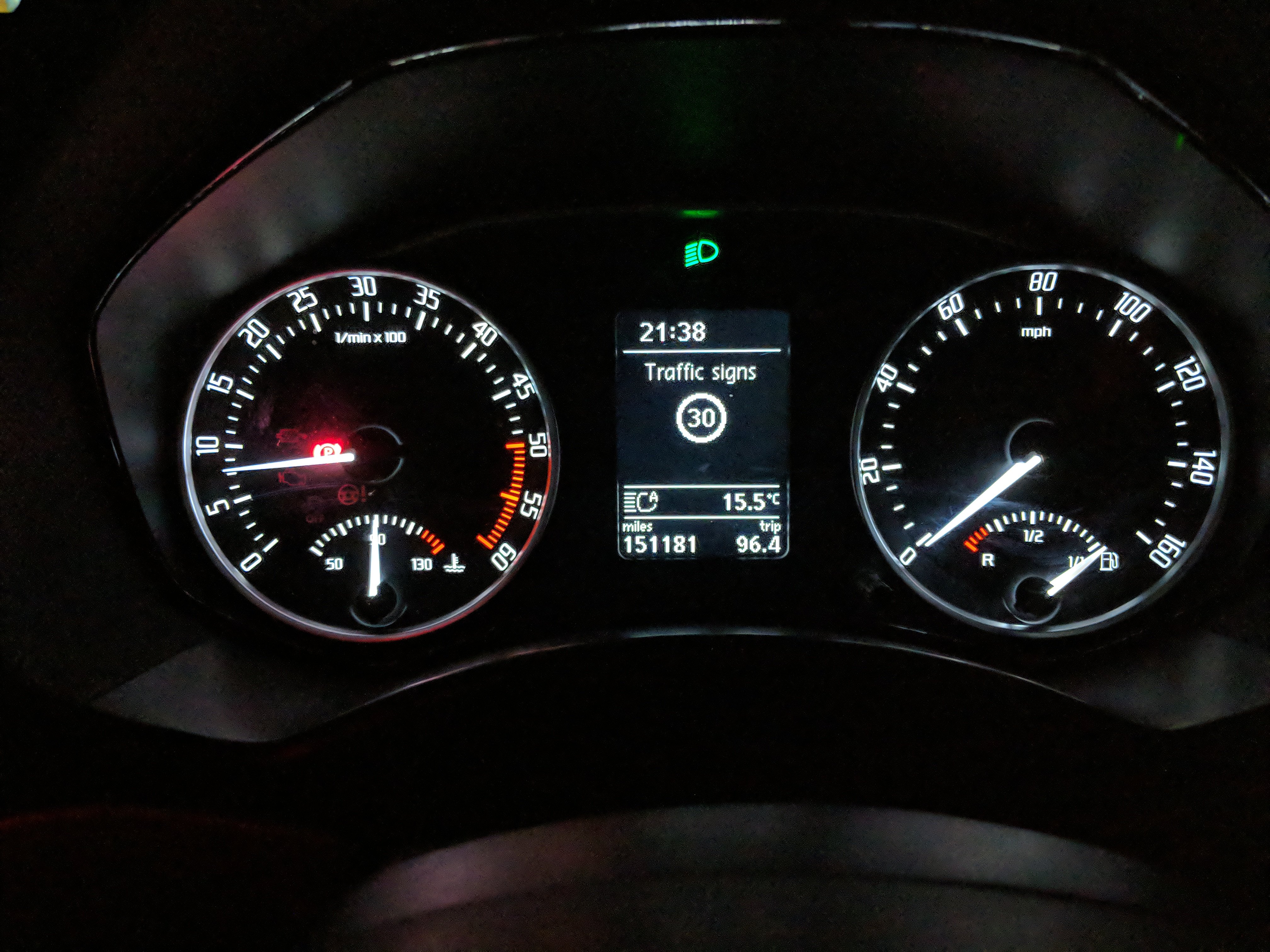

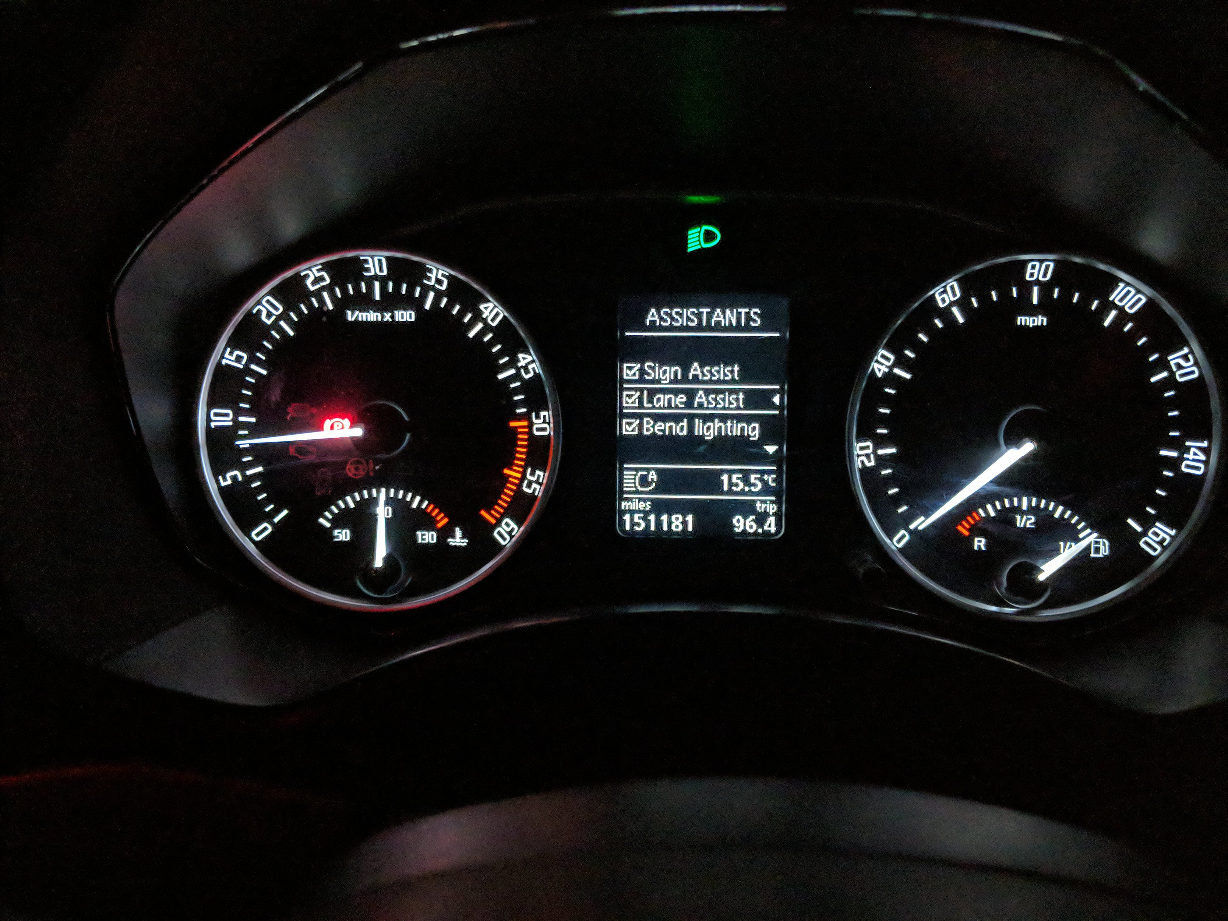

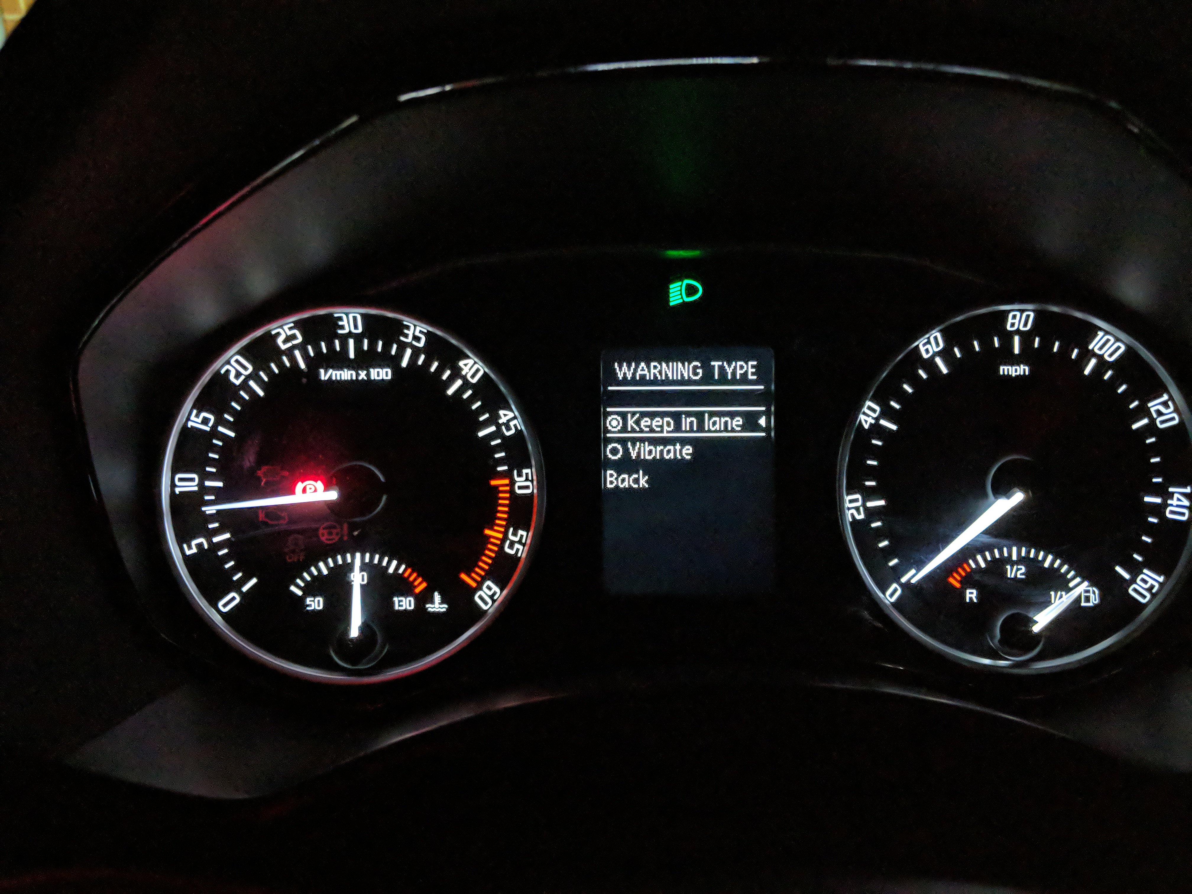

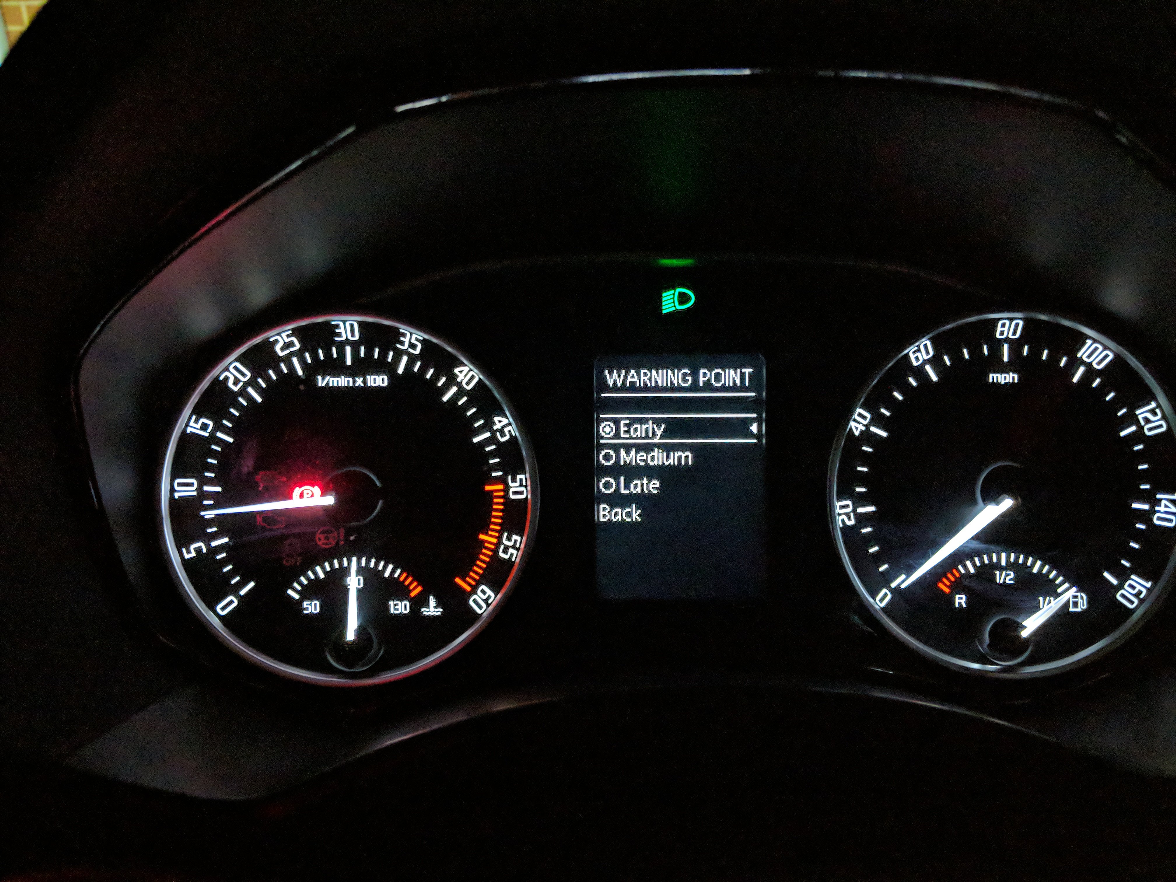

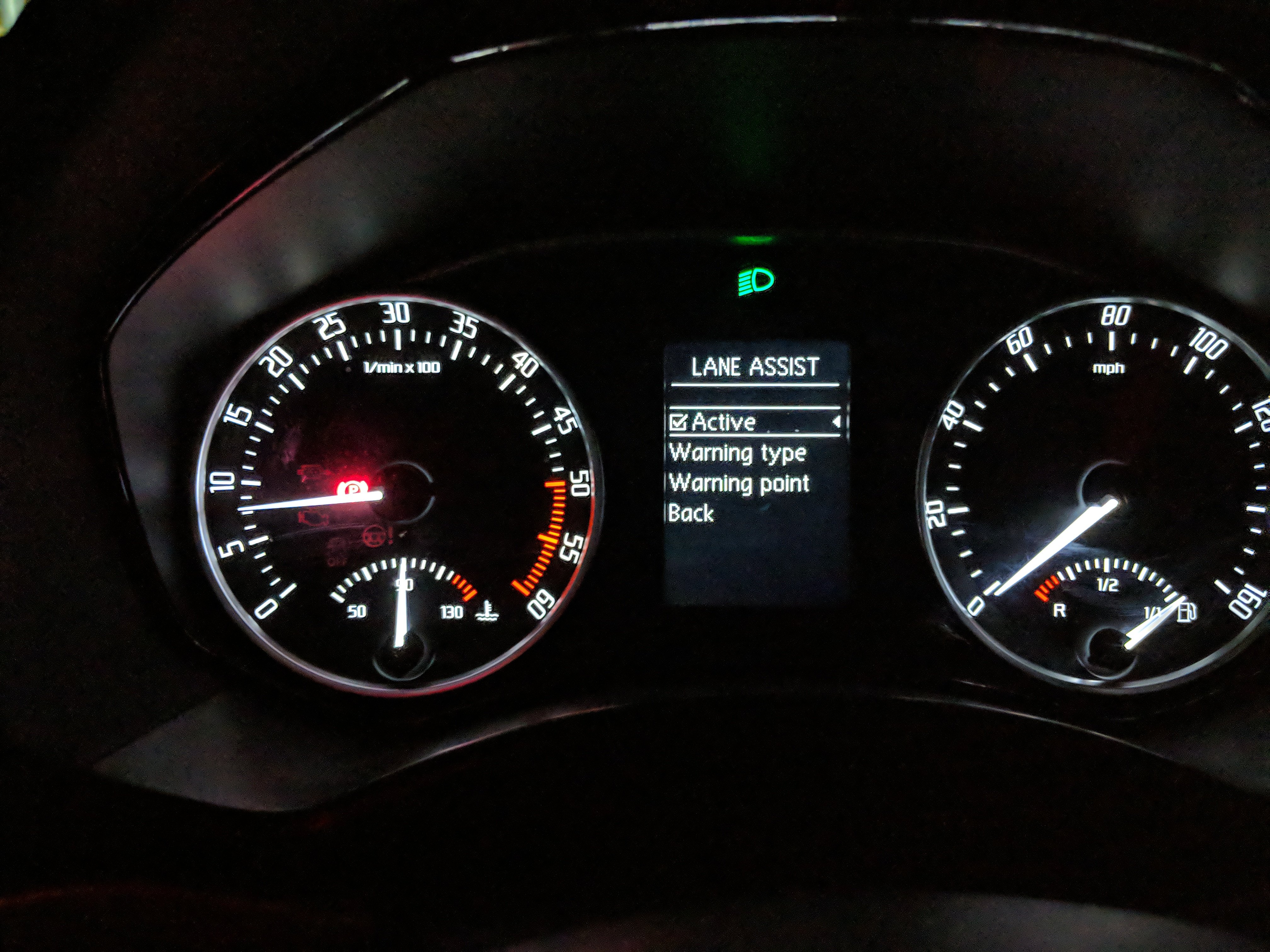

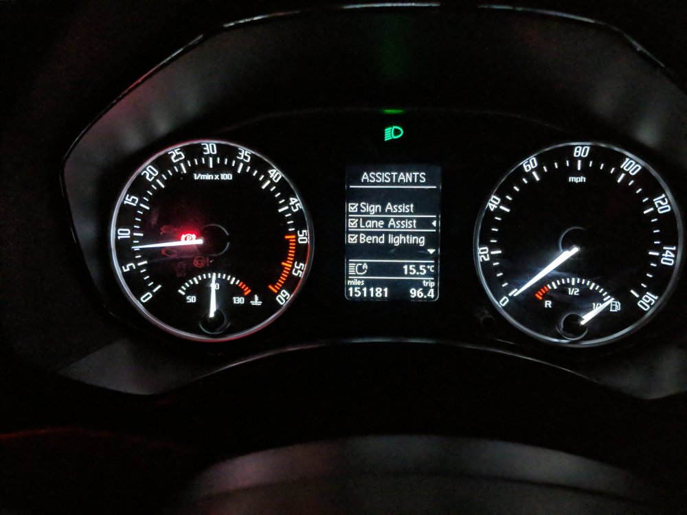

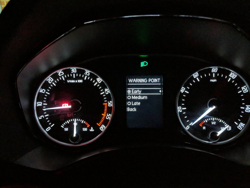

Similar pictures from when I did this a little while back. I've since added the lane assist LED and updated the cluster to show the assistance view.
I don't understand. You actually retrofitted the Skoda assistance systems? How is that possible?
Yes...
Added a camera capable of lane assist/traffic sign assist and high beam assist. Wired it in as per other similar PQ platform cars. Coded the car to use it. Calibrated as per the factory manual. Done!
