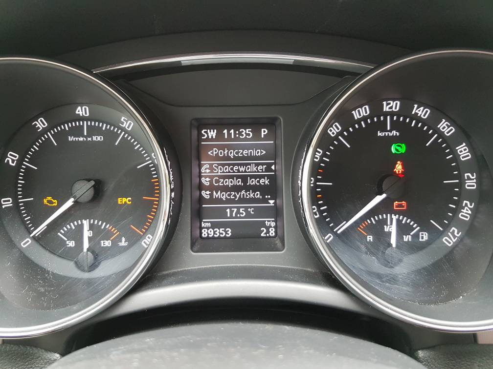

As you probably remember, one of disadvantages of installing MIB STD2 PQ unit in Superb Mk2 were missing icons for missed / outgoing / incoming calls in MaxiDot - instead of them there were suqares. This has been solved - original SUperb Mk2 instruments cluster has been flashed with firmware Yeti. Then some adjustments were made to have meters (speed, fuel, water tempaerture) and indicators (lights etc.) working correctly and here is the result:
