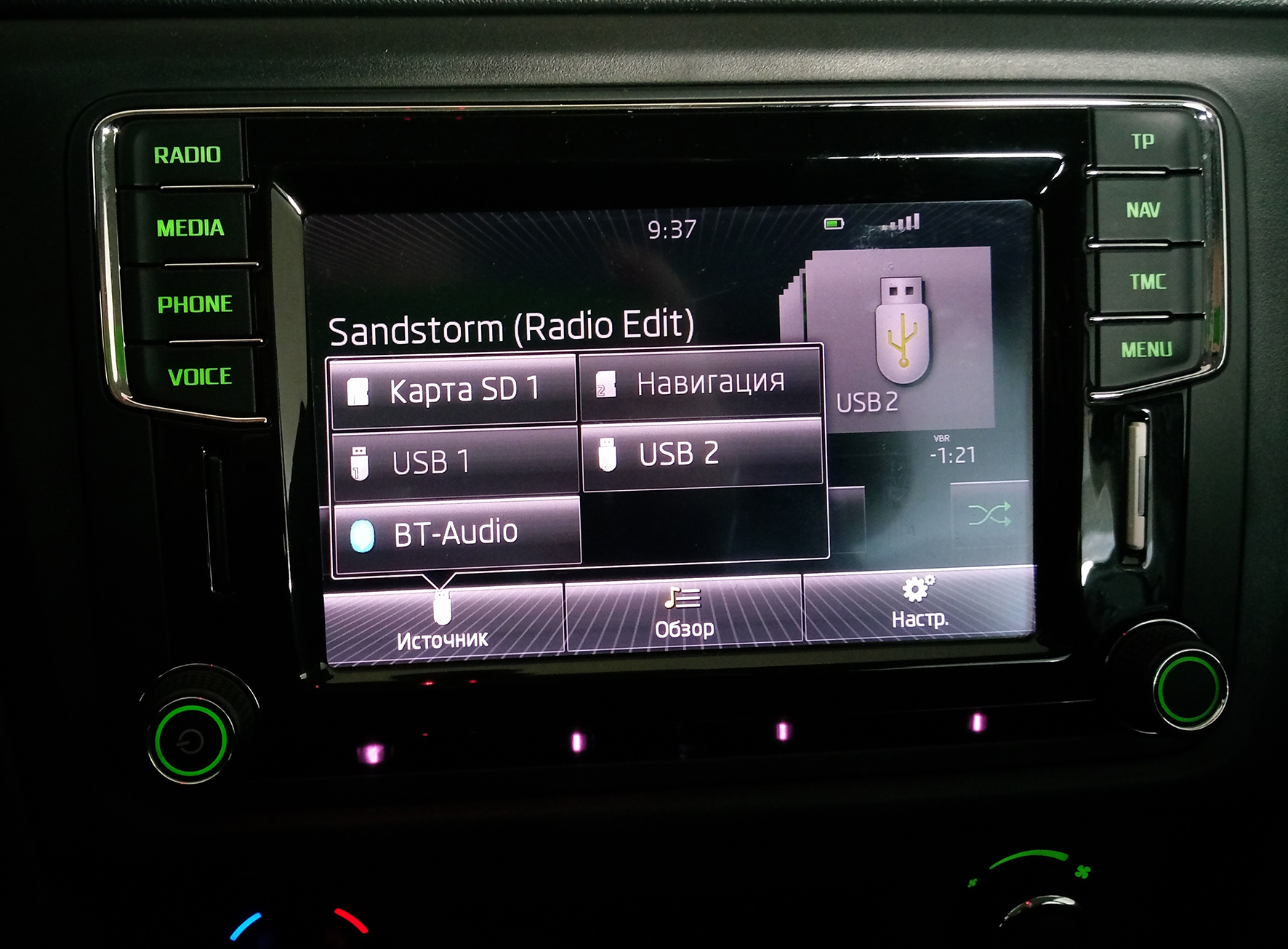

Thank you for the answers. I still have a question, after installing the navigation (MIB) a few hours ago, he showed me the message: Component active protection. I bought another sailing that has not yet displayed the CP Active message, which can make it pair with my car (octavia 2 fl 08-2011)? Thank you
Good night all! There is a question. I bought a wire and AUX and USB. Connected all and activated. However, AUX does not work (it not  was in Media. I connected it as AUX 1). USB was defined as USB2 and works completely correctly when USB1 is present, but it is not active). Tell me please: why there is no AUX and why USB2?
