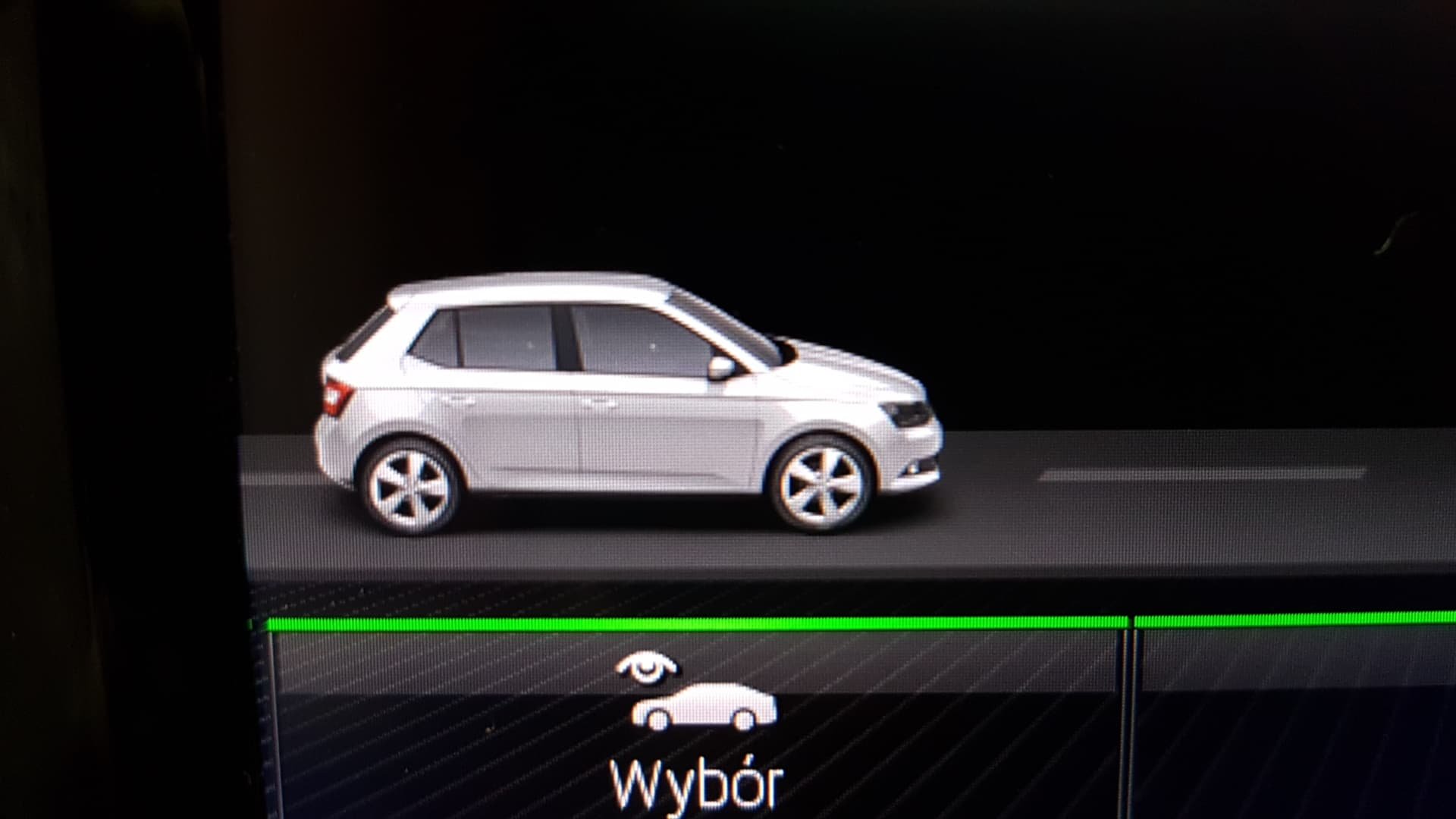

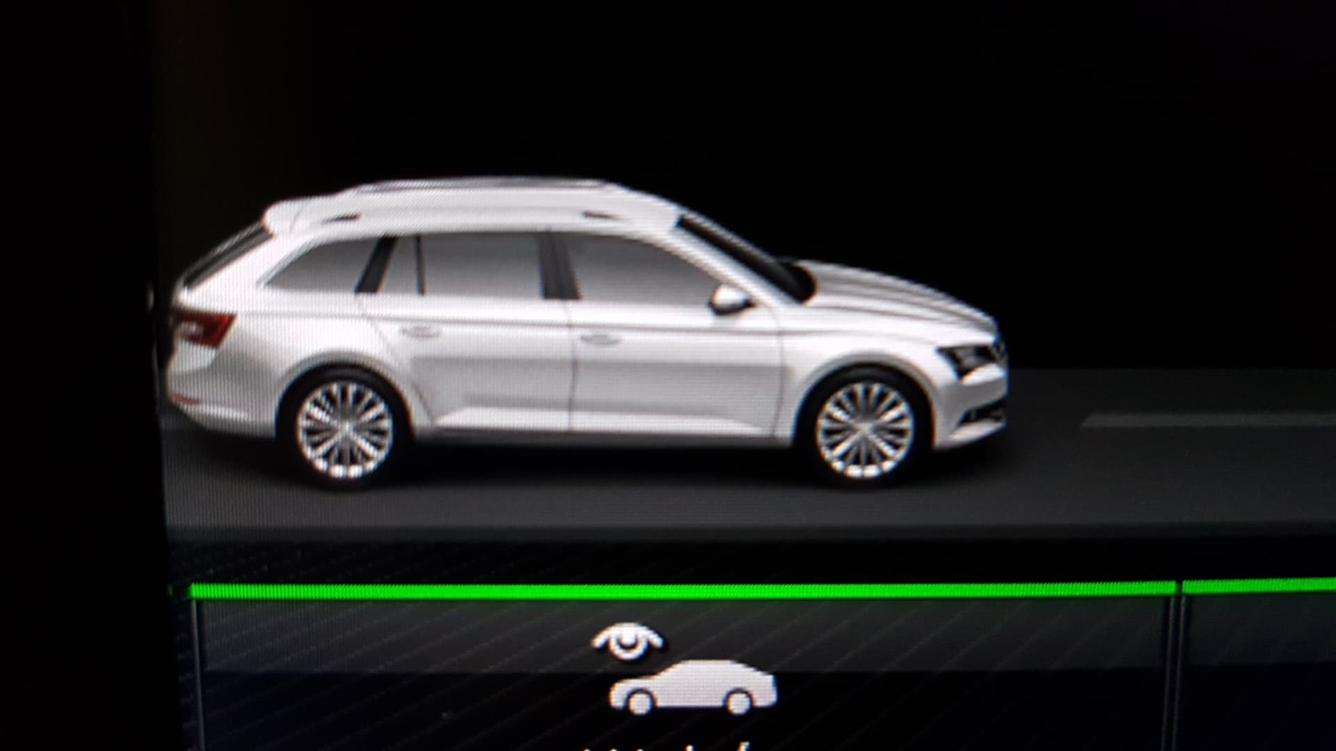

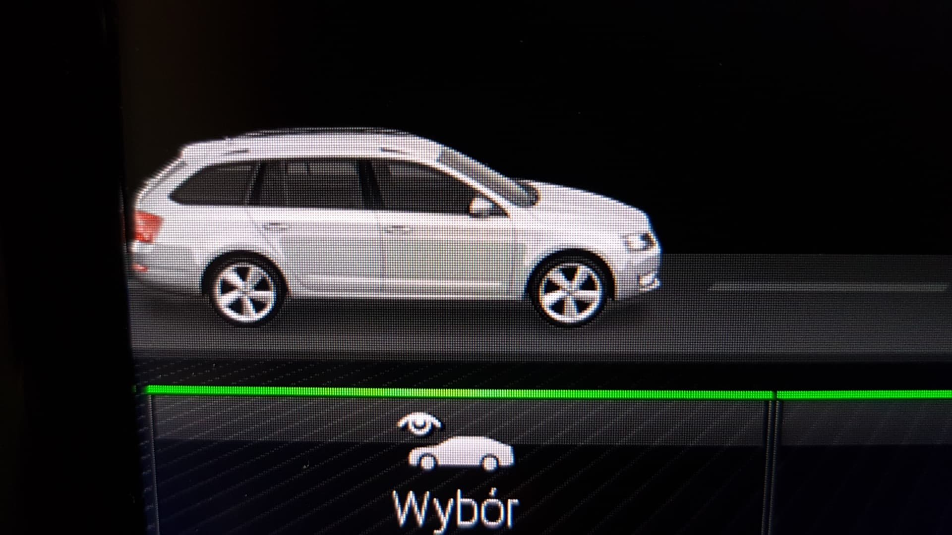

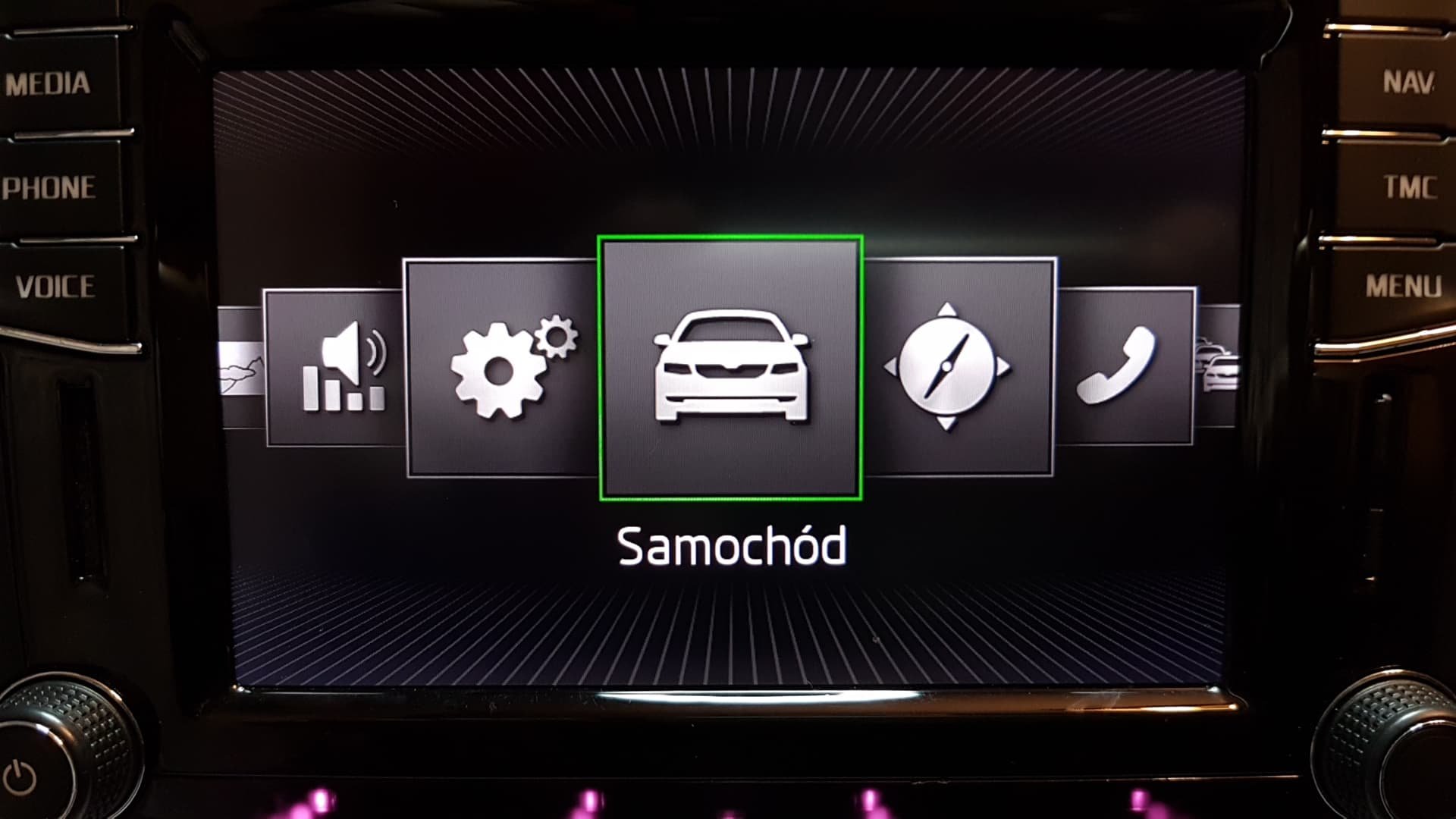

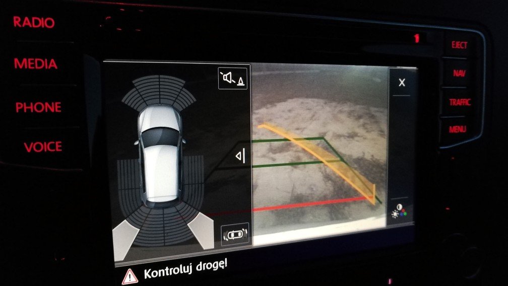

Tired of Yeti picture in OPS? Missing CAR menu known from MQB units? here comes the latest development :)
- menu CAR available in touch screen menu (no need to press VOICE + MENU + NAV anymore)
- menu CAR available in ANY SW version, not just 03xx (MY17 D/E units)
- different cars pictures available (known from MQB units - Fabia III, Octavia III, Superb III) in both CAR menu and OPS

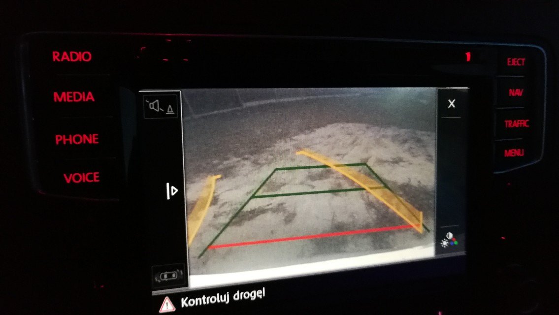

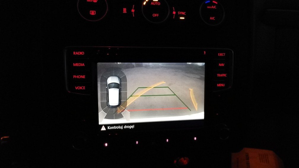

What about calibration? is it required? does lines rally fit the car turning angle?
I'd like to change the car picture from a Yeti to a Octavia III hatch/sedan for OPS. What would I need to do?
Unfortunately this requires hardware rework so you need to send the unit to me :(

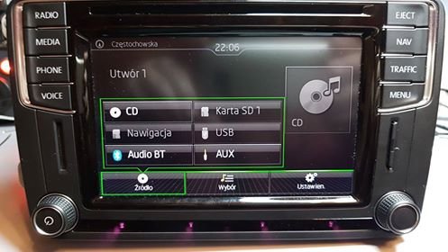

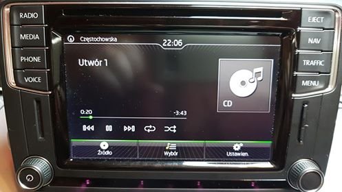

Anyone but me missing CD in SKODA units?
How? External CD or differebt hesdunit bebind the screen?
It'll be a VW headunit with either the leds or front panel replaced plus software tweaks.
Can't remember the last time I used a cd ;-)
I only use the drive to do map updates.
Exactly as @langers2k described: SEAT unit with software tweak (SKODA HMI - Human Machine Interface). But I still have to solve one issue - the only way to exit Phone menu in MaxiDot is to start navigating.
How can i activatedthis? Thanks.
As I have already mentioned - it requires hardware rework so the unit must be delivered to me :(
