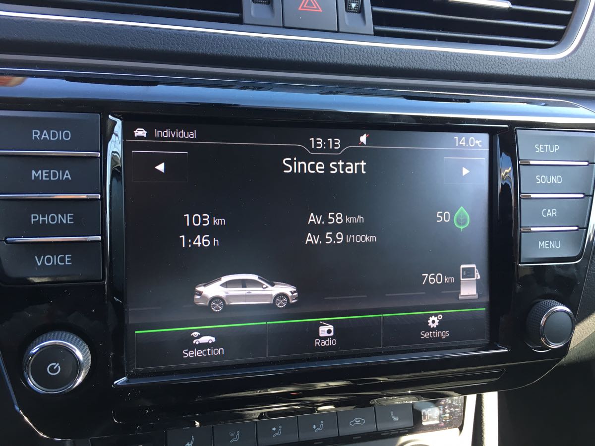

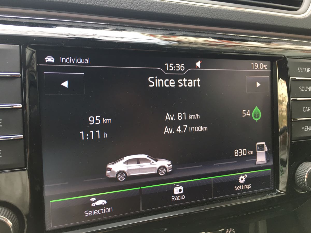

Even though it is a manual i will post here some numbers
