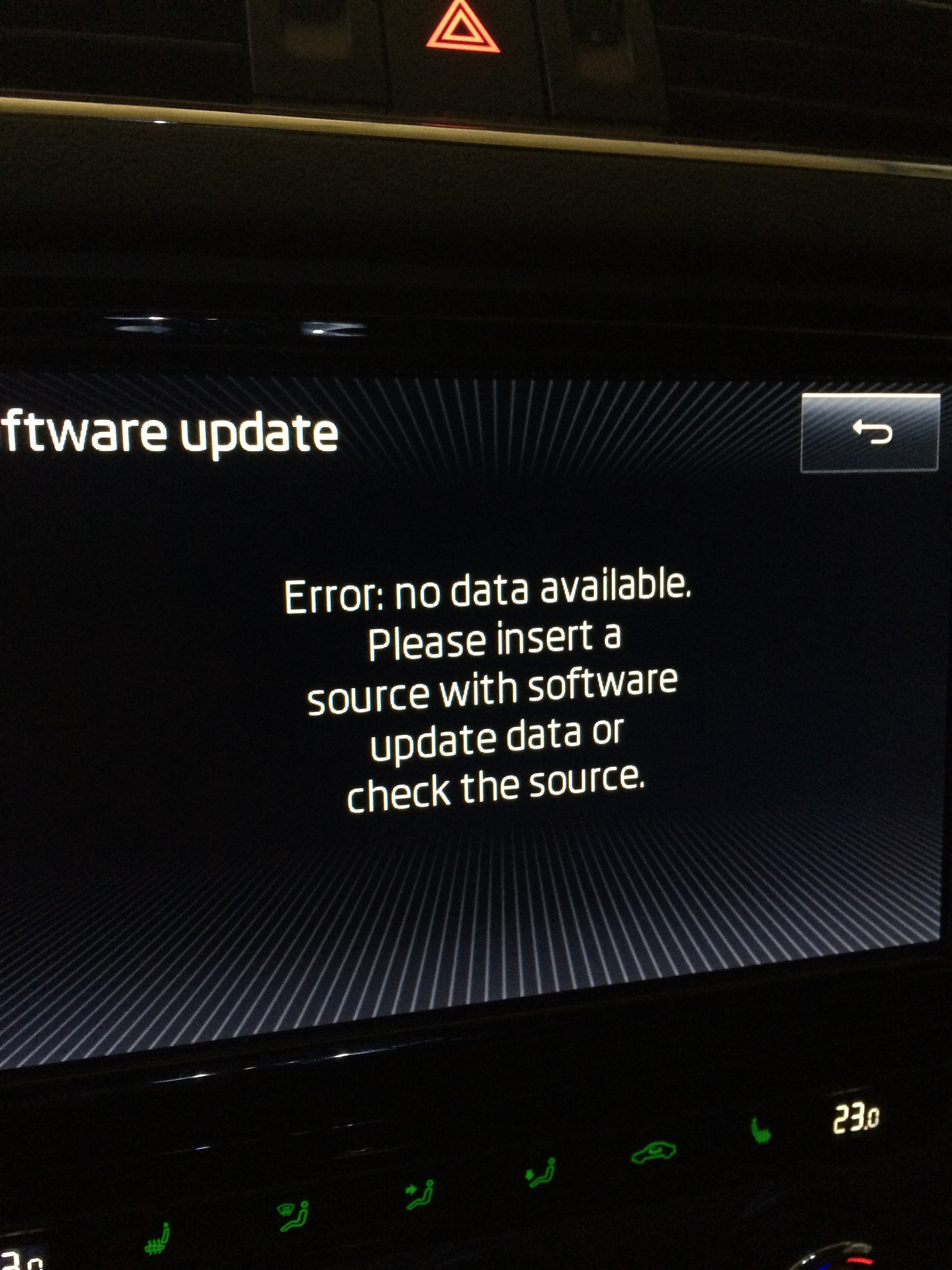

I'm trying to update mine to anything further up the tree than where it currently is, but the unit refuses to see the update either on an SD card, a USB stick or a USB hard drive. Not quite sure what I'm doing wrong, but I've tried just about all options and nothing works. Currently have 0409 on the SD card, with no recognition from the Columbus.
Any ideas?

I just tried to install it, Columbus cant find update data on my SD card, ive got soft ver. 0292

Rustynuts ive solved that problem, to update software you got to update it via service mode (by holding MENU buton for couple of seconds), not form the system info panel (its only for maps).
