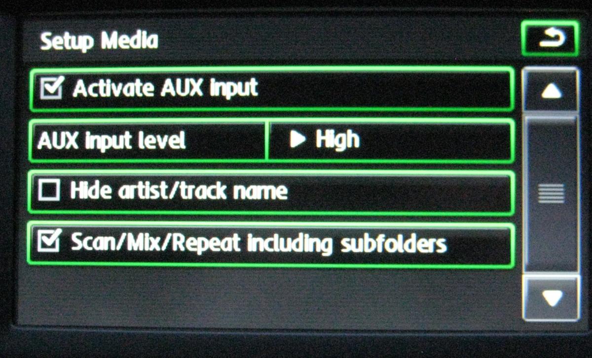

Press the SETUP button on the radio and then select MEDIA on the display
Select ACTIVATE AUX INPUT to put a tick in the box.

After opening the media page on the screen you should this:
Hi pikpilot, thanks a million for that....unfortunately the relevant boxes are missing for me, where I have shown. From further research, looks like it is a VCDS issue..
