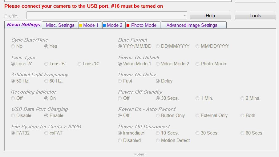

That was indeed an issue a few years ago when I first installed the Mobius. adjusting the 'Power On Delay' from 'Fast' to 'Delay' did help alot.
In the last few months it has taken almost an hour to turn on, which suggested to me it might be battery related.
I also read that it's best to activate the 'Power-off Disconnect' to 'Immediate' instead of the previous '30 Seconds' on installations that are hard wired to the car.
I've literally just fitted my new super capacitor now so will try it on the way to work tomorrow.
Just thought I'd check if there is anything else I need to switch to ensure optimum performance.
No the one I needed to adjust was the power off disconnect as that was causing the problem
The camera would be powered on but not start recording for ages before I changed it from immediate to 10 secs

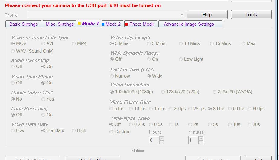

I fitted a super cap 5 week sago when my battery died.
These are my settings when using the battery and now the super cap. I use a 64GB Kingston card.
