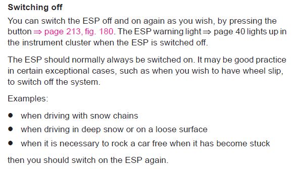

Pretty certain the manual for our 4x4 Octavia says turn the ESP system off in snow...
Sounds strange.
My personal suggestion (take it from a Norwegian who drives on snow for several months each year...) is to leave all assist programs on/default when driving along in normal speeds, even in snow.
Only switch off when you really know what you are doing (i.e. if you want to push the limits, do some fish tailing/drifting/power turns which is great fun when you master it, but difficult and not something you do with the wife and kids in the car on your way to Sunday dinner...) or very special circumstances are present, like that last snow covered hill you want to get up and the ESP/ASR clearly works in a counterproductive way braking the wheel spin and thus braking the car (as in my video above).
I also must stress that summer tyres are crap on snow, and absolutely hopeless on ice - all the three letter abbreviations in the world won't help you if you start sliding on ice with summer tyres :-) (ok, brand new summer tyres can maybe be ok if the rubber is fresh and soft and you drive really careful, but several videos on youtube will show that a 4x4 on summer tyres doesn't stand a chance up a snowy hill against a 2 wheel drive with winter tyres - even studless).
Just found the online manual...
Exactly, only turn it off in special circumstances, and snow aint that. Unless in a 4x4 and looking for a bit of fun ;)
