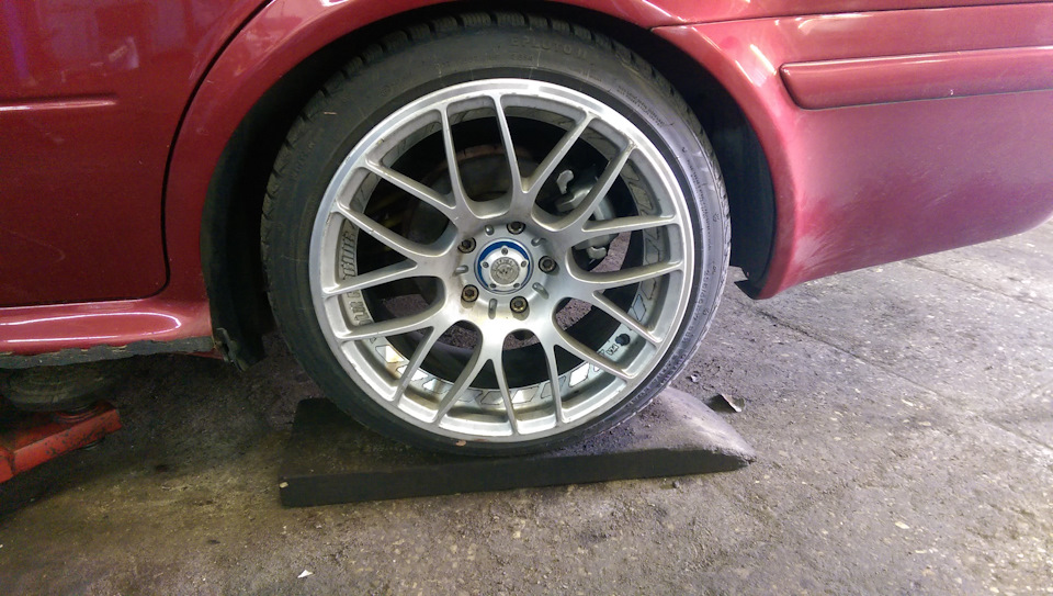

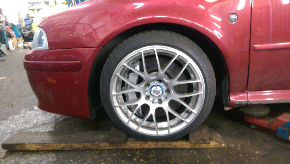

For OZ it's too early to tell because I don't have final dimensions of inners. Futuras are 9 front and 9.5 rear with small offsets so I don't expect any problems with 18''.
LMs have ET35 front and ET38 rear + 16mm adapters. Want to make test fit at this weekend. The biggest problem is 6pot front brakes...
Edited by Jack521
Small update on brake system)
Front
R32 mk4 discs 334x32 + 6 pot Porsche 17z calipers
Rear
256 vented from TT 225hp.
