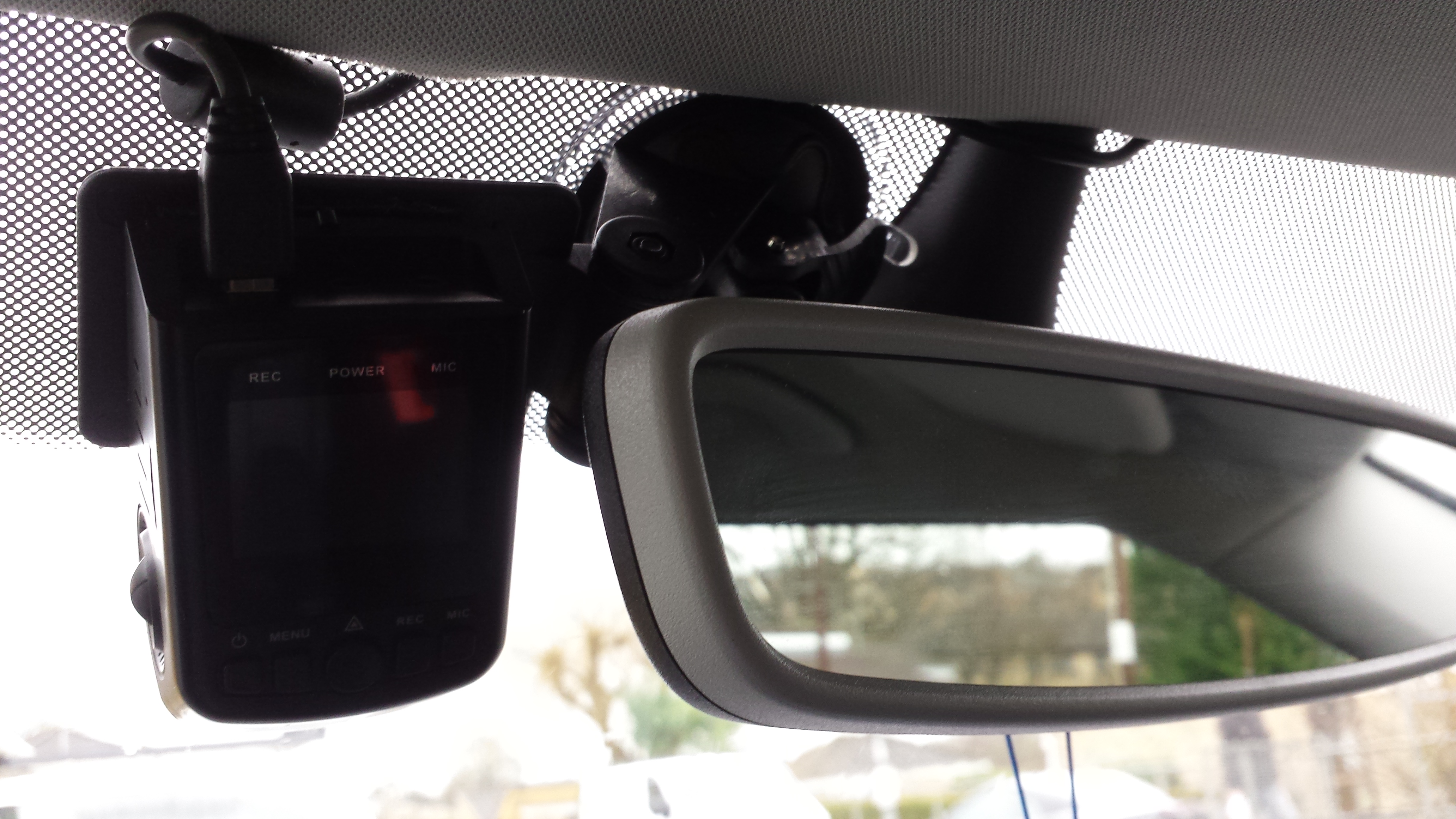

I have been looking for a better place to position my dashcam and hit upon behind the interior mirror on the passengers side (it will be out of sight and reach therefore not a distraction while driving). On closer inspection I see that there is a square mark on the back of the mirror, is this a sensor of some kind? I thought all sensors are in the large plastic section flush with the screen. I don't want to block any sensors with the dashcam and prevent anything else from working properly. Any advice great fully accepted.

This will be the sensor for auto dimming of the mirror so should not be blocked. I've put mine on the drivers side where it is clear. Most cameras can be set so the screen switches off after a minute or so. Once on the move the only thing we see is the little charge indicator.
Another advantage with the drivers side is that that's the side with the fusebox on so you can do a neat install that doesn't need to cross the main mirror mount.
I thought it was the sensor for the auto-wipers

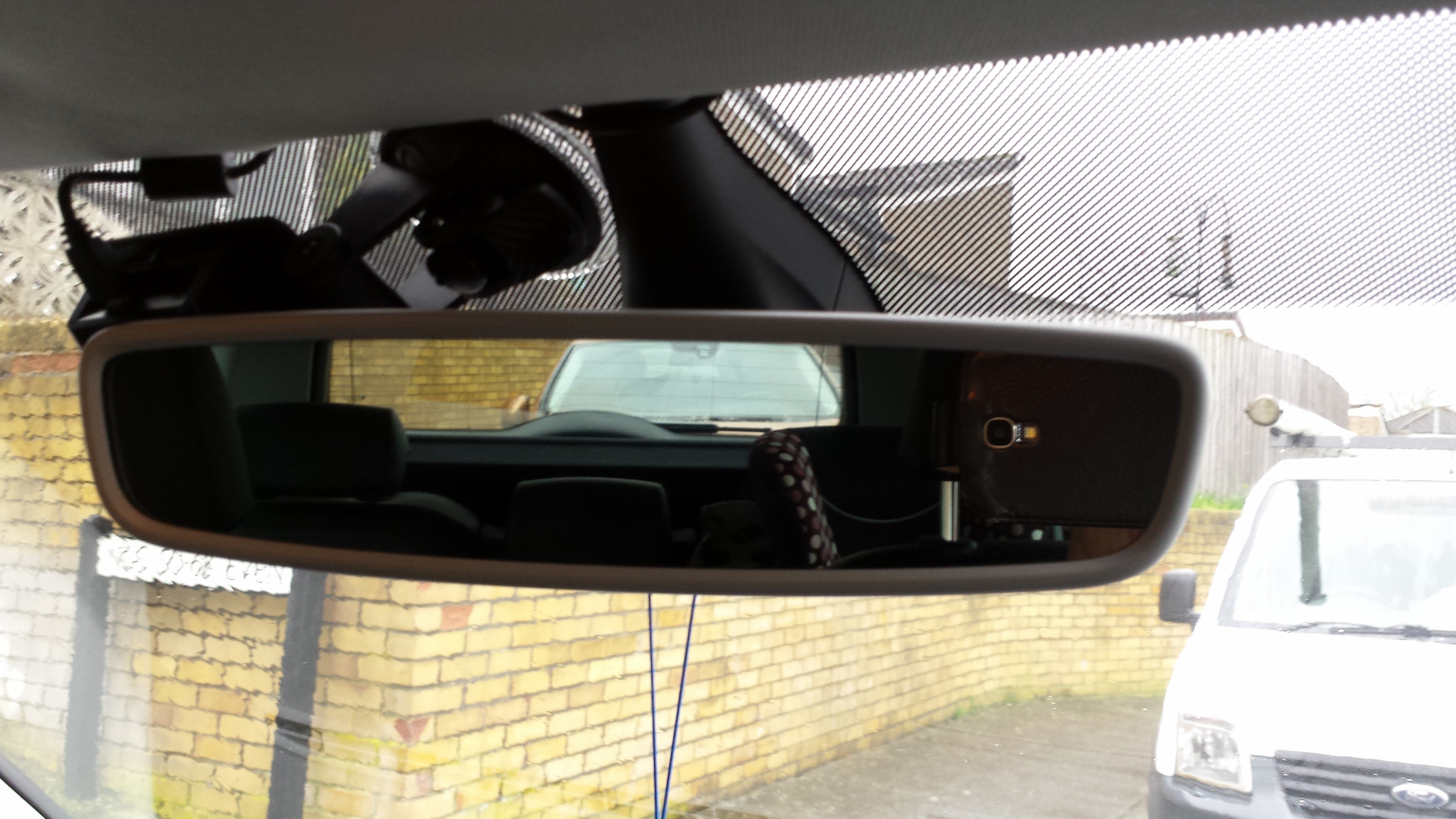

Well, mine is mounted behind the mirror on the passenger side,  and everything works fine.  The dimming sensor is on the front of the mirror, not the back...otherwise it wouldn't pick up the light coming in through the rear window.  I had mine installed by Halfords...all wiring invisible.
Maybe it does both? This from the manual.
Automatic mirror dimming only operates correctly if the light striking the sensor is not affected by other objects. The sensors are located on the front and back of the mirror
Maybe the dimming function works on a comparative method so needs sensors front and back. I fancied fitting on the passenger side as with rhe mirror tilted for use, there is more room on that side. However, the drivers side will be a neater fit and more convenient if needing to press the emergency "Save" function button at any time (although I know that it shouldn't be necessary.

I have my camera tucked up behind the mirror, on the left hand side.
no issues with the mirror dimming.
the headlining has enough movement in it to be able to tuck the camera power cable behind it out of sight.
there is also enough flex in the A pillar cover to tuck the cable behind its from edge all the way down to the fuse box.

Just like Zarniwoop and Cumbrian28, my dashcam* is mounted behind the mirror on the passenger side and I have not noticed any deleterious effects on auto-dimming or auto wipers.

I have mine on passenger side of rear view mirror and no obvious issue with dimming function
I have mine on the passenger side, mounting it as I have it doesn't interfere with the mirror sensor
As far as I know the mirror needs two sensors for auto dimming. If you stick your finger over the one pointing forward (during daylight) you can make the mirror dim. Shine a torch on the other sensor and it will dim even more.

I have just mounted a BlackVue DR380G-HD behind the rear view mirror on the passenger side, and no issues with dimming function.
