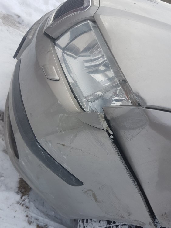

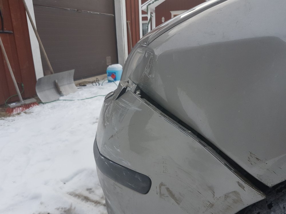

I had my 16-year old daughter for some practice driving. As she turned 16 today it was a premiere tour. She did splendid, but when she tried to park the car... Well I had been on the edge all the time but now probably feeling a bit on the safe side. So when she forgot to hit the brakes, I was a bit slow with the handbrake and well... Bumper, Headlight, Wing and Bonnet was dented by a light post. Even the windshield washer fluid container (is it called that in English?) got rupted or tored.
  • The wing replacing seems to be, well not easy but doable. http://www.mediafire.com/file/dwyz09tvplj/elemente_caroserie.pdf section 50-2 seems to cover it all, exept from how to make the glue or what ever is fixing it to the body. And what to use to "glue" it back when replaced. A used one is mine for roughly £80
  • The Bumper... I guess I won't teplace it, just glue back that little chip and maby cover it with some paint.
  • The headlight... there were some plastic mounting parts that got damaged. Both on the headlight it self and in the housing. I guess I'll have to replace the lot, but I cant find a guide. A used one is mine for roughly £80
  • The Bonnet... Some pliers and paint and it'll have to do, getting a new one isn't an option.
  • The washer fluid container... I've found no instructions what so ever on the net. But a used one is mine for roughly £15
If you have any good tips or links it would be super if you could share them with me.
Thanks in advance
Don't know what availability of parts are in sweden but here in the uk you can just go down to a breakers and probably find most of the parts on the cheap
I know a Headlight can be had for about £20, a wing £30, Bonnet £30-40, Bumper £50-60, washer bottle £10
Bumper is an easy job just unbolts from the inner wheel arches at the front with 4x t25 screws, then 2x t35?? on the front just below the grille, remove the undertray (again t25 i think) Then its just a case of pulling it out from the clips on the wing and it should be off.
Headlight is very easy once front bumper is off - one torx at the back, two t25 on the top holding it to the slam panel, and a 10mm bolt on the front. You will need to get the beams aligned by a garage tho after its fitted to comply with whatever laws you have.
Washer fluid container should be an easy job with the front bumper off should be quite self explanatory i would have thought by just looking at it.
Never done a front wing, heard they are a bit tricky but theres the bolts along the top edge and the bolts on the inside of the wheel arch. I think theres some sort of sealant at the bottom part where it joins to the sill, which can be cut.
Bonnet is just the 4 bolts holding it to the hinges, as you say you can just straighten for the time being until you find one the right colour
Overall not too bad to do with some DIY experience.
I wouldn't bother repairing the front bumper as it would cost more to get it looking right than a replacement from a scrap yard.

The bumper could be repaired plastic welded from behind and then just polished up from the front until it looks presentable.
There are clips which mount the edge of the bumper into the wing, in the picture it has popped out from the clips i expect some of them are broken but that part should come with a replacement wing.

Washer fluid container is easy to remove, however to get it out you need to remove the bumper and the battery. It's just held in with a couple of bolts, and the water connections are just push-fit.
If you're taking the bumper off anyway, then you cold attempt a DIY patch of that crack by doing some at-home plastic welding using a soldering iron on the back side. The video below shows how it's done, but please do this outdoors unlike the guy in the video, the fumes are bad for you! It should make the split much less obvious if done carefully and will stop the crack from growing.
