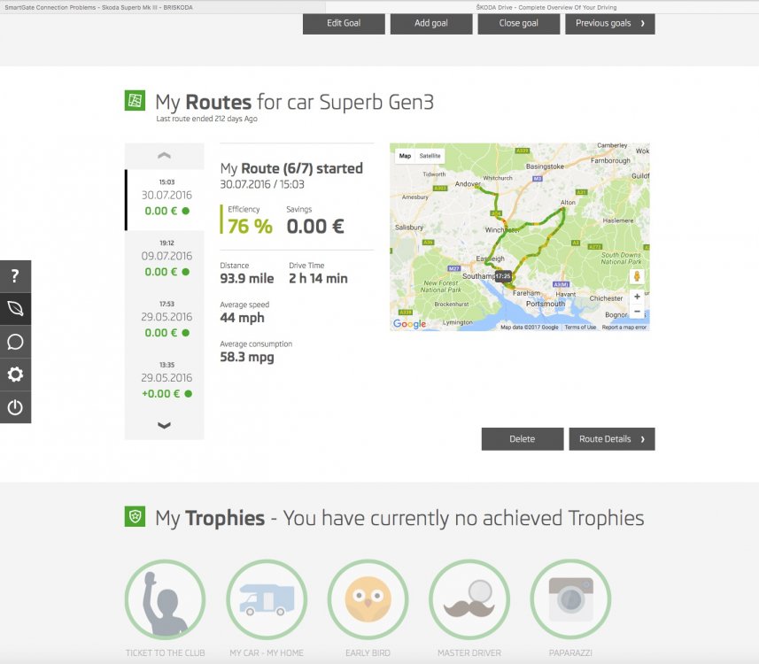

Update.
I have managed to get the system to connect but it is not consistent, some times it works and sometimes it does not. So far I cannot find a pattern. I have also determined that SmartGate will NOT work when I connect my iPhone to the USB port to use SmartLink connectivity. This is critical as the battery drain is significant with the WIFI data transfer - 100% to 30% in under 90 minutes.
