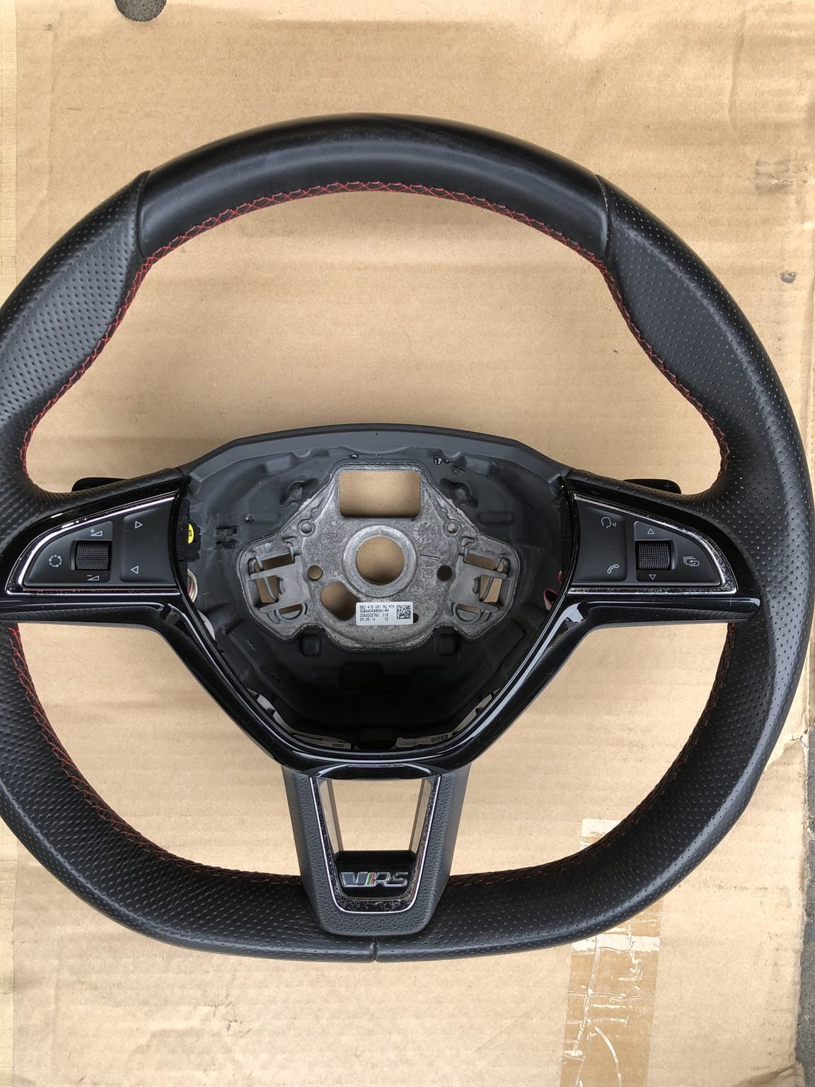

Does anyone know if a 2013 Octavia RS MFSW with paddle shift is plug and play with a 2014/5 facelift Superb V6 (currently without paddle shift)? From what I can tell the airbags are identical even though the OctVRS is a 3 spoke and the Superb is a 4 spoke. Reading through this thread it seems like it should work but just seeing if anyone has done it this way. I can get a 3 spoke wheel from the wreckers like the image attached. Thanks
