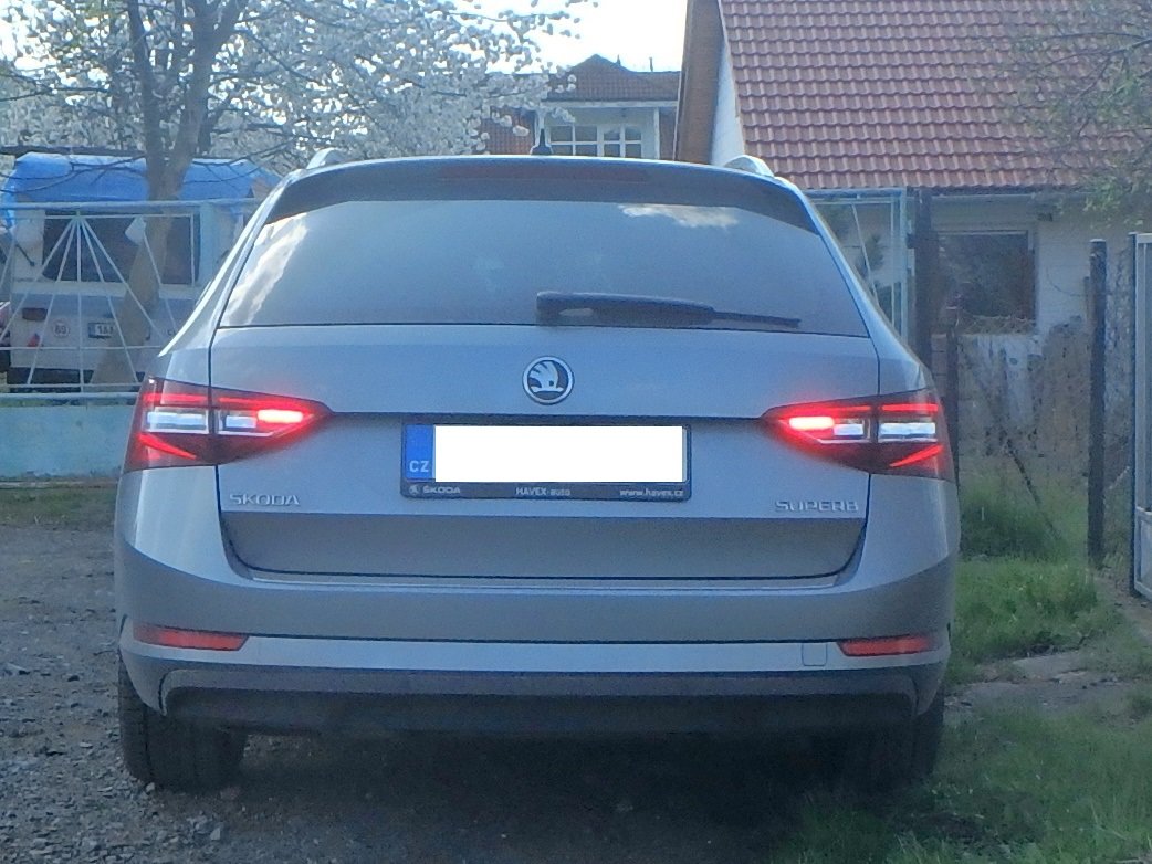

Hallo, please, can you find the part number for UK Led rear lamp for the right side with fog and tail light? (highest variant light) Best by a UK VIN. For Superb Combi III Style 2.0 TDI 110 kW, manufactured in 01/2016. Thanks.

I've solved it. I bought the UK version of the right light.

Yes, I had to add a new wire. It was possible to stretch the wire between the lights, it was not necessary to disassemble the rear bonnet cover.
