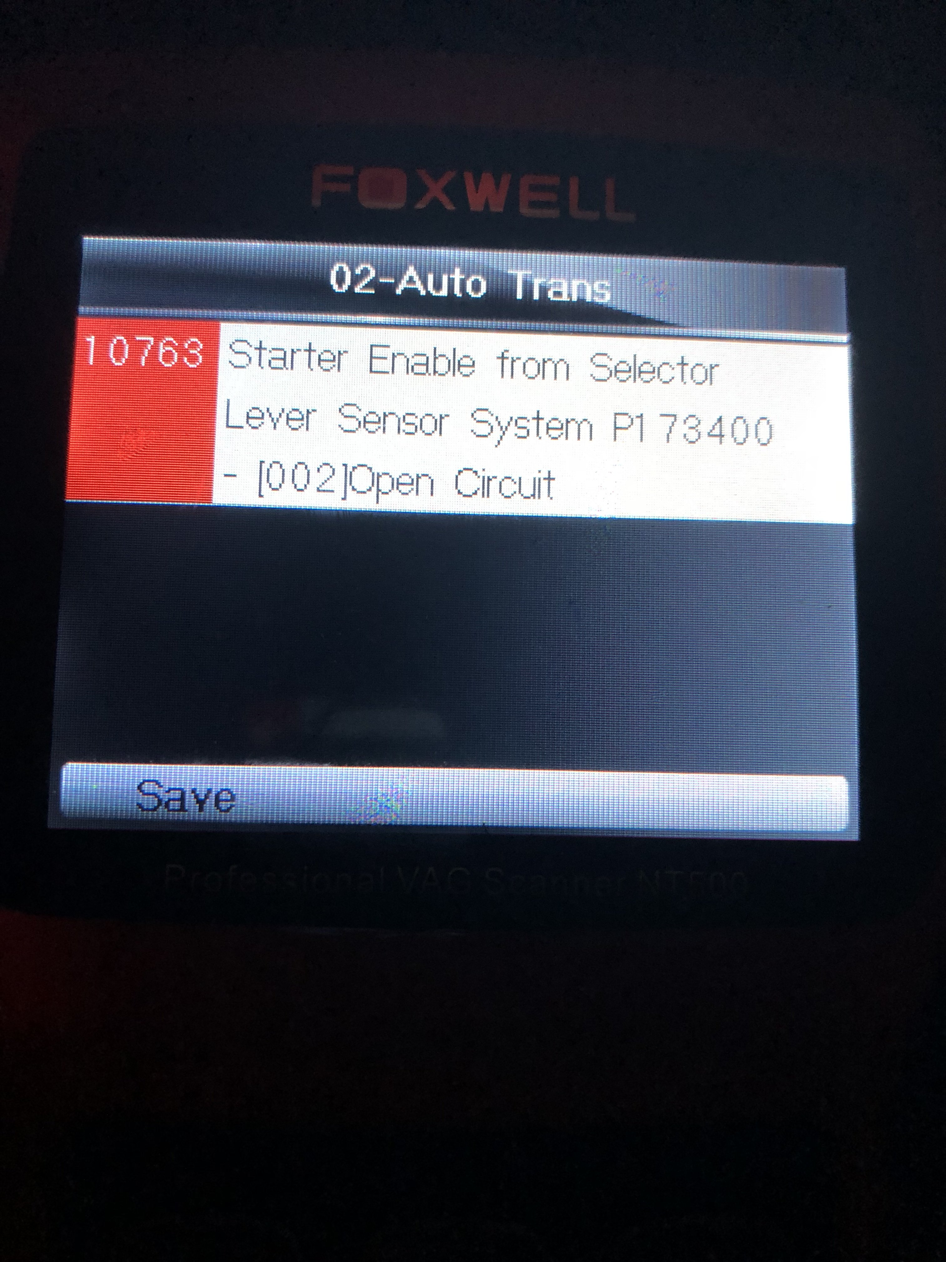

Getting this error as well. After clearing its come to this below error. Strange it just popped up open. Car is about 1 year old. Happen to catch this on a normal full car scan. Don’t think this has anything to do with an audio install which uses a in line audio adaptor to the stock HU for DSP.
It's the selector lever. I had the same issue. Had it replaced and the car has been troublefree ever since.
Hi,
The error is not showing anymore.. What exactly did you replace? Maybe this was a freak error.. Will have to keep a tab on it.. Even when the car was serviced at the Skoda workshop, there was 0 errors on this.
15 hours ago, z klasse said:
Hi,
The error will flash and go away but will show in the log. So if all you hear is a beep, you can be sure it's the lever.
Let’s hope it stays away. I still have 3 years warranty left so no issues there.
  • 6 months later...
I had this problem, with the error message coming up intermittently.  I spoke to the dealership and booked it in, but the service manager said that if they couldn't identify the fault, they couldn't help.  Next time it came up, I stopped and took photographs of the error message.  Although the fault cleared, and wasn't showing when they tested the car, they accepted the photographs, and replaced the selector unit under warranty.
