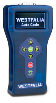

It's not a Bosal tool but a handheld Westfalia coder he had:
Oh and it's definitely not a bypass relay fitted but dedicated / integrated wiring.
Yes, that's the sort of tool I'm on about. so it has westfalia electronics and westfalia make the original skoda control units for towing and use the same programming.
The tool looks like the old Sykes picavant ARC4
Yes all Westfalia electronics,  so virtually original Skoda !
