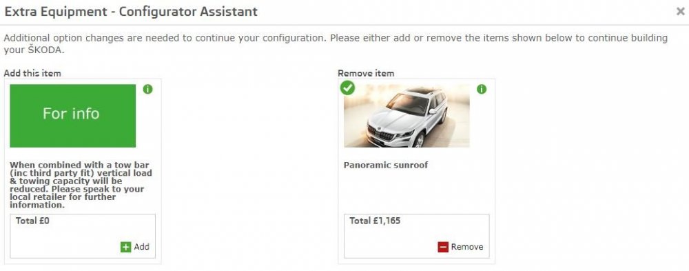

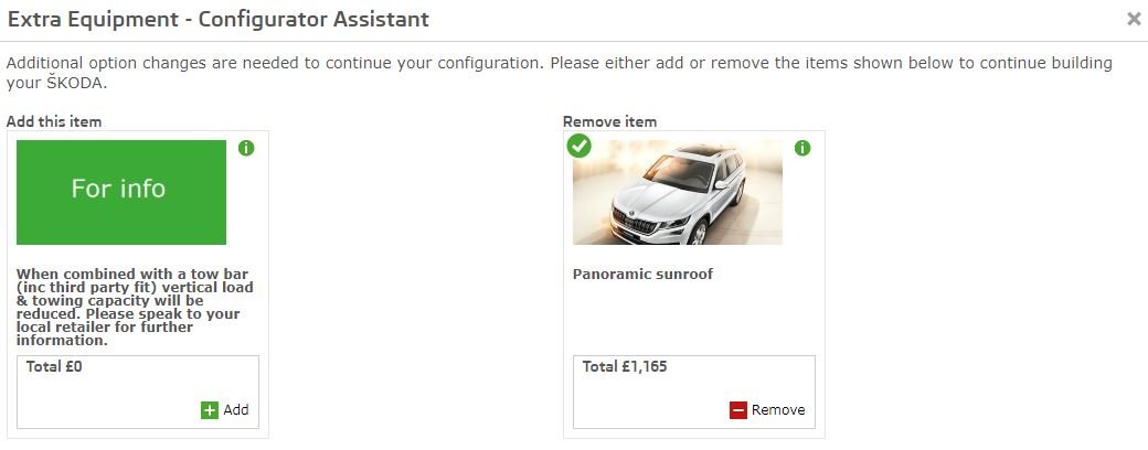

Just configured a 2.0 TDI 190PS DSG 7-seat SportLine and tried adding the panoramic sunroof...
Does the sunroof reduce the structural integrity that could be exposed when towing heavy loads?
Could be a weight or stability issue, in just the wrong place.
