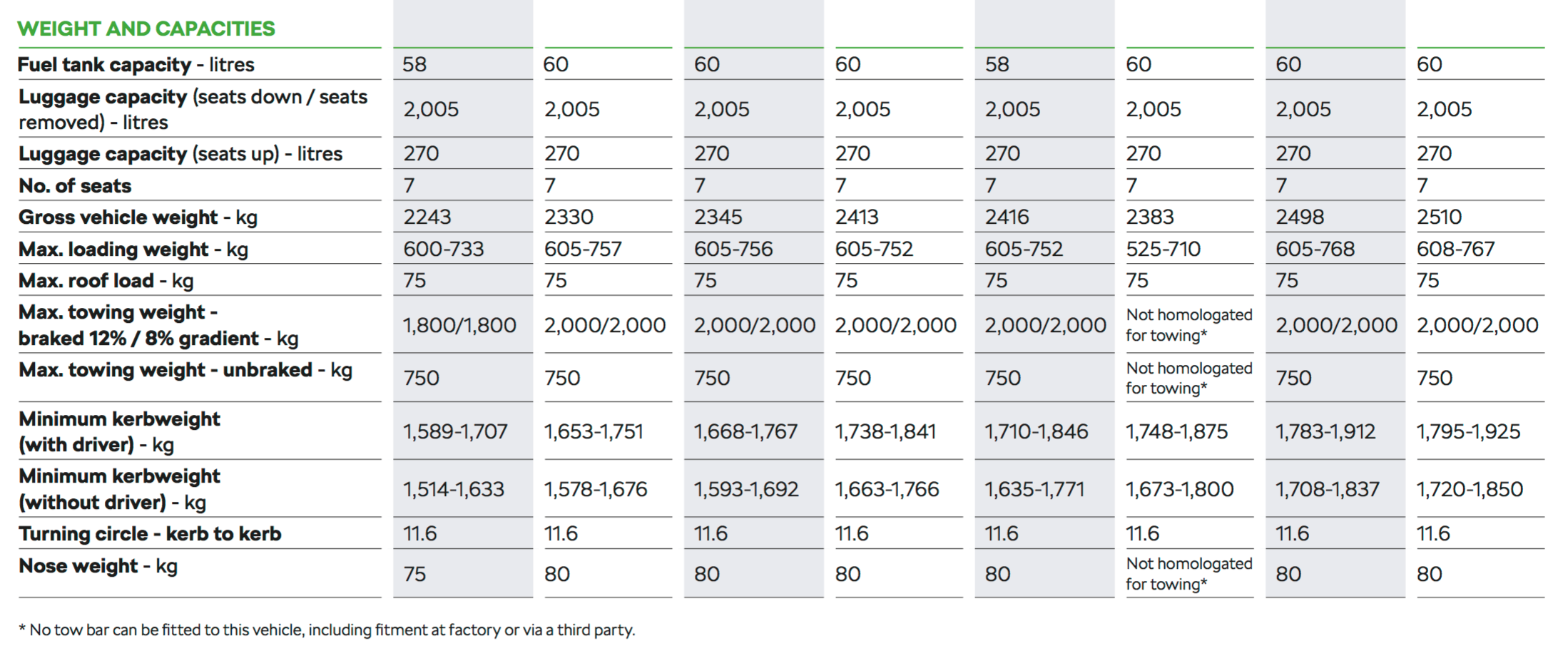

It seems that SUK have listened and in the newly published June 17 Price list and Specifications have now made it clear that certain variants are not homologated for towing and can never tow. Well done Skoda UK !
It'd still be interesting to know exactly why.
There certainly appears to be nothing obvious in the various specs to suggest any reason for it.
Well the spec if you look at the Max Loading Weight & the Minimum Kerb weight pretty well shows that if they had Homologated it for towing the weight would have been very low, lower than the 1.4TSI.
Good for only unbraked light trailers & pretty light braked trailer towing.
Likely to cause more issues if a towbar was fitted and then owners towed over weight than just not being able to fit a towbar to tow.
(i am pretty sure some will anyway even if just for a Bike Rack, then some might end up using that to tow if on the vehicle.
Crazy EU grey areas are not homologated for a Towbar, but Bike Racks with towballs not mentioned.)
Transposing the figures available in the left-hand column, I wouldn't call 1800 Kg (braked) all that useless for the manual 7 seater - in my towing experience, including regularly towing an unbraked 4 meter ski-boat with a BMC Mini, you don't really require a lot of nose-weight for stability - especially if you use a stabiliser bar and the trailer is properly set up.
1,800kg would have been OK for some if that was what it was given, less than that a bit of an embarrassment maybe.

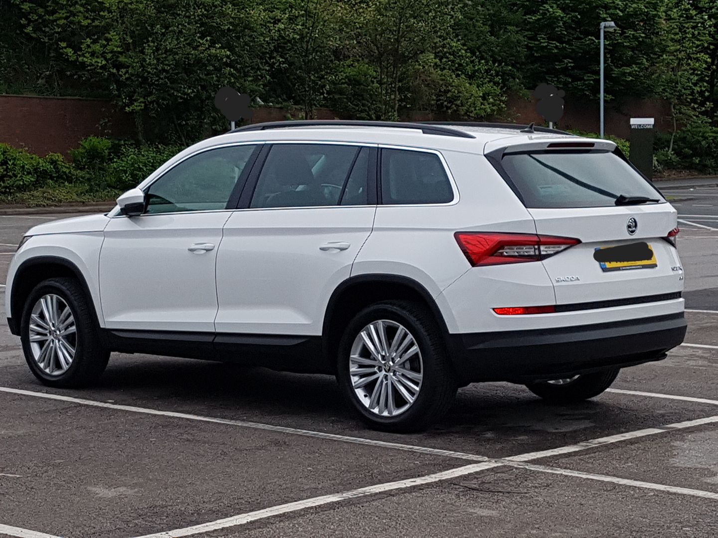

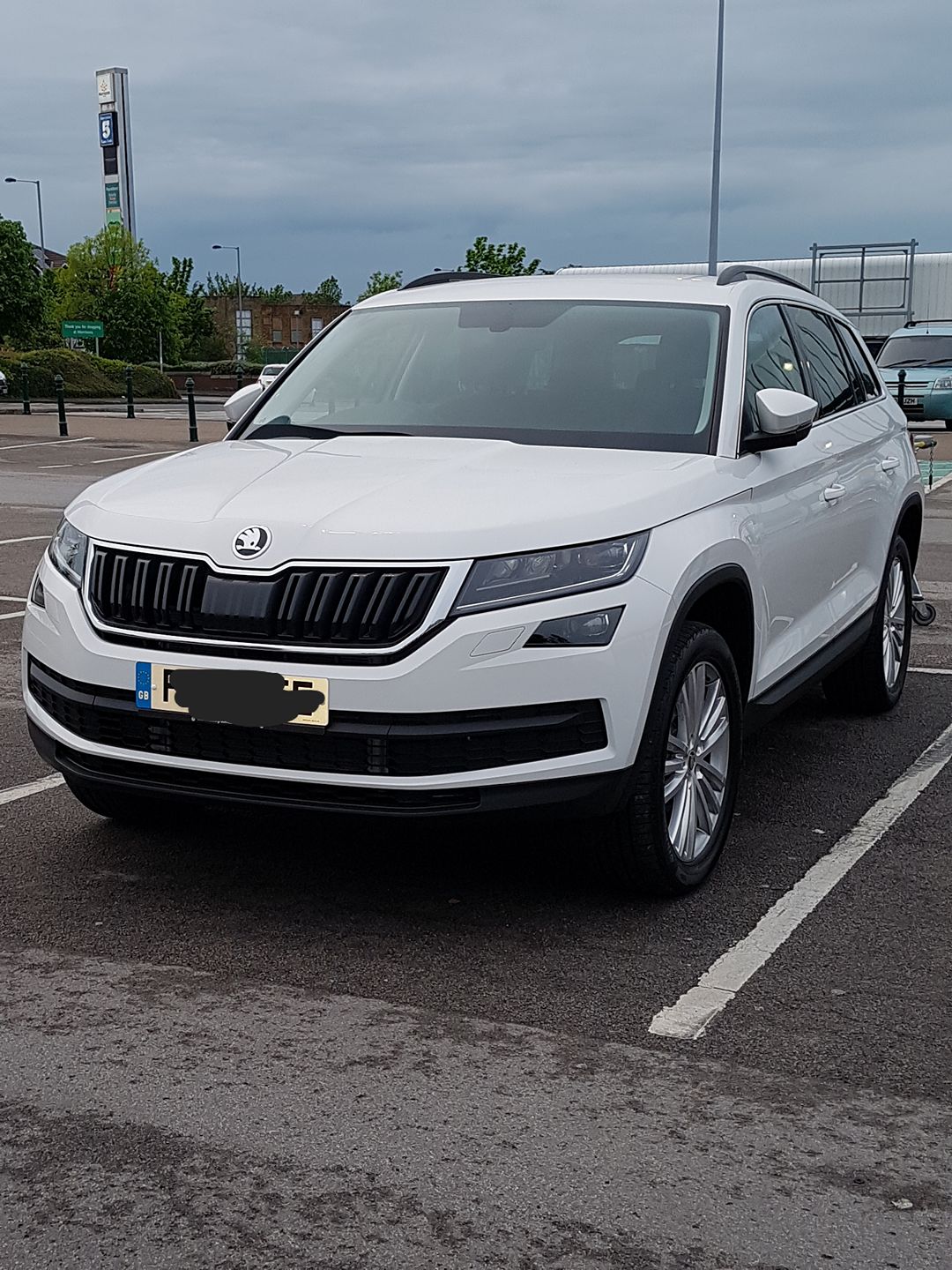

I have just taken delivery of my SE L 150tdi 4x4 DSG with towbar and was disappointed that I couldn't have the towbar with a manual box however I have had a dsg on an Audi A3 before and didn't mind it. This one is far superior. It slips into neutral when not under load and then reinstates gear when the brake or accelerator is pressed knowing that you need control back. It also senses when you need engine braking (presumably from angle sensors which control hill descent control feature) as it puts it back into gear then too.
Not towed yet but going to the caravan this weekend so will hook it up to test electrics and that it fits my Alko hitch ok.
I must confess to skipping a couple of pages of this thread but the people that are talking about a 2100 (or is it 2500) kg towing capability of their Yeti's obviously don't look at weight ratios as a lot of cars will tow quite a heavy load but to do it safely you shouldn't really be exceeding the vehicular weight with the towed load. I can't imagine a Yeti weighs anywhere near 2100kgs.  Surprised I haven't seen a few more Yetis in ditches with caravans and speedboats attached (or not)!
NB: Loving the Kodiaq a week in. It's great. :-)

Welcome to the forum!
Hope you enjoy your new car and learn how to tow within its limits. I'd recommend being very careful about throwing stones - your car maybe larger than a Yeti, but Skoda deem it a less capable tow car (2100kg Yeti versus 2000kg Kodiaq) unless you've unfortunately bought the 150bhp weedy engined 5 seat version which looks best to avoid.
Obviously if you have experience, of towing or this forum, you'll not need helpful well intentioned advice.
Enjoy!
