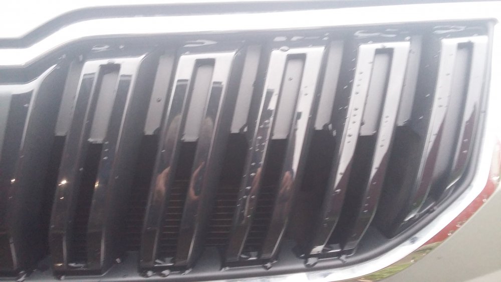

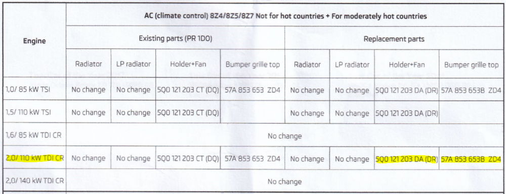

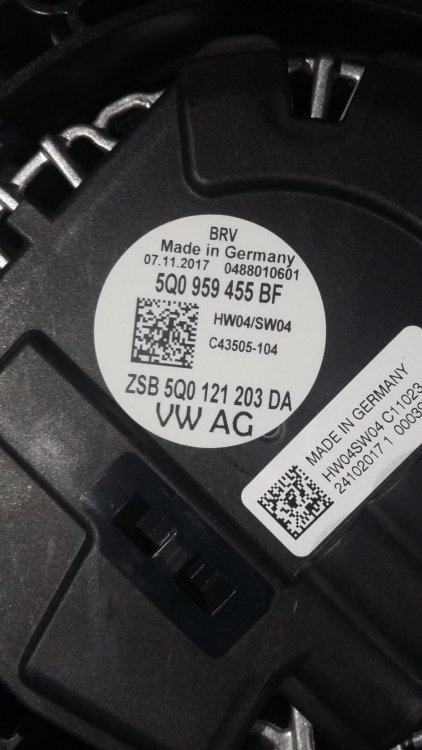

The actual physical changes that Skoda make to the car when either the factory fitted tow bar, or the tow bar preparation option is specified are detailed here...
Bigger openings in the radiator grill...
And a more powerful fan...
Staggering!

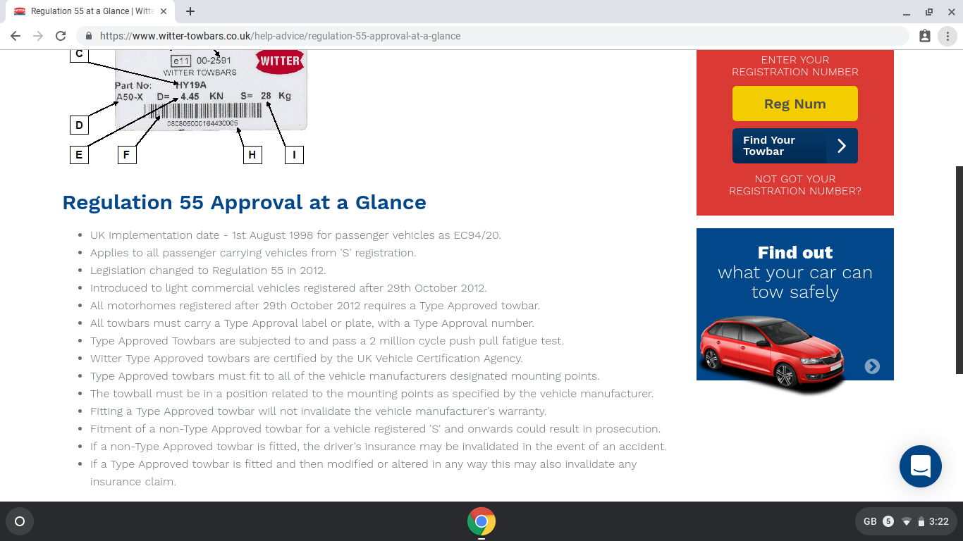

Not EU type approved
Since 1998 all UK towbars now fitted & sold have to be EU type approved, and fit onto the same manufacturer's mounting points. So I'm confused...the issue as far as I understand it, and certainly as far as my own issue is concerned, is that the standard car (without any towbar prep) is not fully ready to accept a towbar (whether Skoda's own brand  or not) without significant additional modifications. Therefore, it doesn't conform to what is suggested in the standard brochure, as it won't tow the weights (or tow at all in some cases) without extra fans, grills, etc which rubbishes the data, and is misleading.
This is unusual, especially since many SUV's (and more still of the larger ones such as the Kodiaq) will be used for towing. Certainly mine is.
If this argument is taken to its extreme, in theory you could claim in the brochure the car could be used for space travel (but only if encapsulated within a space rocket) which would be clearly ridiculous and misleading. Which is my (and others) point about the data in the brochure and handbook - it simply is not correct.
Edited by DonkeyKong
Spelling errors and additional justification

The OP starting this thread was about vehicles that do not have Type Approval for a Tow Bar to tow with.
So the Point being EU Approved Tow Bars should not be getting fitted, and Tow Bar fitters know this or should.
They are not EU Approved to be fitted to vehicles not EU Approved to be towing.
(Towbar for a bike rack being a Grey Area, and these can be fitted, just the car has no 'Tow Weights' from the manufacturer so can tow on the public highway.)
The 'Factory preparation', or Factory equipment on vehicles with Type Approval and official tow weights is a separate subject.

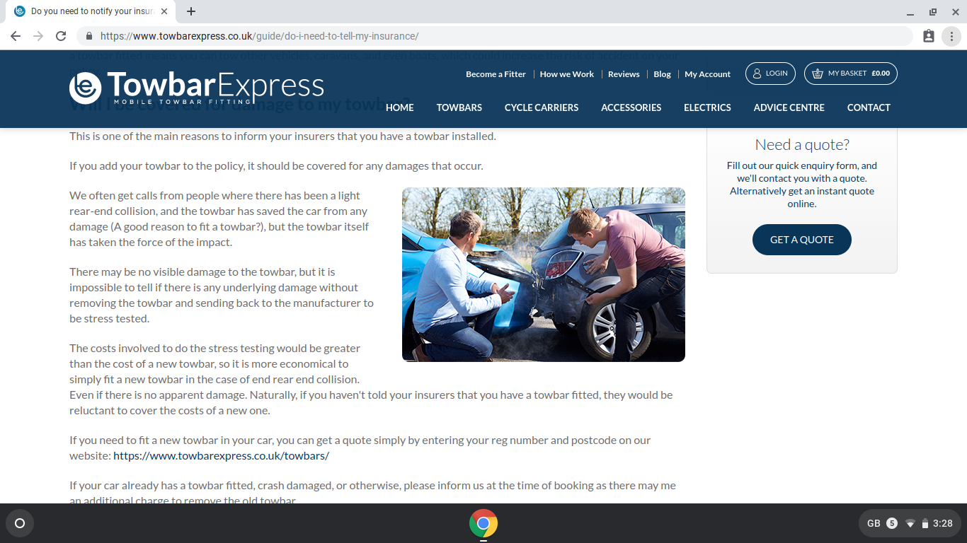

I don’t think having the tow bar on a car that isn’t type approved would be picked up on an MOT. Insurance maybe the biggest problem or if you sold the car on with the tow vat fitted.
If you have a tow bar or are fitting one you should tell your insurers,
but then telling your insurers you fitted a towbar to a car not Type Approved to tow, & even fitting to be able to fit a bike rack too means you are telling someone what you are doing, and if it invalidates your insurance other than to 3rd parties you need to be thinking about that.
It can cost lots...
Edited by Roottootemoot

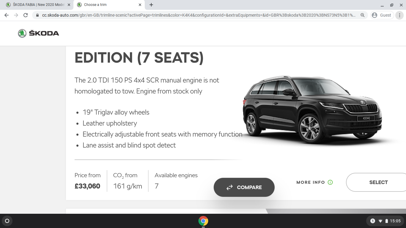

Edit,  Mid 2020.
if tempted by offers of one from stock be aware of not being able to tow with them.
Edited by Roottoot

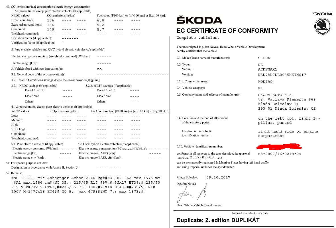

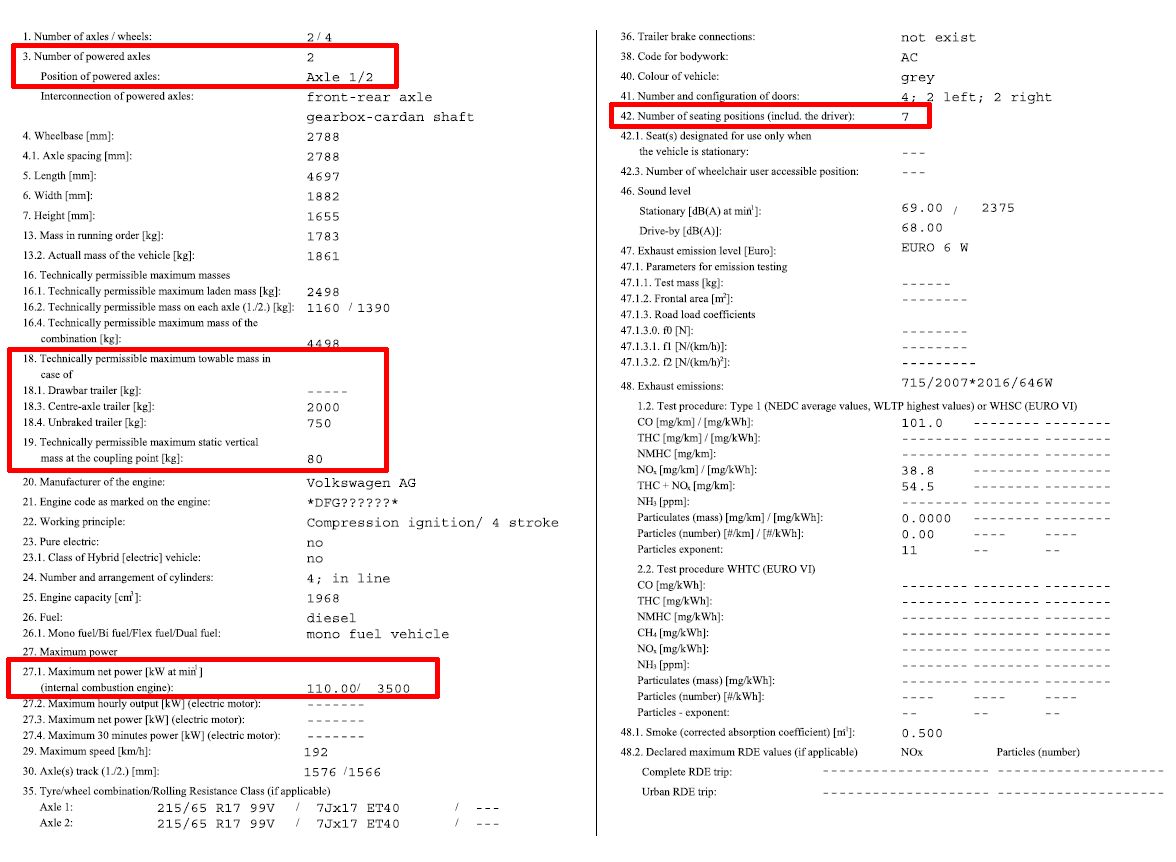

If it helps anyone, I can give a definitive answer on this - at least for our car, which is a 2017 "Edition" 4WD 7 seat DSG with 150 bhp diesel.  They ARE homologated for towing!
Attached is a scan of the EU "Certificate of Conformity" for our car.  Every type approved car will have one.  They are unique to the vehicle, and bear the VIN of the vehicle they relate to.  (I've blanked mine out on the copy below).  They contain a summary of the main data held by the type approval authorities.  It's the single most important document you can have for any EU-approved car.  The manufacturer is obliged to deliver one, original, paper CoC to the first owner of the car, free of charge.  He can, however, make a "reasonable charge" for a duplicate if the original is lost.  You can see this one is a duplicate.
On side 2, you can see various technical data for the vehicle.  You can see that it has 2 driven axles (so it's a 4x4), it's the 150 bhp engine (the 110 figure on the CoC is in kilowatts) and it's a 7 seater.  What you can't see, is that it's an automatic (although that will be concealed in the "variant" and "Version" codes on Side 1, if anyone can get a break-down of those).  However, as you can clearly see, it IS homologated for towing - up to 2 tonnes with brakes and up to 750kg without brakes.  Anything else anyone tells you to the contrary, is "bull"!
(As an aside, I believe it's the 150 bhp diesel 4x4 DSG 5 seat version that can't tow)!  No idea why that is, but we specifically bought the 7 seater, not because we needed 7 seats, but because we wanted to tow.
If any of you wants the definitive answer for your car, check the CoC.
.  1293917944_CoCside2.thumb.jpg.1118c1a0faaec6e93ea87d0b48dfa211.jpg2088316966_CoCside1.thumb.jpg.e33f036bfef31d219adfed1ee6d2e3e5.jpg
Not sure when anyone said the 150PS AWD DSG 7 seater couldn't tow, since the title is about the manual version and not the DSG.
D'oh!  Quite right, apologies!  That's what you get for posting at stupid o'clock in the morning!
Oh well, if it's of any interest to anyway more generally, the CoC for the car will give the definitive answer as to whether it can tow or not.
There is an elephant in the room.
That is where Skoda have the vehicles with the weights that the vehicle can tow, they do the CoC.
Yet the vehicle has not the factory preparation for towing and Skoda Dealers say you can not have a towbar fitted because you need the extra under bonnet hardware.
They say if you tow you can invalidate the Manufacturers Warranty.
