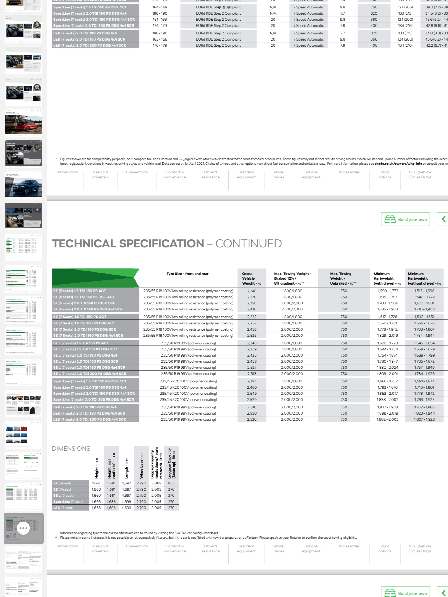

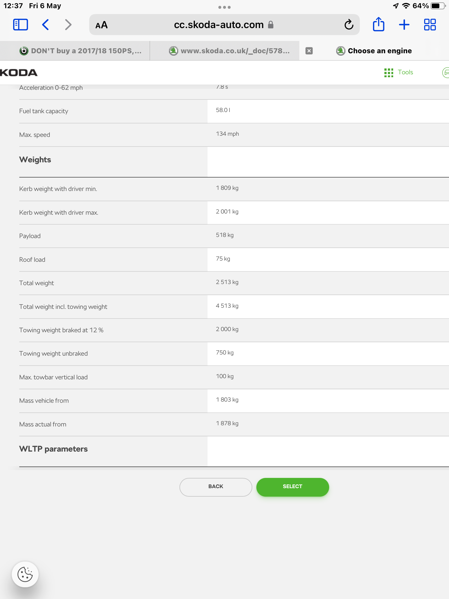

Quick update as Skoda are at it again with homologation.
I was looking to swap my 2019 Kodiaq for a 2022 one the dealer had in stock with a 200 PS TDI engine.  Luckily I checked - the current models with the 200 TDI engine are not homologated for unbraked towing.  The 150 TDI engine is, as is the TSI engine.  Just not the top diesel engine.  It is homologated for braked towing, to the same weight as the other engines.
Very odd. Check page 30 of the brochure on Skoda website for details...
https://www.skoda.co.uk/_doc/5782ef00-768c-43df-8faf-51cba9730287
Gosh! I've never seen that before!  The things (from a homologation point of view) that limit towing capacity, are usually either brakes or hill start capability.  Clearly it is capable of doing a hill start with 2 tonnes on the back, so it's unlikely to be that.  At the same time, I'm struggling to believe that the 200 horse one would have less capable brakes than the 150!  Looking at the two asterisks, I see it has a note about towbar prep.  This suggests (to me at least!) that this is stuff-all to do with homologation, and that they're just hiding behind "homologation" as a reason.  I could believe that the 200 horse one might need cooling system mods for towing, but that's not a homologation issue.  Homologation is only about safety and environmental performance - both of which would be excellent, once your engine has blown up!  But then again, if it's a cooling problem, how could it be OK to tow 2 tonnes?!  Doesn't make sense at all...  very strange....
The Skoda configurator shows unbraked trailer towing weight for 200 hp diesel, so as my comment could be a mistake in brochure. Brochure has recently been updated and previous version showed correct towing weight also.
