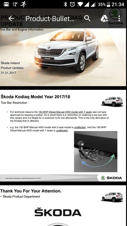

How strange.
I was about to suggest it must be in relation to the 7 seats but then I see the 190ps 7 seat version is unaffected.
Could it be down to weight? And the lower powered 150ps?
It also says the 150ps, 4WD, man with 5 seats is unaffected.
So - its that last row of seats that seem to be the culprit. That makes me think it is not necessarily a total weight issue as the 7 seater with DSG is OK - and that's heavier (I would think?).
Therefore, I'd be thinking that the problem is how the weight might be distributed with 7 seats - especially if occupied. Perhaps this is a stability/weight distribution issue with Kodiaq configuration in the bulletin?

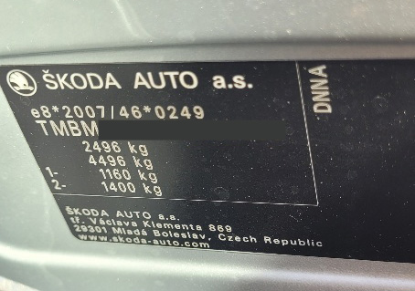

Its nothing to do with weight etc...unless they are saying that the manual gearbox and clutch are not "strong" enough for 7 people plus the max weight of the trailer.....  so its not homologated for towing as yet.... so fitting one is illegal.
Bet in a few months it will be approved with maybe a slightly less max towing limit... .. but existing cars will still be unable to fit an aftermarket one as per the plate on the car.

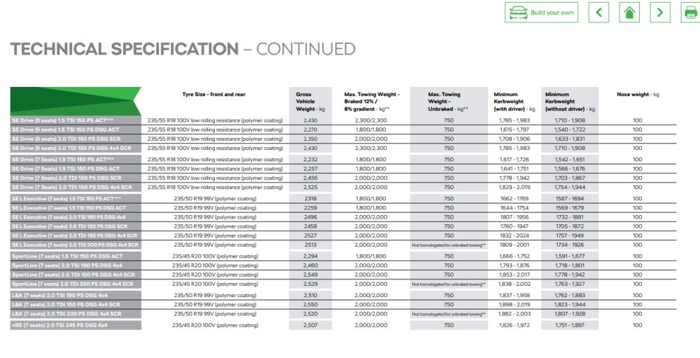

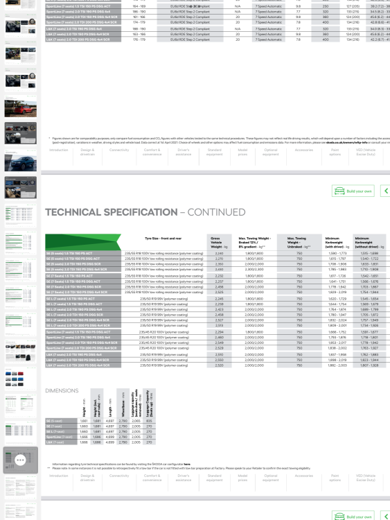

The spec sheets for the 150 diesel 4x4 manual show a dash for the 7 seat variation. A bit of a home goal for Skoda on what would have been a popular tow car.
