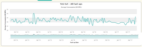

As promised - a further update.
I'm now almost 4000 miles post "performance" remap and no issues have (yet) become apparent. The DPF continues to regenerate every 150-300 miles, as opposed to the 80-100 miles between regenerations noted following the EA189 emissions update.
The average MPG in the 4000 miles since the Shark remap (currently) stands at 41.95 MPG. This compares with 38.8 MPG in the approximately 4000 miles post EA189 emissions update.
By way of a control I've looked at the 4000 miles immediately preceding the EA189 emissions update (43.5 MPG) and 4000 miles from the corresponding months, the previous year (41.6 MPG).
On this basis my reading is the current MPG is reasonably in-line with the pre EA189 emissions update average (41.95 MPG vs 42.52MPG), but 8.1% (3.15 MPG) better than that seen in the 4000 miles post EA189 emissions update.
I'd wondered if the MPG drop (seen over the 4000 miles post EA189 emissions update) was accounted for by the increased fuel needed to support the higher frequency of DPF regeneration?
Ash levels have hardly budged and (according to the VAG DPF app) suggest my DPF is currently 29% clogged with ash (@ 53000 miles). I'm unsure if Ash levels will continue to rise in a linear manner, but take this current value to indicate my DPF should last well beyond at least 140K miles.
I remain happy with the remap and have accepted both the increased insurance costs (and probable loss of any subsequent VAG goodwill outside warranty), as a direct consequence of both my decision to both allow the EA189 emission update to be applied, and my subsequent decision to have the car remapped.
I remain peturbed to be placed in this position by VAG's actions, but am nonetheless satisfied with both my subsequent actions, and the outcome.
