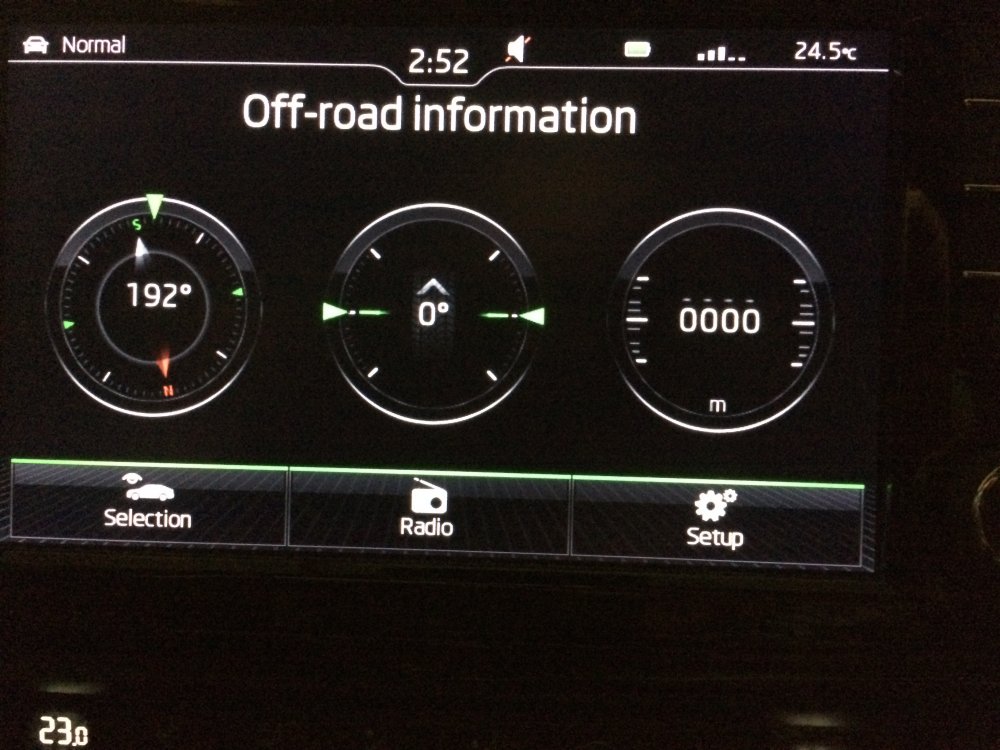

So I enabled this today.....
Enabled using OBD11, using VCDS instructions I found elsewhere - can't remember exactly where that was sorry, so I can't credit the original post, but if I find it again, I'll post the link for courtesy.

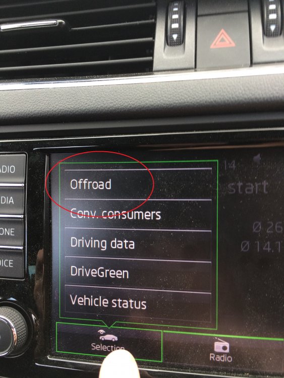

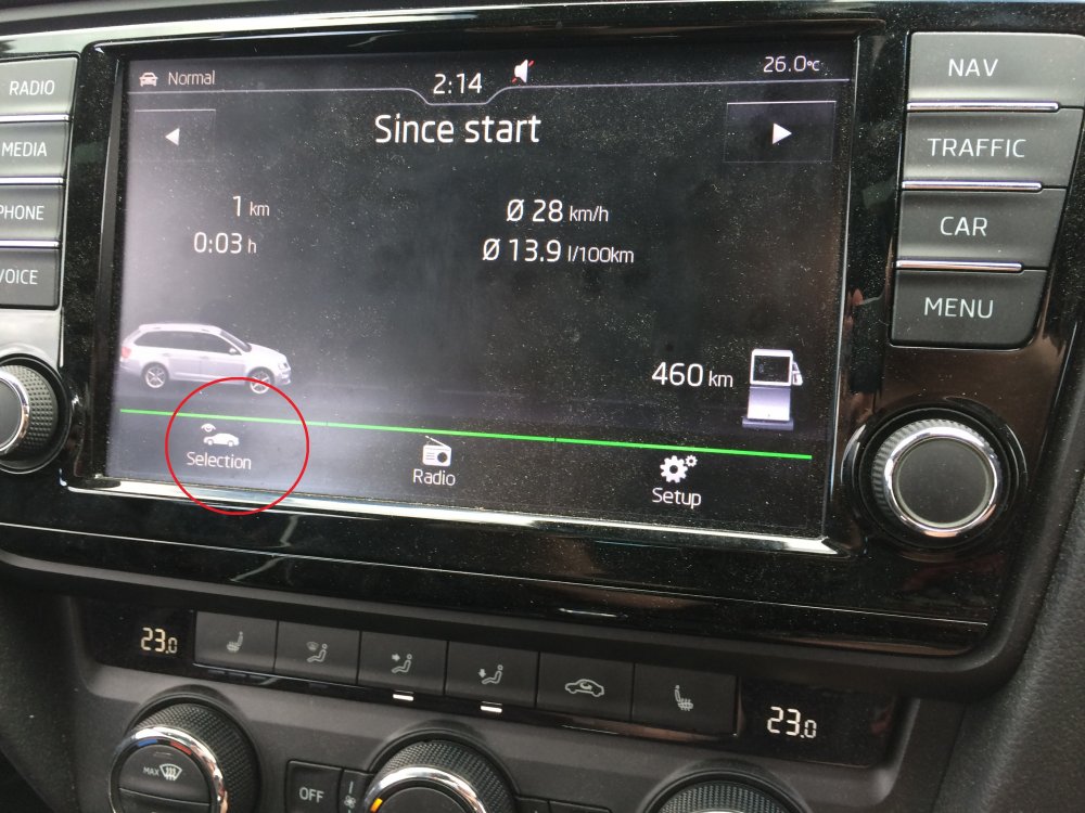

At first, I didn't think it had worked, as I couldn't see anything obvious on-screen or where to view it, but it's actually hidden in the "Car" button, under settings.

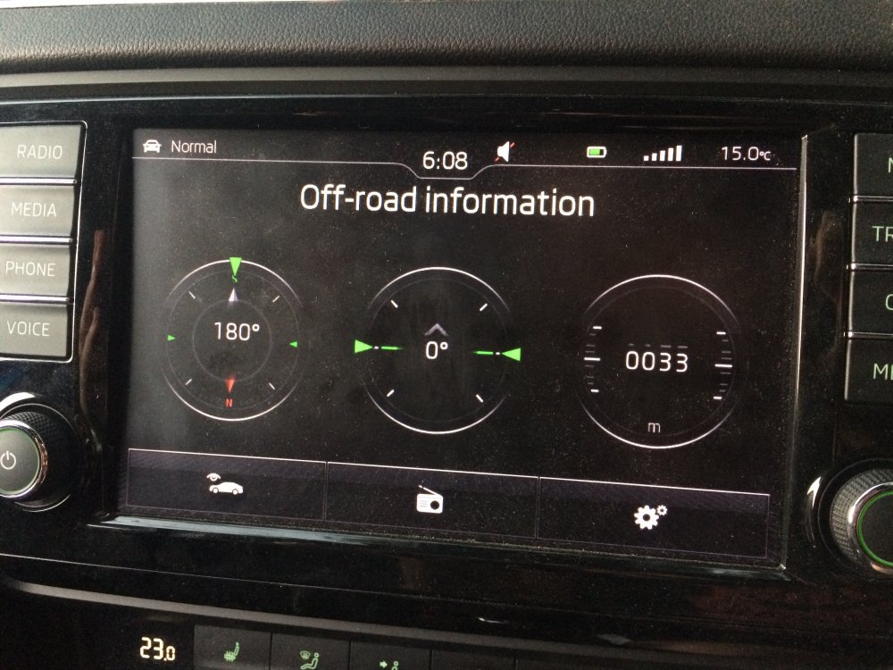

Just done this.
I'll probably never use it, but hey, it's cool :biggrin:
Also did this, but haven't driven far enough to make a definitive judgment yet.

Tried this just there with VCDS, managed to only get three compasses! Any ideas? First adaption change does that action. Can’t see a change for the other two.
There's only 3 dials that show up - will originally show all compasses, but swipe each dial up or down to select the other dials
Ah that's where I'm going wrong, I'll must swipe the dials. Will do that later. Cheers.
