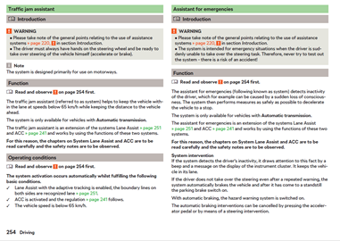

Hi Folks. There seems to be a bit of confusion of what TJA actually is and how it's supposed to be used. Perhaps I can help to clarify that here? You'll discover it's actually no great shakes.
Let me start by re-emphasing that TJA is not a 'factory fitted option' that you choose to have nor does it need to be 'enabled'. It's part and parcel of the ACC software that integrates with the Lane Assist regardless of whether you have it set to the vanilla Lane Assist or Adaptive Lane Assist. So long as your car has the minimum requirements ~ DSG + ACC + Lane Assist ~ then you have TJA.***
This is how ACC works if either: 1. You don't have Lane Assist, 2. Lane Assist is not enabled, or 3. Lane Assist is enabled but cannot detect any lane markings (amber).
ACC is active and brakes you to a complete stop behind a vehicle that it had previously detected moving but is now stationary.
If the vehicle in front moves off within a couple of seconds of stopping then ACC will automatically accelerate your car once your pre-set ACC distance (gap) to the car in front has opened up.
If you're stopped for more than a couple of seconds the ACC will go into a standby mode and you will see a message on the MFD that ACC is ready to resume.
When the vehicle in front moves off you need to pull the ACC stalk back (it's marked 'Resume') or give the throttle a quick dab. This will restart the engine (if applicable), your car will accelerate and ACC will resume matching the speed and gap to the car in front.
This is not TJA.
Traffic Jam Assist is fundamentally the same as above but requires Lane Assist active with road markings detected (green). The only difference is you now control it with the steering wheel.
When ACC brings your car to a complete stop behind a now-stationary vehicle you need to TAKE YOUR HANDS OFF THE STEERING WHEEL to activate TJA.
When the vehicle in front moves off you only need to PUT YOUR HANDS BACK ON THE STEERING WHEEL and your car will move forward and resume ACC.
If you keep your hands on the steering wheel for more than a couple of seconds after ACC has brought your car to a complete stop then TJA is no longer active and ACC goes into standby mode. You will need to pull back on the ACC stalk or dab the throttle to resume.
Unfortunately the pi$$-poor owner's manual is quite good at saying what is needed for TJA to activate but not how you're actually supposed to use it. There is a short animated video of how it's supposed to be used here.

TJA is not a function you can directly turn on/off.
if u have certain features in ur car, and they're turned on, then the TJA will kick in.
with Lane Assist, you need the version with "Adaptive Lane Guidance", and ensure both are turned on via the Car Infotainement Settings under Driver Assistance.
see screenshot.
