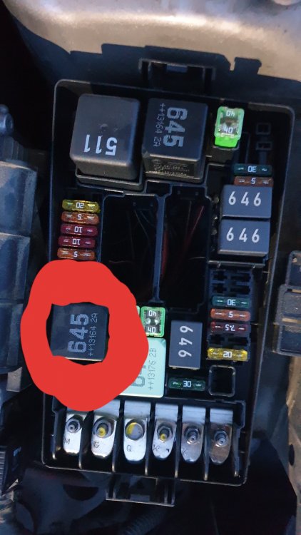

Well, it was my turn to hit the Faulty Gearbox Error&CO. It had nothing to do, at least in my case, with the DSG. The problem was the motor relay. Could I ever imagine that? No, noo way, regarding I was at the official dealer and had it tested, and they told me if it.s not the cables then is the motor computer, for sure. So, if you have the same problem, invest about 8€ and buy that ***** - 645(4H0951253A).

Happened to my dads 2013 Octavia 1.6 tdi dsg. Can confirm, changing the 645 relay solved the problem.
