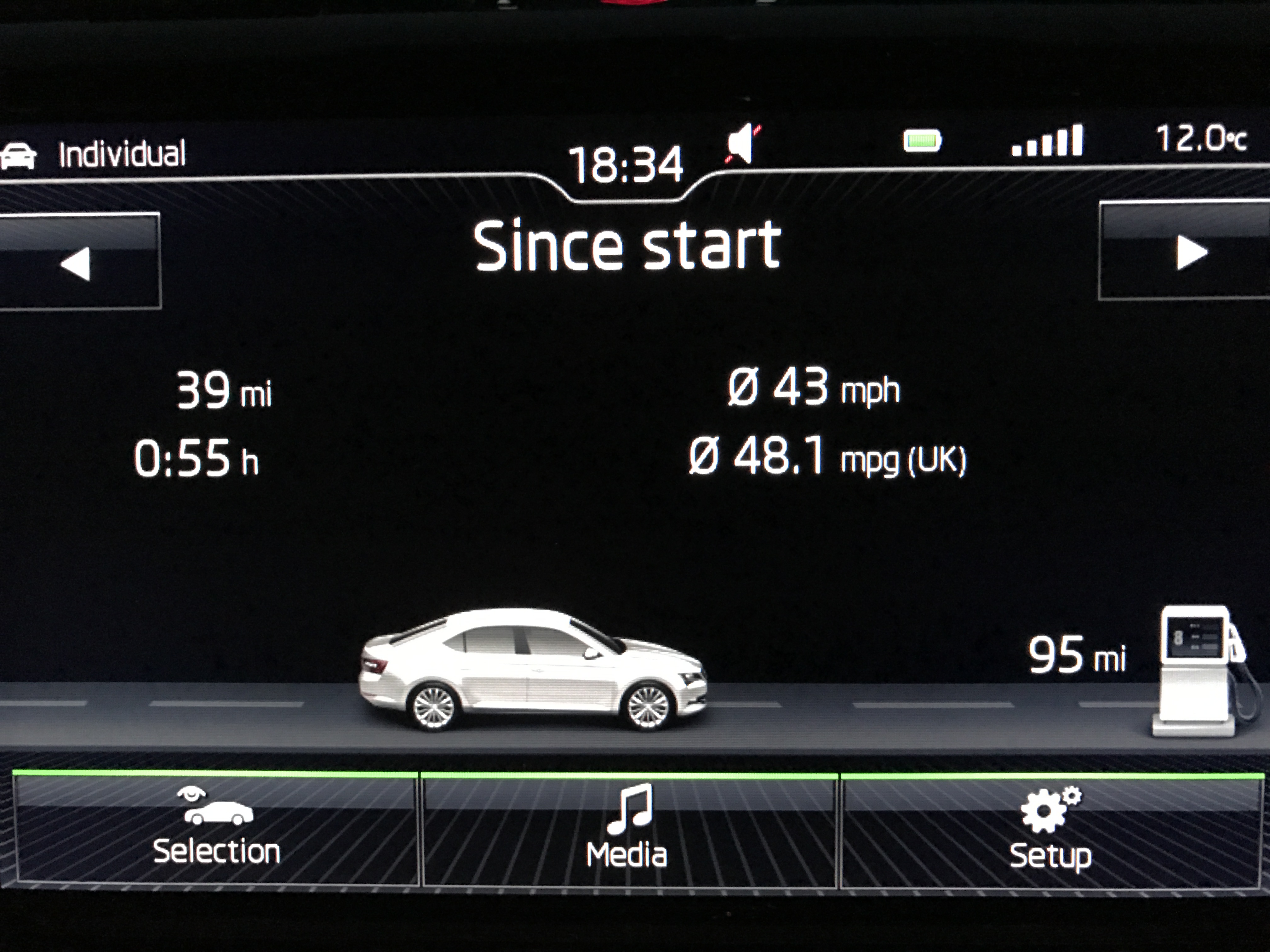

Mostly at 70mph (about 1,900rpm in 6th) I'll see 42 to 45mpg on the motorway, and about 38 to 40mpg at 80mph (about 2,100rpm in 6th). I don't hang about or gently accelerate though! The diesels will no doubt do better but week to week in the real world you're only talking a fiver or less really for most people. I worked out at one point that switching from a 2.0 TDI I'm now paying £3 a week more (using V-Power unleaded) than I did for a smaller diesel on the cheapest fuel I could find. The 150ps 1.4 TSI is no doubt even cheaper again. It will really come down to what you prefer. I'd strongly suggest you try both if you can, even if it's as a passenger, to get a feel for how they drive and respond. Most dealers won't have petrol Superbs but you'll find quite a few with Octavia VRS with the same engine.

I'm very interested in a 220 TSI now I've seen your 48.1mpg, I could live with that, especially considering my current diesel has averaged 44mpg since I got it.
