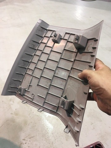

I think Navcomic wants the D pillar trim - the pics show the C pillar trim. I went through various extremely useful threads on here when installing a front and rear dashcam - I haven't had time to put the pictures I took into a guide yet (I didn't need to remove the C pillar when feeding the cable aft).
The D pillar trim I pulled from the rear vertical edge towards the front. The pictures show the attaching metal clips and three plastic 'guide' clips along the bottom edge. This trim piece actually came off pretty easily - certainly easier than the tailgate trim...
Hope these pictures help!
