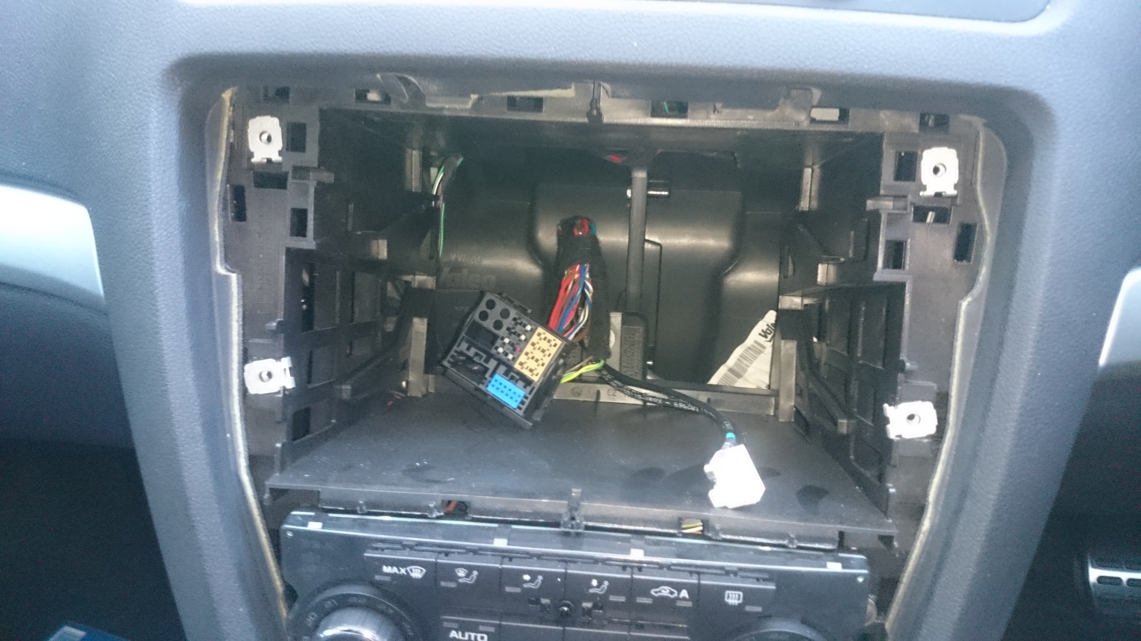

Quadlock intermediate - whilst this will work the additional cabling will make it a PITA to get behind a bolero - with a Columbus forget it it'll never go without cutting part of the support unit out.
the best option to fit an amp will be a line out converter - which you install spliced into the rear speaker cables in the original quadlock at the rear of head unit (ensure you get one with gain control) Maplin does them for £20

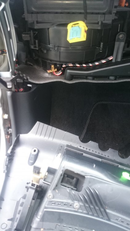

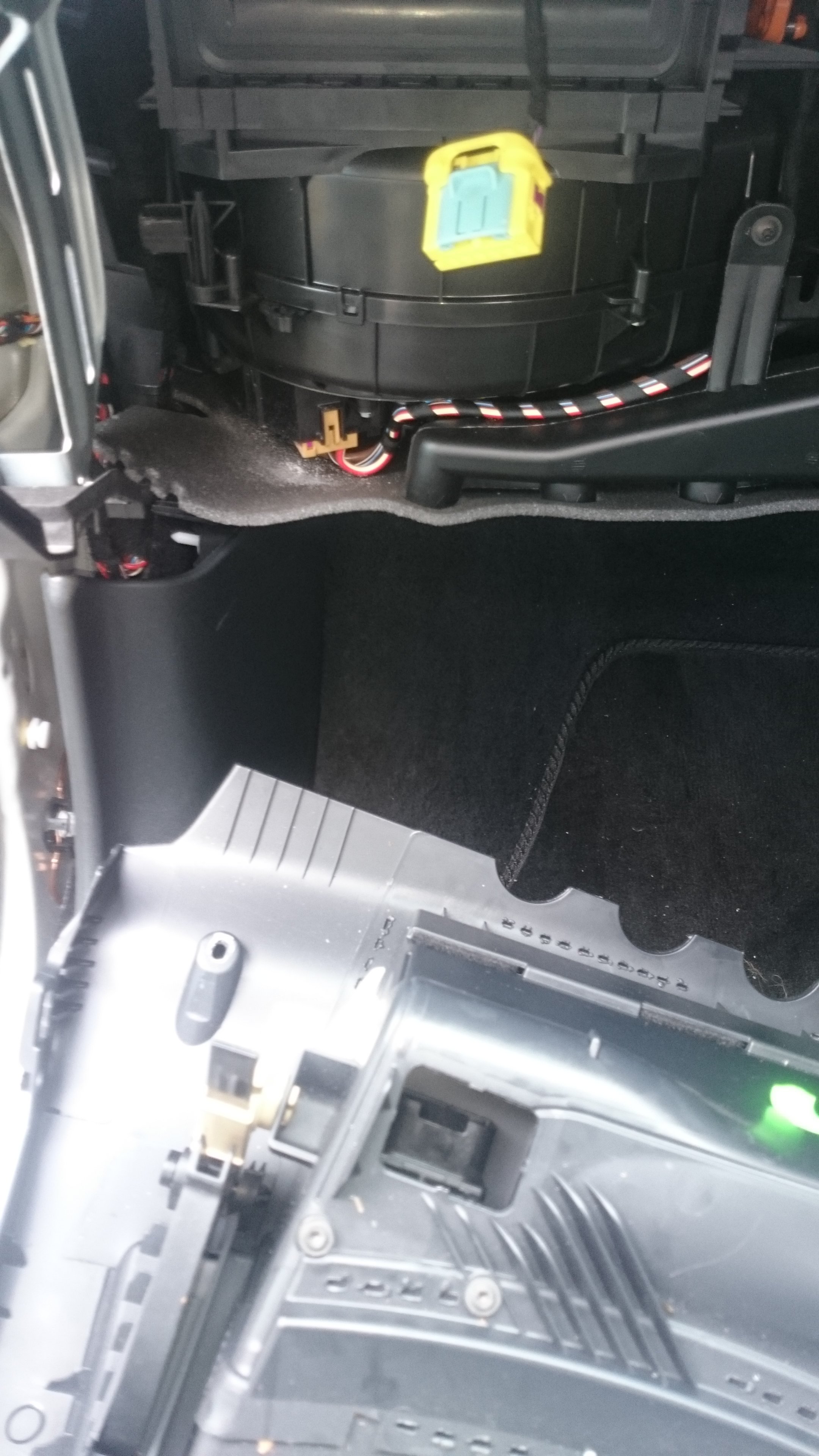

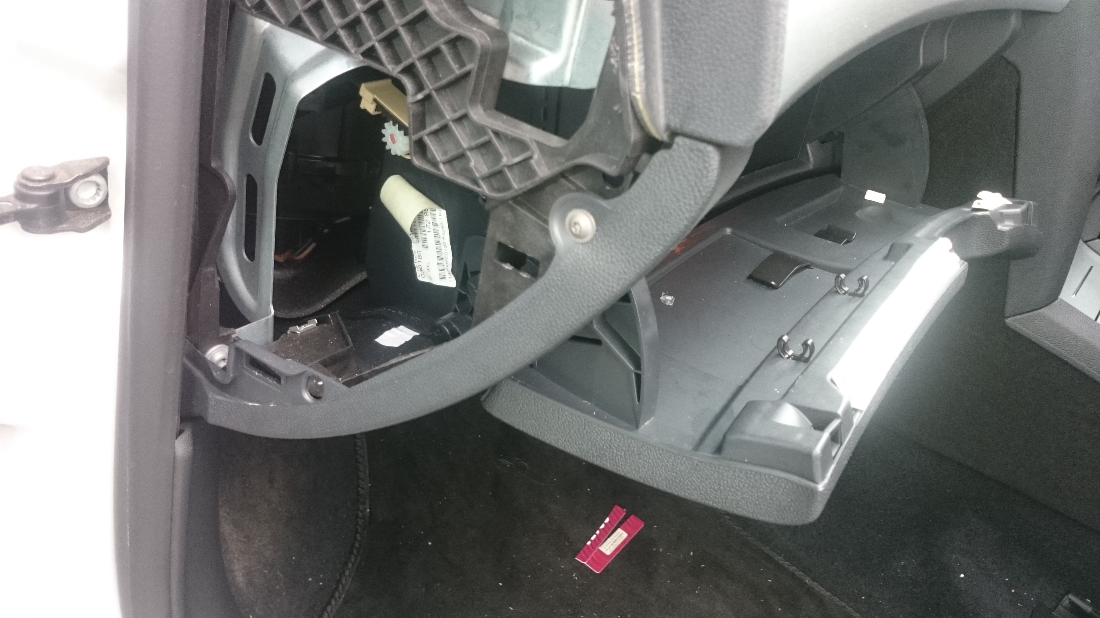

obviously you'll need power so take your battery out and glove box, remove internal channel panels (b pillar etc)
piggy back from the cigarette lighter fuse for your remote and channel down the panels
