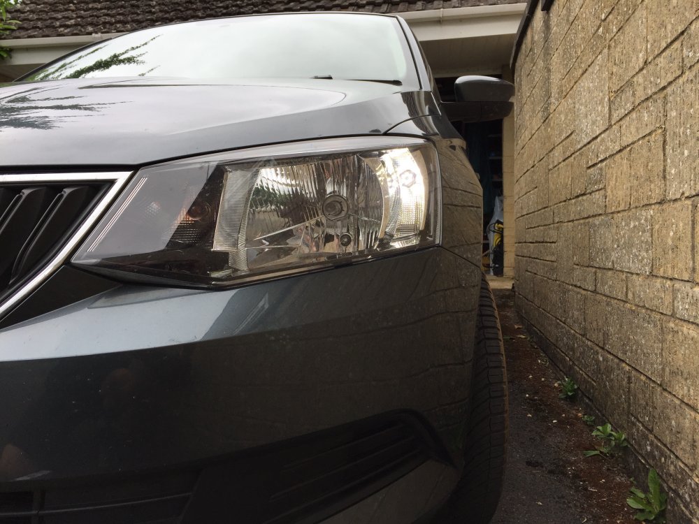

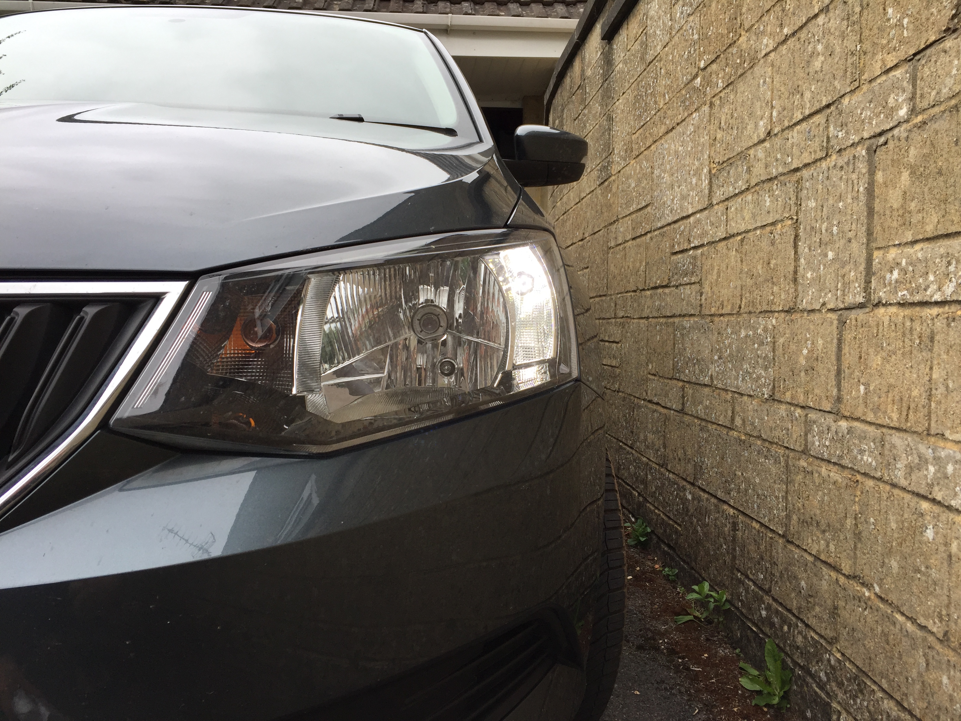

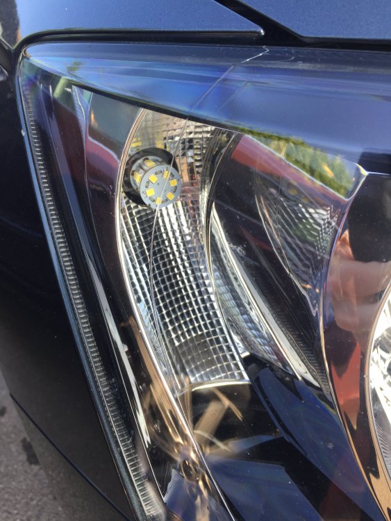

Hi All, just to share a simple and very cheap upgrade to LED running lights. 2016 Fabia SE comes with horrible / cheap filament bulbs for Daylight Running. I found these LED bulbs recommended by others on Amazon, just a few pounds. Anyway, after using them for 2 months, no problems (did not fall apart like some). Running lights now brighter and nice crisp white light (instead of yellow'sih before). I'm sure other brands are fine to, these are just the ones I have experience of.
Just a 5 minute job to fit them, no dashboard error messages.
By the way, don't try the same for your turn indicators as that will cause you problems (rapid flash and error messages).
You have a night time picture or dusk
Day time photos
that looks better

If you did not spot it in the original photos, the LED bulbs I used were ZISTE 2835 (P21W replacements). Seem to work fine, not error or warnings. Go for the brightest 6000K.
